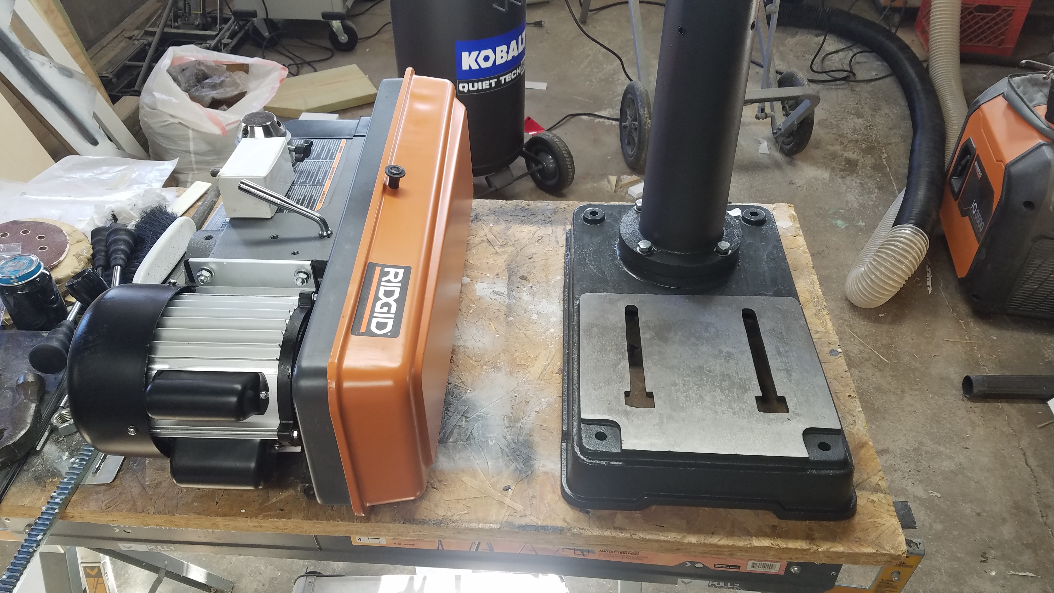

And an update, finally got to open my Christmas present and start working on assembly. They all chipped in and got me a floor standing drill press i've only been asking for forever. My awesome wife bought me my super table saw nearly 20 years ago, and i've wanted this practically as long, just never justified. Now she's getting serious about little projects for her, so lucky me! I've already paused assembly to get a mobile base before I proceed (and it's too darn cold in the garage today!).
Ridgid 15" drill press

I'm soldering piezo's today, but until I get some progress...my drill press is finally assembled and on the stand.
Fired it up this morning only to find out the motor housing was dented in shipping and rubs the fan.
Drill press in the mobile base
I waited a week for a mobile base and now I may end up taking the drill back for a replacement. Oh the setbacks!
