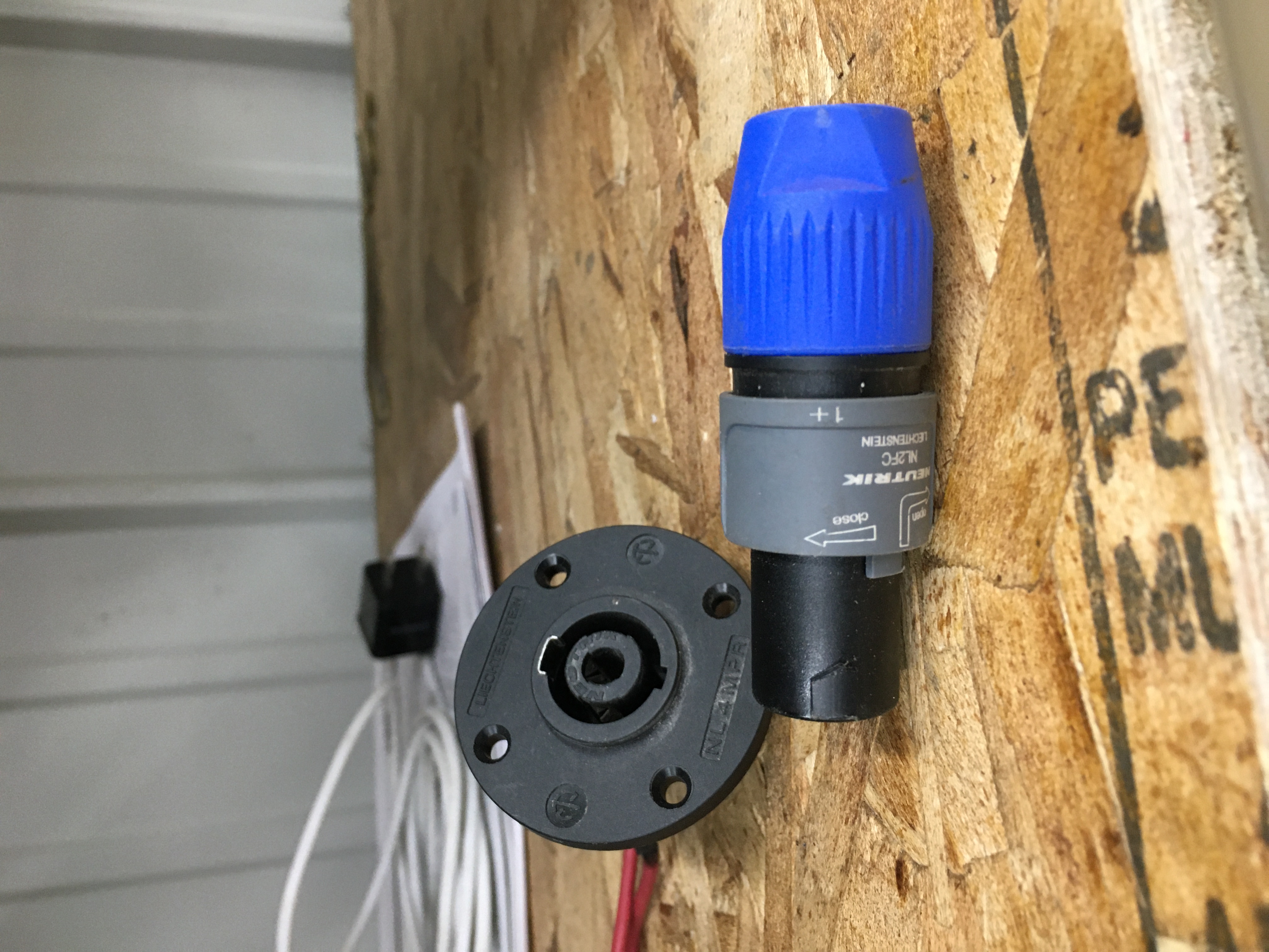

Did you get authentic Neutrik connectors? Is the dish connector real Neutrik too? There's a lot of copy-cat crap out there.RYNO20 wrote: ↑Wed Feb 24, 2021 1:30 pmThey lock but not tightly like the straight onesBill Fitzmaurice wrote: ↑Tue Feb 23, 2021 10:07 pm I haven't used those, but seeing the latch release I would think they must lock.

Says Neutrik and Liechtenstein .Bruce Weldy wrote: ↑Wed Feb 24, 2021 2:58 pmDid you get authentic Neutrik connectors? Is the dish connector real Neutrik too? There's a lot of copy-cat crap out there.RYNO20 wrote: ↑Wed Feb 24, 2021 1:30 pmThey lock but not tightly like the straight onesBill Fitzmaurice wrote: ↑Tue Feb 23, 2021 10:07 pm I haven't used those, but seeing the latch release I would think they must lock.
The tab on the straight ones is .200 wide and only has .003 clearance, the tab
9 that locates in lock) on 90 degree ones is .188 thick and has .015 clearance, wiggle room , wow.
If you see how they are built the long .090 dia. Pins make the contact on the male part is not much surface area, the spiral raised section on the receiver is not much area to contact, add up the tab lock being smaller and etc equals bad design. IMHO.

Interesting.....I've never used any of those....don't like the price and most everything I have has and inset plate - not sure if they would even fit.
Too bad it's not a good connector. I've yet to run across a Neutrik product that wasn't top-notch.

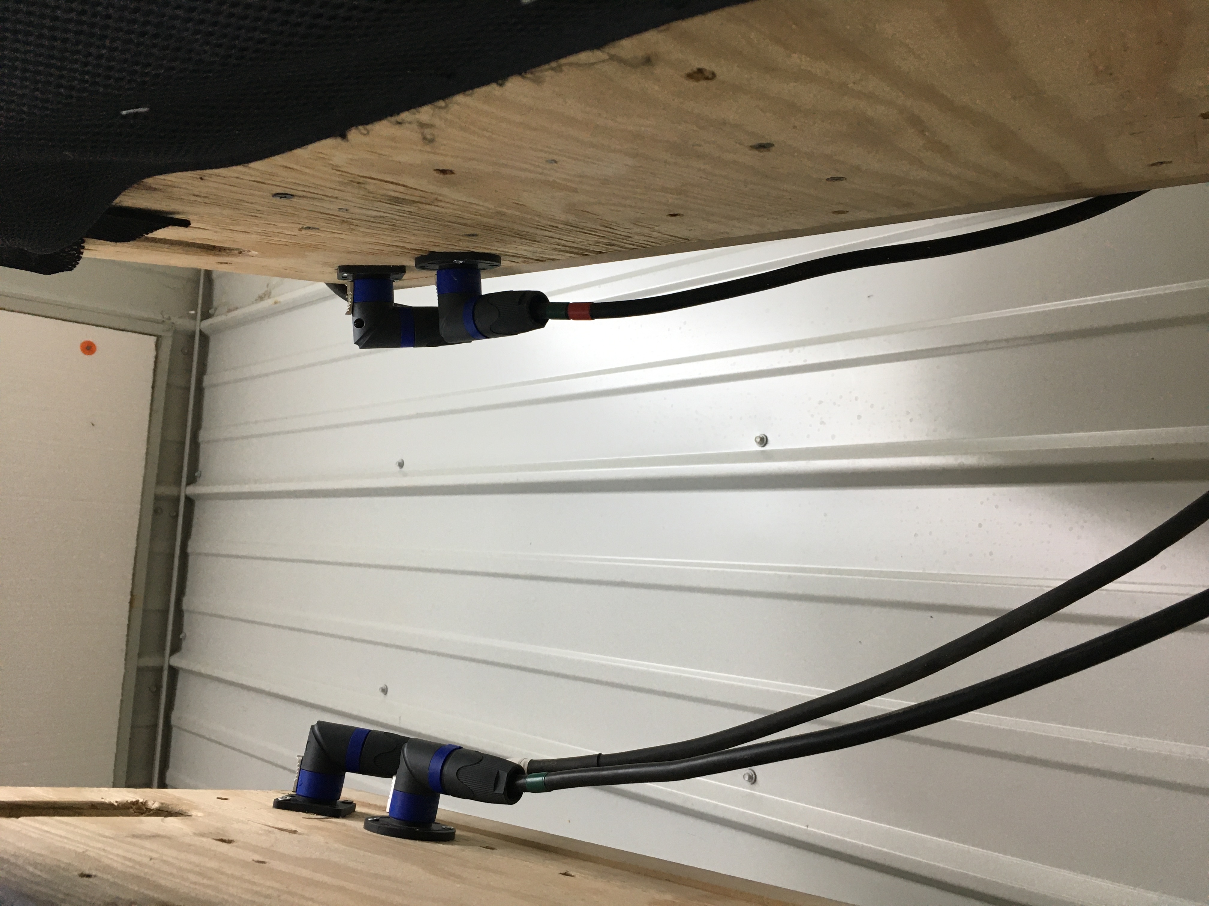

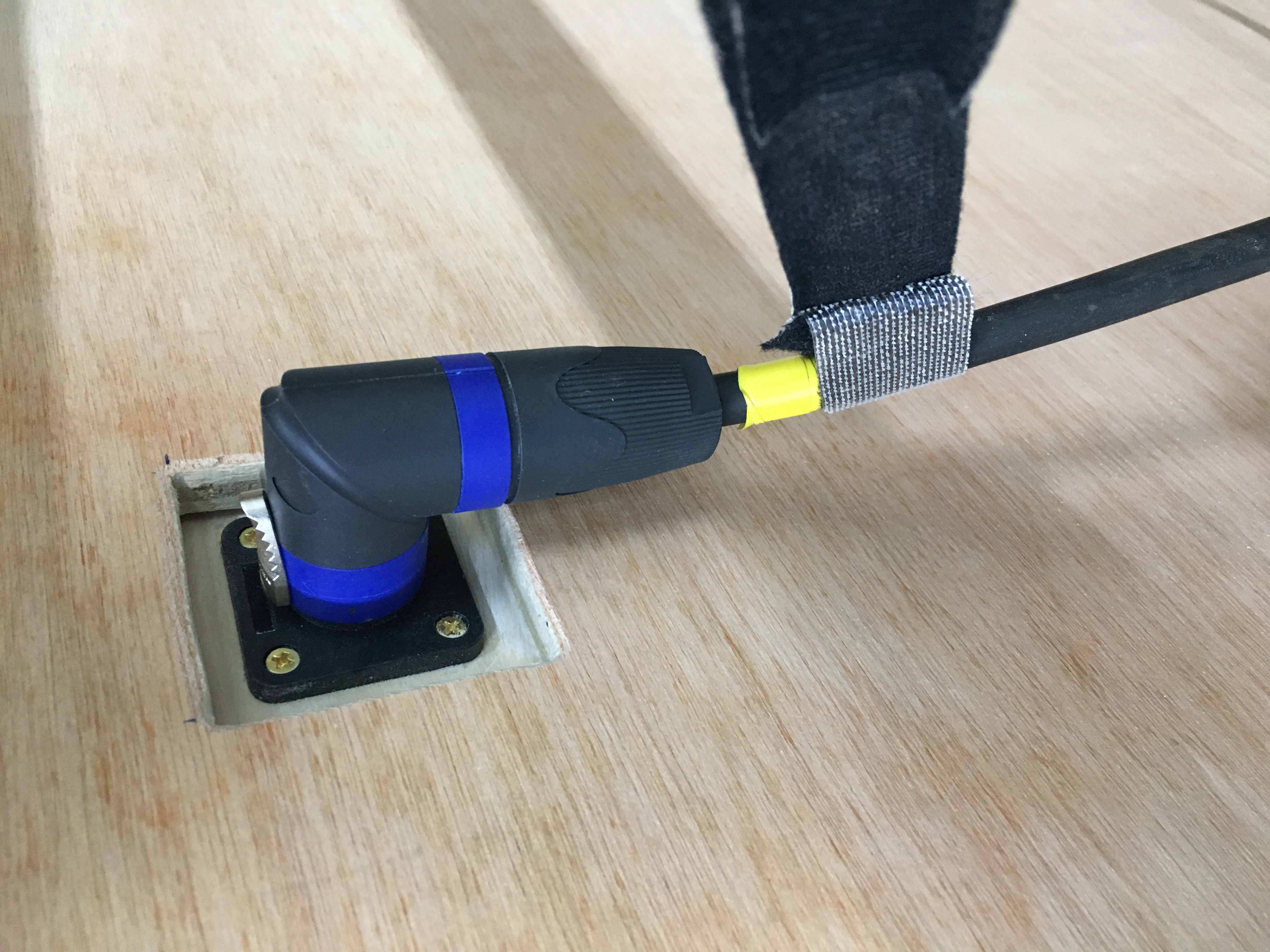

[/quote] One of mine is reset because I was possibly going to lay it on its side and V=plate 2nd one. Others are vertically challenged, one for horns one for woofer, always keep color coded and simple. Never tried pass thru and 4 wire cable, permanent fixed.
The grey colored one is all plastic and tight , the others are metal locking bar and are loose even some of the straight ones I have are loose.
I’m going deep diving on this cause I’ve had problems with connections and always thought it was the wire. Also I’m using #1 pozidriv tool not a #1 Phillips.
Hope mixing nl2fc and nl4mpr matters?

That's not a problem at all. Years ago the old style NL2 panel mounts wouldn't take an NL4, but those days are long past. NL2FC is exactly the same as the NL4 - just 2 conductor instead of 4. Nowadays, all NL2 and NL4s play together. Just not NL8 - different animal.
Probably half my cables are NL4 and half NL2FC. All panel mounts are NL4. Never a problem.

Update Neutrik connection is perfect.
This morning I took all the receivers out and was going to test the loose problem. Turns out the 3 receivers were an off brand , wow human error again. I had stripped old speaker cabs for years keeping hardware etc. but used these 3 pieces because of size and not looking any further. I’ve only bought Neutriks for years knowing the cheap ones are just that.
So now all are replaced and functioning as the great product Neutrik is.
Going thru inventory today to put on EBay .

Great news! My faith is restored....RYNO20 wrote: ↑Thu Feb 25, 2021 11:43 am Update Neutrik connection is perfect.
