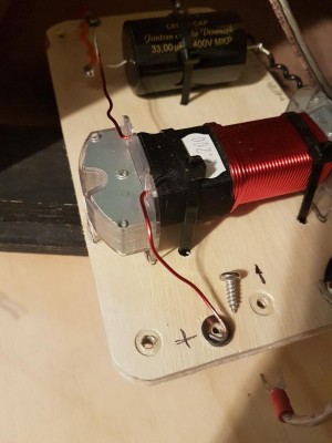

Grant Bunter wrote: Wed Jun 03, 2020 2:47 pm It just seems highly unusual that two faulty components ended up on 1 board.
I want you to try 2 things.
Disconnect the mid board from the 3 way thingy, and hook the woofer board to that lug, see if that works.
Undo the screw on the + "in" side of the woofer board and show a nice, close, in focus, pic of this end of the inductor.
Yes I got bass and woofer is moving along nice sound loud too. It works Yeehaaa! I hook it on the mid pin. Planning on redoing all 3 way thingy terminal waiting for UPS. :wink:

Yay, you found the problem. Well done, it's not easy when you are trying to work it out based on something some dude half way around the world is trying to tell you to do via the internet.
Take some more of that lacquer off that inductor lead under the screw. There's only just enough bare wire there to make contact. Sandpaper will do the job.
Reassemble everything on the woofer board, check to see if it's all still working...
