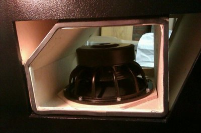

Thanks guys. I am slightly tempted to leave two cross tunnels in the cabs or make mesh covered frames to fix in them (because the paintwork couldn't be so great in those parts now. Here's a thought: paint a brighter colour in there, and put some battery powered sound responsive led lights in, mesh covered. Mega cheese.
Anyway, here's the first coat of tuff cab on one cab, got woke at 4:30 this morning and could sense i wasnt going back to sleep, so got an hour in. I can almost hear them celebration bells ringing, but nothing below 100Hz unfortunately.

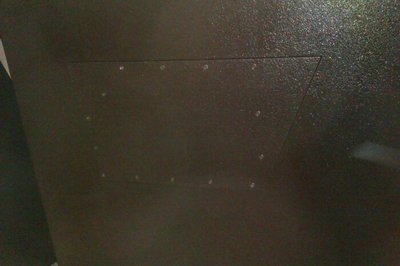

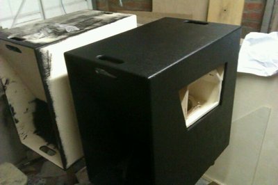

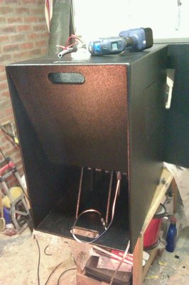

Good news. Got most of paint on both cabs, and just fitted driver to first, and covers. No leaks.
10mm Gasket strip bent round corners and stayed flat no problem.
Close up picture of speakons shows dust at back corner of mouth. I wonder how much more is going to come out.
I hope not much. I vacuumed out the driver compartment and what I could reach.
Gone boring, not chopping access hatches down. Just to add feet on side and bottom now, and paint and fit out the V plate - but at the moment it's got about an inch of bend in it across the diagonal side. May take it in the house and hide it behind the settee for a week and see if it straightens.
Went up to 35volts on sine wave. It was exciting at 70Hz-ish, lots of stuff vibrating, but I don't think its representative of real 'musical' bass, so I'm interested to see what happens when crossed over and some proper music played, etc.
Thanks for the votes of encouragement. Next project lined up already - XF212.
Got a few guys to show tomorrow, so not gonna finish the other one tonight, then they can see the internals.
