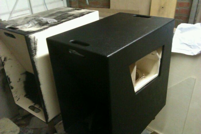

Thanks guys. I am slightly tempted to leave two cross tunnels in the cabs or make mesh covered frames to fix in them (because the paintwork couldn't be so great in those parts now. Here's a thought: paint a brighter colour in there, and put some  battery powered sound responsive led lights in, mesh covered. Mega cheese.
Anyway, here's the first coat of tuff cab on one cab, got woke at 4:30 this morning and could sense i wasnt going back to sleep, so got an hour in. I can almost hear them celebration bells ringing, but nothing below 100Hz unfortunately.

Re: 2x 19" T30's
They are coming along great Charles. If your gasket tape is not too thick then yes definitely you can run a continuous piece and overlap it, preferably by a screw hole, it will give it a little extra force to squish it. Love the idea of cross tunnels, led lights wired into the subs power source is what we do, no batteries needed, some plexy covers and your good. As some one said before its always good to finish a cab before you play it, I totally agree, because when you fire it up before its finished (painted etc) it more than likely will stay that way for a while

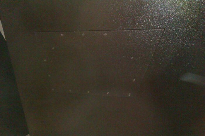

For seal testing, I would down your access panel into three pieces.  Stick a couple of mounting blocks of ply into the two end slots behind the reducer panels on each side.  Mount your main access panel and leak test, once everything is good, screw the two mini panels at either side of the main panel.  They just need to look neat as they are purely cosmetic,

Thanks for suggestions. I'll see what the leak situation is potentially like with whole access panels first. If its whistling through I'll assume it is on the blind joints too, and cut the panels down. Plan?

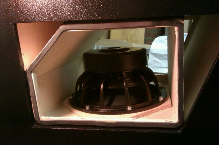

Good news.  Got most of paint on both cabs, and just fitted driver to first, and covers.  No leaks.
10mm Gasket strip bent round corners and stayed flat no problem.

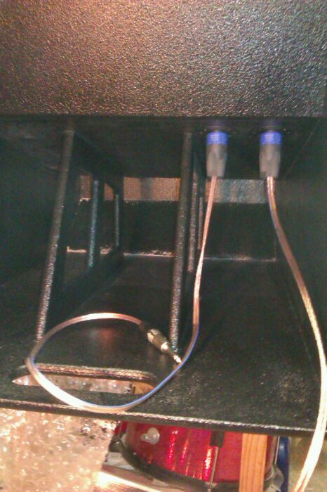

Close up picture of speakons shows dust at back corner of mouth. I wonder how much more is going to come out. I hope not much.  I vacuumed out the driver compartment and what I could reach.

Went up to 35volts on sine wave. It was exciting at 70Hz-ish, lots of stuff vibrating, but I don't think its representative of real 'musical' bass, so I'm interested to see what happens when crossed over and some proper music played, etc.

Re: 2x 19" T30's
It's possible you may have a leak. I would have thought 35V @70Hz on a Lab12 in your garage would be unbearable.Charles Jenkinson wrote:Went up to 35volts on sine wave. It was exciting at 70Hz-ish, lots of stuff vibrating, but I don't think its representative of real 'musical' bass,
