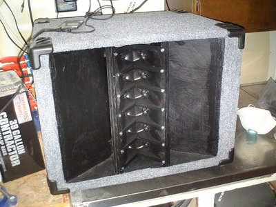

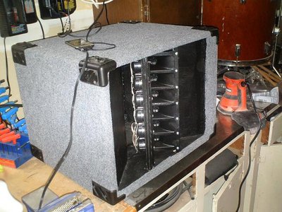

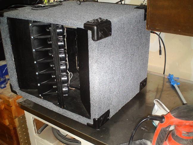

Here are some better pictures, though the flash does reveal some flaws. :oops:
Thankfully, carpeting hides a multitude of sins.
