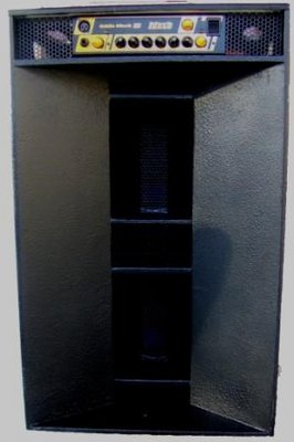

Just finished for a client. I think the Jack is the best looking cab in the lineup.

Pretty Pretty and Markbass amps one of my every year's xmass gifts..... Great job!
which drivers??

2510's.

LelandCrooks wrote:2510's.
That will make one happy camper :mrgreen:

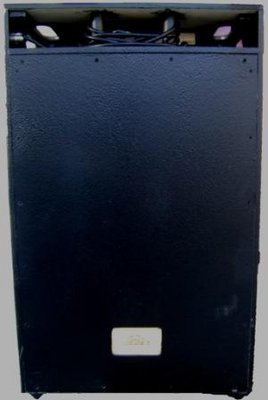

Nice job on the cabs Leland. Using the handle cut outs to aid venting is a novel idea.

Actually the handle cutouts go nowhere. The top is false and removable. They're just in the sides above the actual top of the cab, and in the false top. Credit where due, it was the client's idea.
