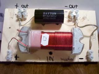

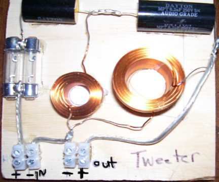

can someone please tell me if theses are wired correctly

are these wired right they are for a omni 15 tallboy
#2 Post by LelandCrooks »
Looks correct. :)
#3 Post by DJPhatman »
You should probably change the axis of one of the inductors that are close together. Prevents interaction between them.
Stand the little one's on their ends upright.

#4 Post by Bill Fitzmaurice »
DJPhatman wrote:You should probably change the axis of one of the inductors that are close together. Prevents interaction between them..
That's true if you have the different passband sections either on the same board or otherwise close together, but if you separate each section by six inches or more it's not a concern.

#5 Post by rockerd9 »
thank you for the help
now Ill turn on the power switch tonight
