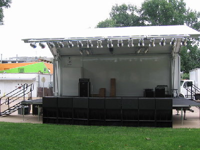

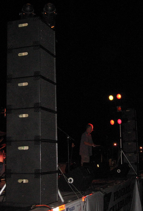

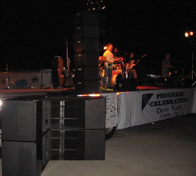

Here are some pics of last Sat. nite. Had 3 bands in six hours with out a hitch. All bands were very happy with the sound. The client was very pleased saying " It's loud and sounds clear but we can still talk." Just what you wanna hear. :D I was running about a 100db at FOH 100ft. from stage. I've done 14 of these outdoor shows this summer with 3 to go and this system works great. Everyone comments on the clarity and when they find out I built it they are really suprised. The last 4 shows I've been running the top 2 box on each side with a aux feed mix for vocals only with a seperate EQ. It really helps bring out the vocals in the mix. The first pic is 8 across the front of stage from a different show which I've done with six also. I can't tell the differance between 6 and 8. I think the spread is to far for 8. Cancellation? :conf:

Paul Norman wrote: I think the spread is to far for 8. Cancellation?
With the subs all mouth to mouth they essentially operate as one, so cancellation isn't a problem, though dispersion may, or may not, be. That wide a source will give narrowed dispersion above the 1 wavelength dimension, but in outdoor venues especially that may not necessarily be a bad thing.

The subs are 27" with 3015LF's. The mains are OT112's with 2512's, 10 with 6 piezo's, 2 with 12 melded with pole pockets. The grills are stretched metal with 1/4" A/C foam. Everything is right from the plans-That's way they work so good! 8)

Paul, how did you secure ther Otops? Are they simply stacked?

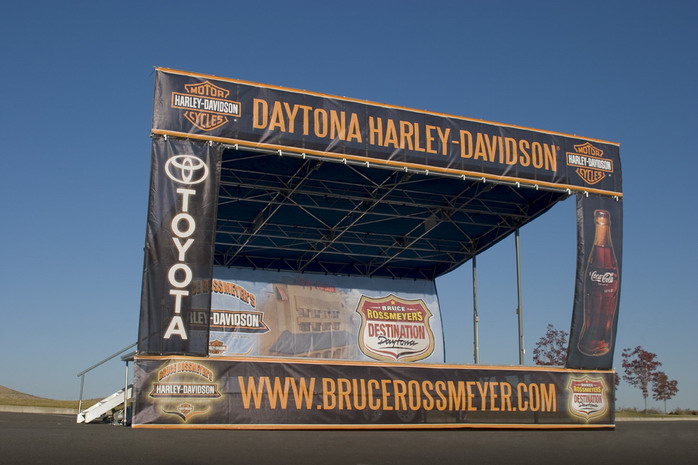

James R wrote:Paul,
Do you own that stage?
No, it belongs to the city. I've done about 10 shows on it. This is the stage I'm considering to
buy.
djohnson573 wrote:Paul, how did you secure ther Otops? Are they simply stacked?
They have locking corners and are just stacked. Sometimes I will stap them all together.
