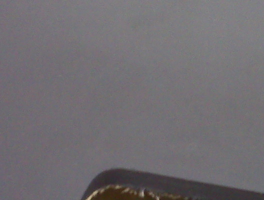

4 cabs, barely a gallon of duratex. 2 t48's, two DR250's, two of the biggest coverage hogs we build. The pics are of the first coat. Thin, thin, thin. Just make it black. Kinda like the Stones. You can see the grain through the finish it's so thin. I used barely a pint. Yes, I measured. Dries in about 10 minutes. The roller you see is a 4" foam cheapie. Don't roll too fast or you'll leave air bubbles.
I then rolled on another moderate coat, then a heavy one which I textured. It really doesn't need to be 1/4" thick to give you a good strong finish.
