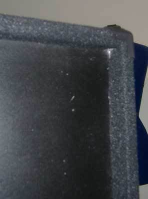

greg wrote:your omni 10.5's appear to be carpeted and your o15tb looks painted. I'm almost to the finishing stage of my O10 and am agonizing over which finish to use! Which do you prefer?
The O10.5's are carpeted as per the plans. The O15 is also carpeted, with the front panel painted.
I added a rim to the O15 with the intention of putting a grill on the front to hide all the horns, so that part I just painted black thinking I'd add a grill when I could afford one. There are details (and some slightly better pics) in my build diary http://finnbass.com/showthread.php?t=1906
Here's a close up...
However that was about one year ago and I've gigged it constantly but just not gotten around to adding on the grill. I'm planning on doing it soon, and probably popping some rear castors on to, but don't know whether or not I'll ever get around to it.
I like the carpet finish as it hides all my dodgy woodwork! I'm also one of the minority that finds the carpeting process easy and enjoyable.
