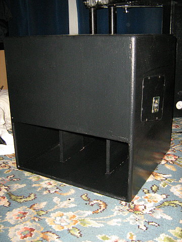

Today, I finally finished the T18 I've been working on since December:
I've yet to really test it yet, but going from how it sounds just in the middle of the room it's got all of the Bass anyone would ever need for a HT! Plus it's quite a bit lighter and easier to handle compared to the AutoTuba I made! It might just be a placebo, but it appears to sound a little less 'honky' compared to the AT as well. Again though, I still have to corner load it as specified in the designs.
Being stuck with MDF for this project, I was a bit concerned at how I was going to mount the cable connector (on my Omni15, the method I used was a bit 'ropey' - I'd advise against using MDF because of its 'softness'). I decided to go with a 1/4" connector, and then make a cable for whatever amp needs it. Not really having anything free to use as a mounting plate, I decided to mutilate an old CD (the spindle hole in the middle is just about the right size for screwing a connector through :) ), and it seems to work alright!
This will be used in conjunction with the SLAs I made over a year ago.
Oh, and I sawed through the power cable on my circular saw yesterday :clap:
