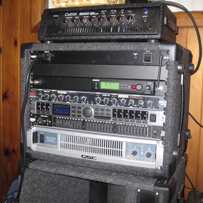

Rack rails are here:
http://accessories.musiciansfriend.com/ ... sku=500307
Here are some simple racks I built.
- Attachments
- small.jpg (57.38 KiB) Viewed 2238 times

Awesome, thanks, that's what I wanted to know. Even with 3 amps at 18lbs, that's doable. I can move my 110lb anvil without too much difficulty and it doesn't have nice handles.
