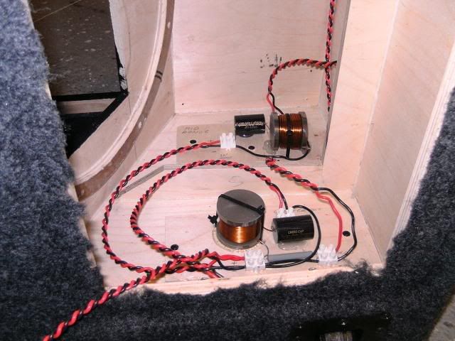

Just re-visiting this after my Omni15 build being picked up as using twisted cable.....
Bill Fitzmaurice wrote:
DAVID_L_PERRY wrote: Keep in mind that the length of runs we are talking about here for speaker builds are tiny, probably the longest run is about 12-24".....
at the levels and impedances speakers operate at noise rejection isn't a factor, while capacitance and inductance are, and those are made worse with twisted pairs....
Bill. What exactly is the effect of this raised capacitance / inductance. Does it have the effect of dropping/raising/changing the crossover freq ?
Would the short runs we are talking about likely alter more than 10% of the filter values (As the filter component values are listed with a 10% tolerance).....
Dave
Posts: 29119
#20 Post by Bill Fitzmaurice »
DAVID_L_PERRY wrote: Bill. What exactly is the effect of this raised capacitance / inductance.
The same as a series inductor and parallel cap: it's a low pass filter.
It doesn't alter the filters per se but acts as an additional low pass section in series with the drivers. With a woofer likely no matter, but could be significant with mids and tweeters.
