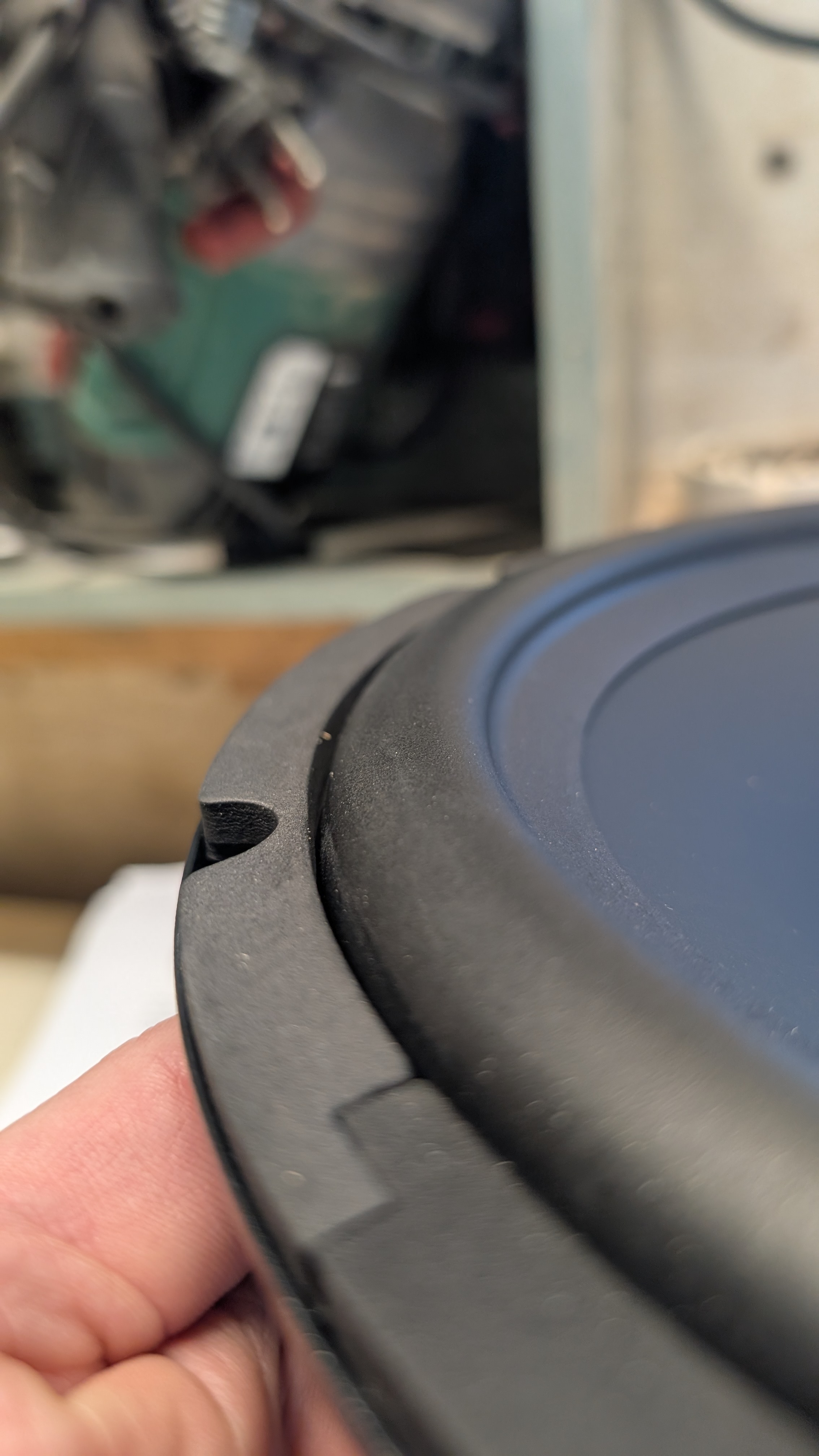

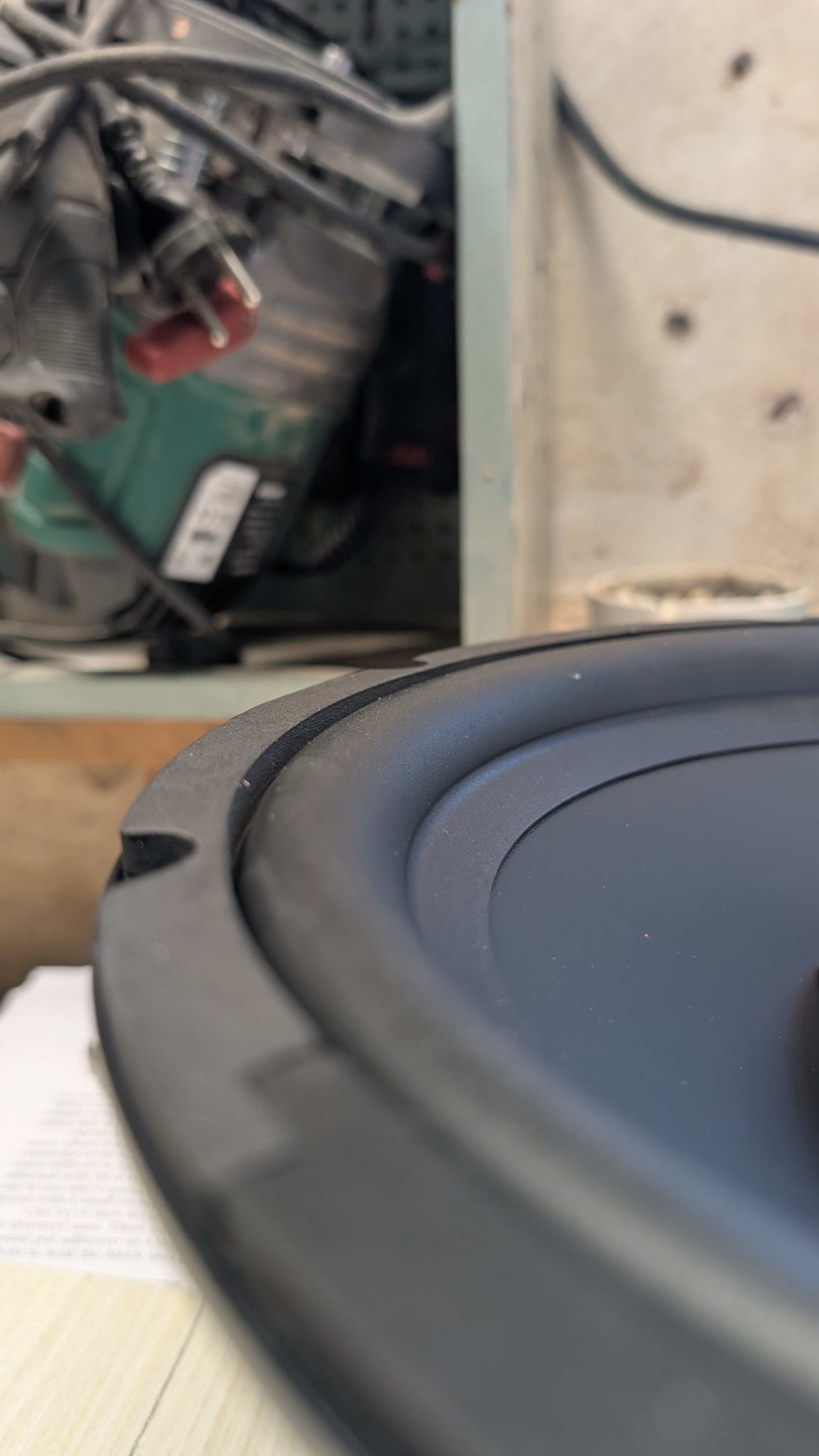

I know it's disappointing to wait, but you're probably making the right call! I'd hate for you to cut the hole and find out it's too big.Marflinger wrote: ↑Mon Mar 16, 2026 9:53 pm Well, both will just refer to the drawing and not unpack and measure a piece. I think the drawing is true and accurate, just not sure how cone movement effects the surrounding (thank you for the assist on the word) and i want to avoid having contact areas here...
I think i will wait for now, i hope it is not too long...
I'll prepare the first baffle with the 281mm cutouts and increase that when needed. But to be sure i need to mount the drivers and give them some voltage to move everything i fear.

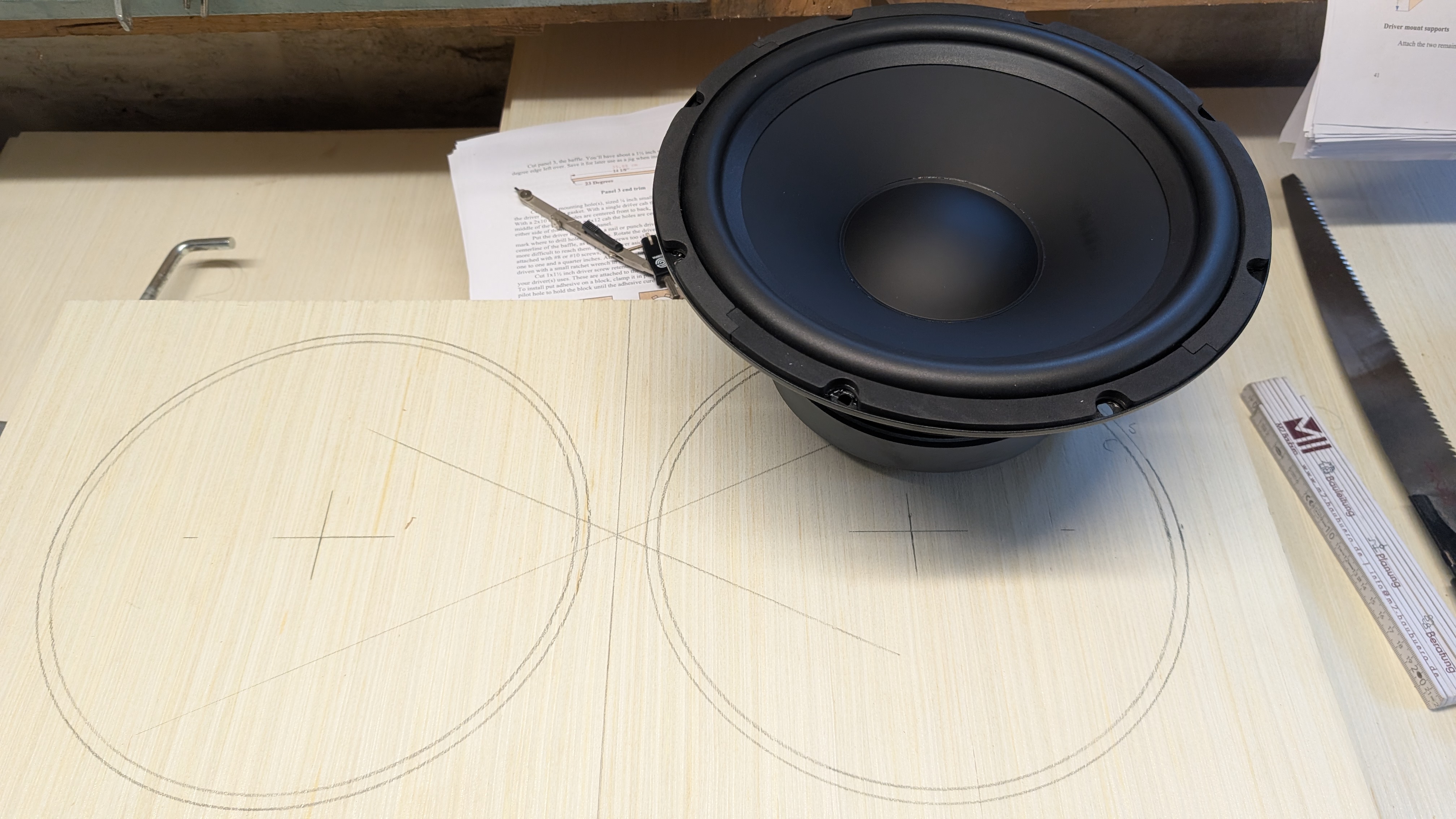

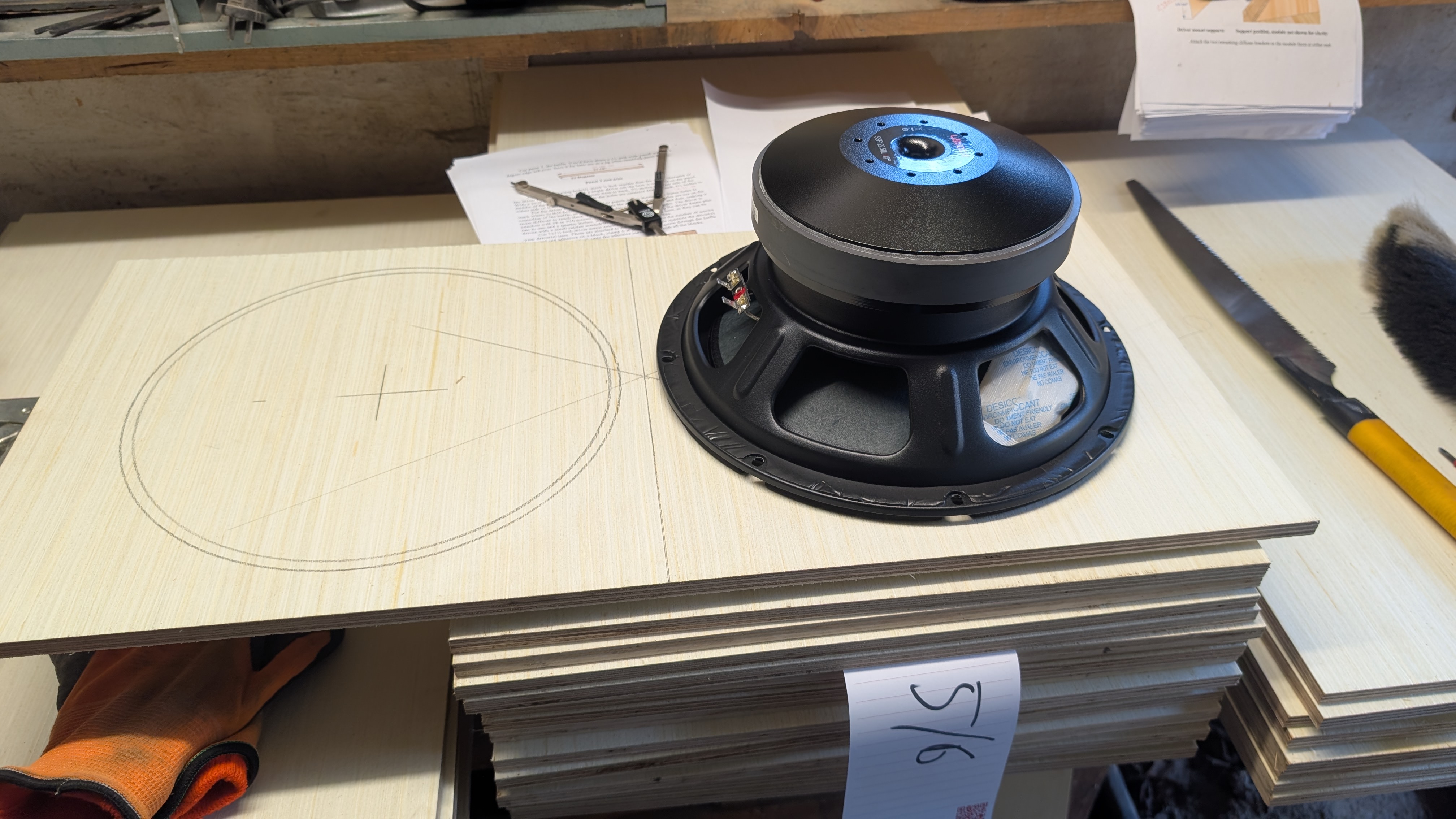

The first batch arrived :)
The surrounding needs no clearance, 283mm cutout diameter is fine.
I just stumbled on the placing, when i put it as in the plans they are pretty close in the center. Is this intentional/needed?
placed with a bit more distance (30" wide cab) would make better spacing in the middle? Surrounding pushed out Pushed in
Both ways do not cross the frame border :)

Re: 8*T30 30" dual 12" european
Oh nice! Time to get building!Marflinger wrote: ↑Wed Mar 18, 2026 10:25 am The first batch arrived
placed with a bit more distance (30" wide cab) would make better spacing in the middle?1000042207.jpg
Pushed in
Both ways do not cross the frame border![]()
I can't imagine it would hurt anything to space the drivers further apart, but maybe someone more knowledgeable will chime in.

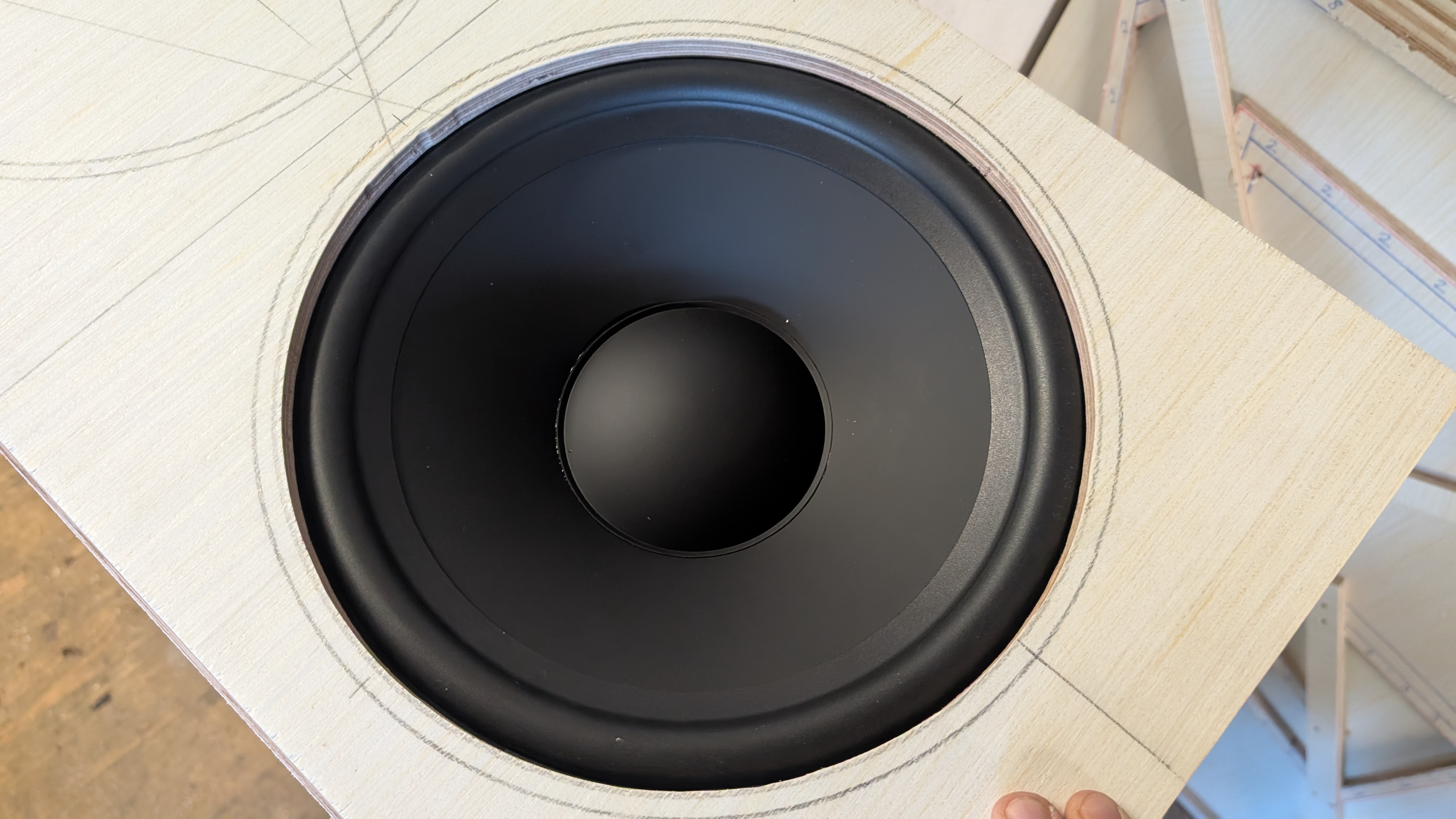

I went on the first with the spacing from the plans, when finishing the cab i'll see if i'd even benefit from more distance; probably fine the way it is.

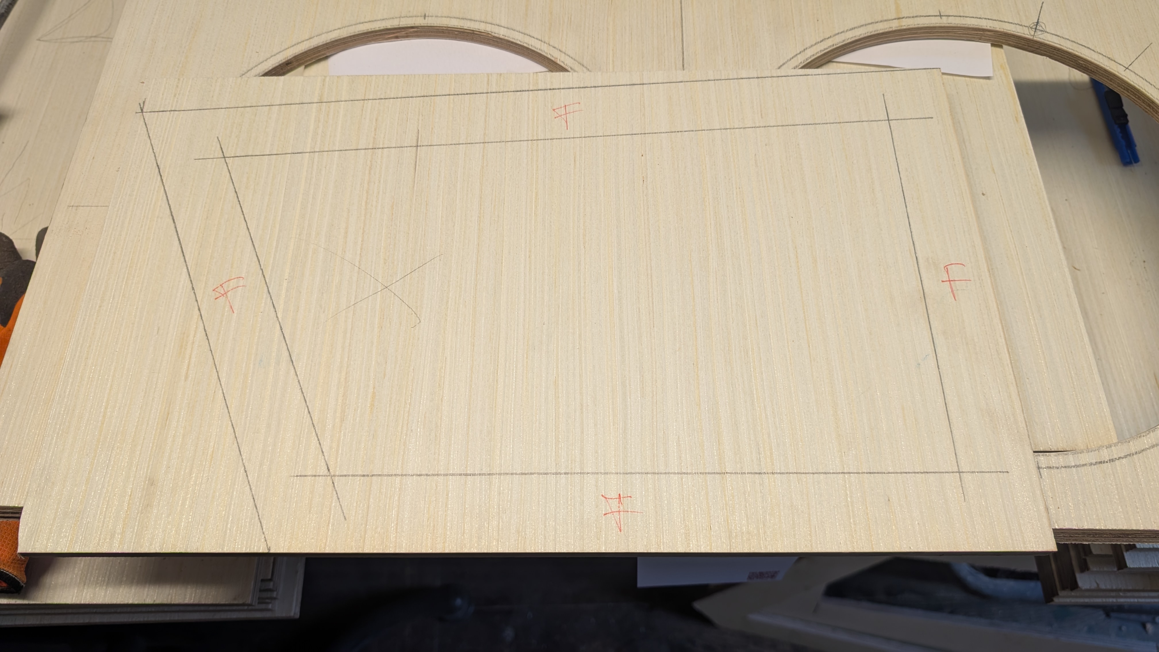

The flanges to carry the access cover later, this would be the idea in one piece (a cutoff from the precut just fits)
Any errors when done in one part?
Any errors when done now? Cutout fits well i'd say.
The surrounding has no contact, no matter how i move the cone.
