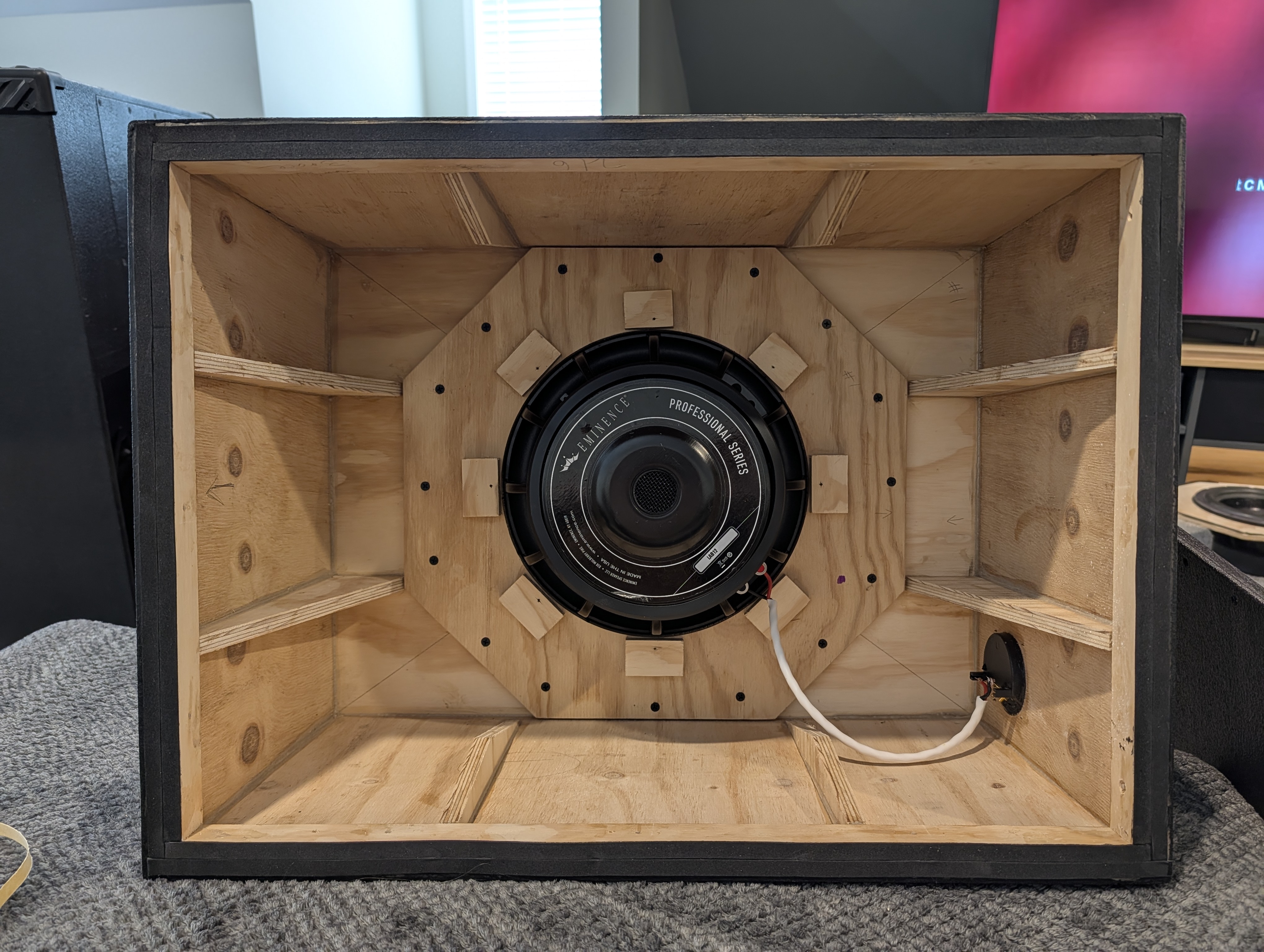

I waited to put the drivers in till I got upstairs to make them easier to carry

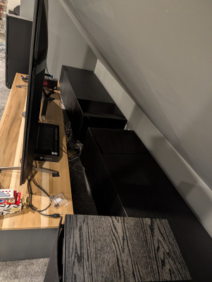

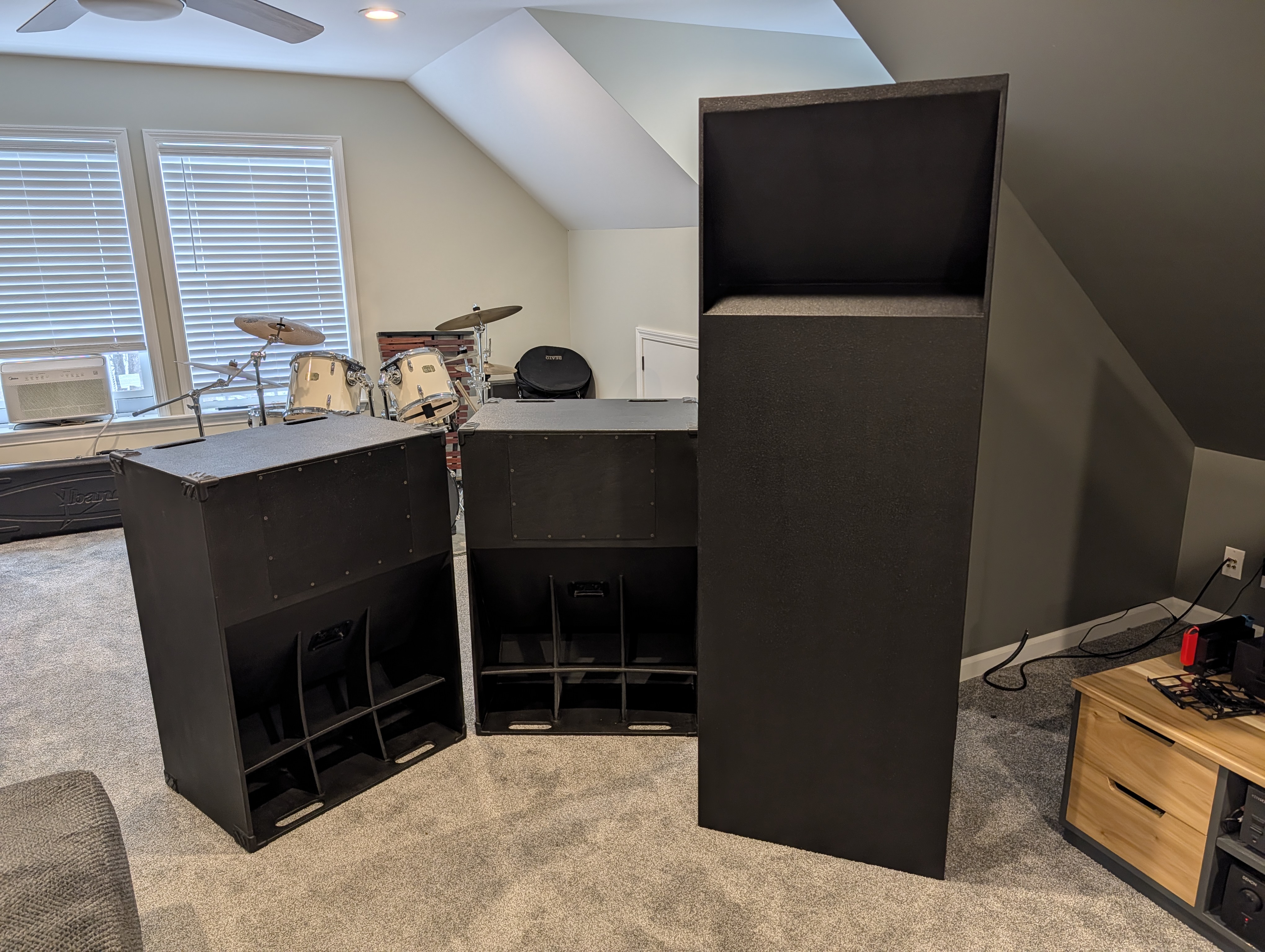

For now, they're both tucked in behind the TV with the mouths facing each other for a bit of coupling. Yes, I realize that there should be more space for proper placement and I wish I had another foot or two of space on the sides to push them out further. Once I got them in place, I regretted not building the front firing mouth version, but that ship has sailed. I plan on turning them with the mouth firing into the corners tonight to see what that sounds like.
I got them somewhat flat to do some testing with my miniDSP and a dayton measurement mic. Max output wise, they sound very similar to the T39's I had back there before, but with around 7-8hz lower extension. They're still dropping off a little quicker than I'd like below 30hz, but I'll play around with EQ more tonight. It's probably the placement, but they're too big to go anywhere else. I wondered if 15" drivers could help muscle out a few more db in that 20-30hz range, but I'll stick with the 12's for now. Regardless, it still sounds good where they currently are from the listening position and there are no major nulls/voids from 30-80hz, so I can't complain.

In that situation placing the mouths close together may not work as well as separating them, so experiment. 15s won't get more extension, only more output via more Vd, and I seriously doubt that more output is required.
