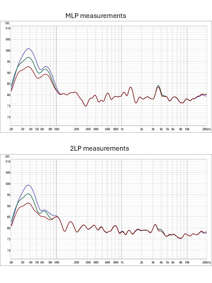

That’s quite similar to what I measure at the main (MLP) and secondary (2LP) listening positions in my listening room (sorry for drifting a bit off-topic).
I created 3 different listening profiles, they differ only in how much the bass is boosted (blue = +20 dB SPL, green = +15 dB SPL, red = +10 dB SPL). I differ from the graph that Seth posted in that I also boosted the HF a little bit (for no good reason since I can't hear above 14 kHz anyway).
I have tri-amped La Scalas that cross over to my two THTLPs at 80Hz using a 4th order L-R. Each THTLP is driven by a 250W plate amp. The plate amps have a -24 dB/octave LPF at 125 Hz and a -12 dB/octave HPF at 25 Hz.
Creating the different configurations (listening profiles) took quite a lot of work.
  • I used REW to help me configure the MiniDSP Flex Eight DSP output channels to get the 1m measurements from each speaker as flat as I could.
  • I used REW to take measurements for use with MSO (Multi-Sub Optimizer) to minimize the subwoofer variation between the two listening positions. MSO generated configurations for the DSP output channels for each THTLP.
  • After that, I worked with Dirac by adjusting the target curves to tailor the sound to my taste and to deal with some of the challenges my room presents. Dirac generated configurations for the input channels on the DSP.
I'd thought I’d overdone it on the bass, but I like the way it sounds. Nice to see that I’m not totally out in left field.
