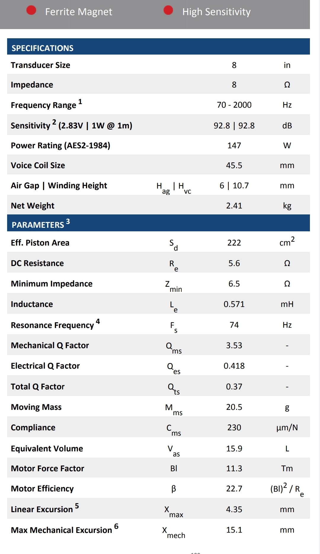

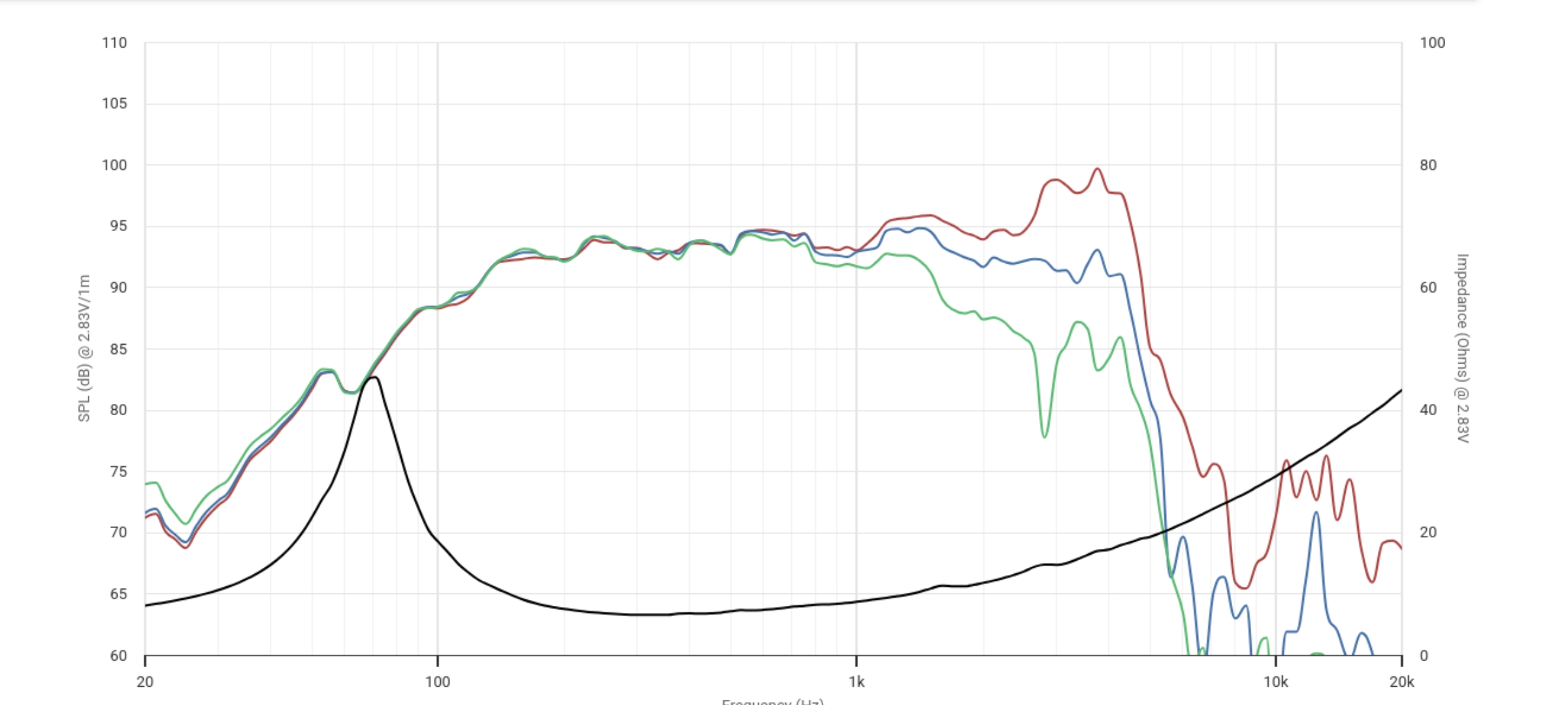

In considering this driver for the DR200, the Theile parameters are good, though could you guys check the curve please, not looking like a rising response in the midrange..?

The mids are low.

Roger that, thanks Bill

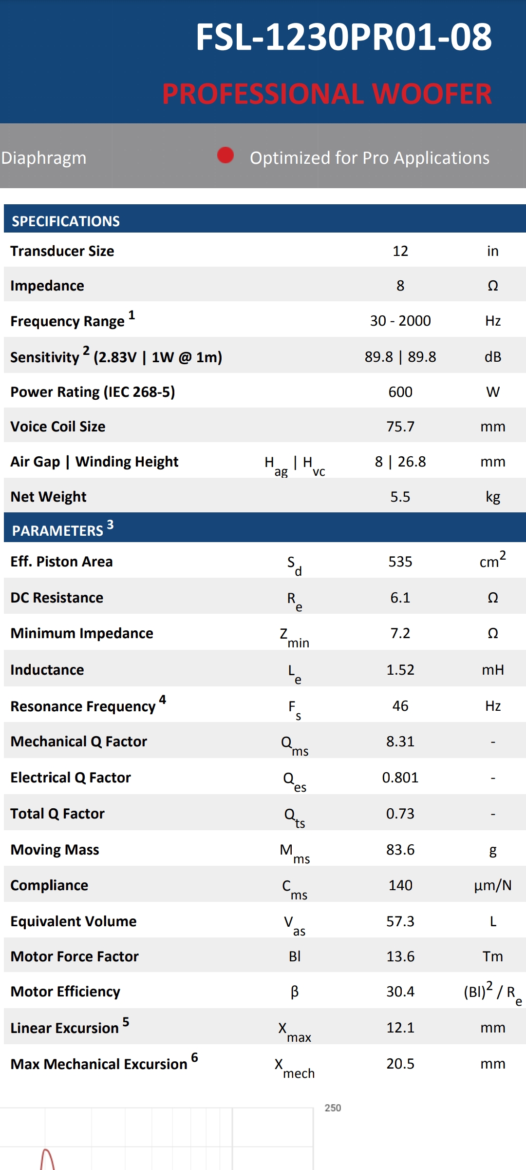

If the QTS was lower on this 12" subwoofer..
https://www.wagneronline.com.au/product ... QdMEDAQoQR We'd have a T30 candidate. This one is half the price of a LAB12 (au$640).
Here's a swing in the dark... could the horn loading/sealed driver enclosure help make up for less than acceptable motor control?

The Qes is way too high for horn loading.

Roger that, thank you
I'll keep searching!
