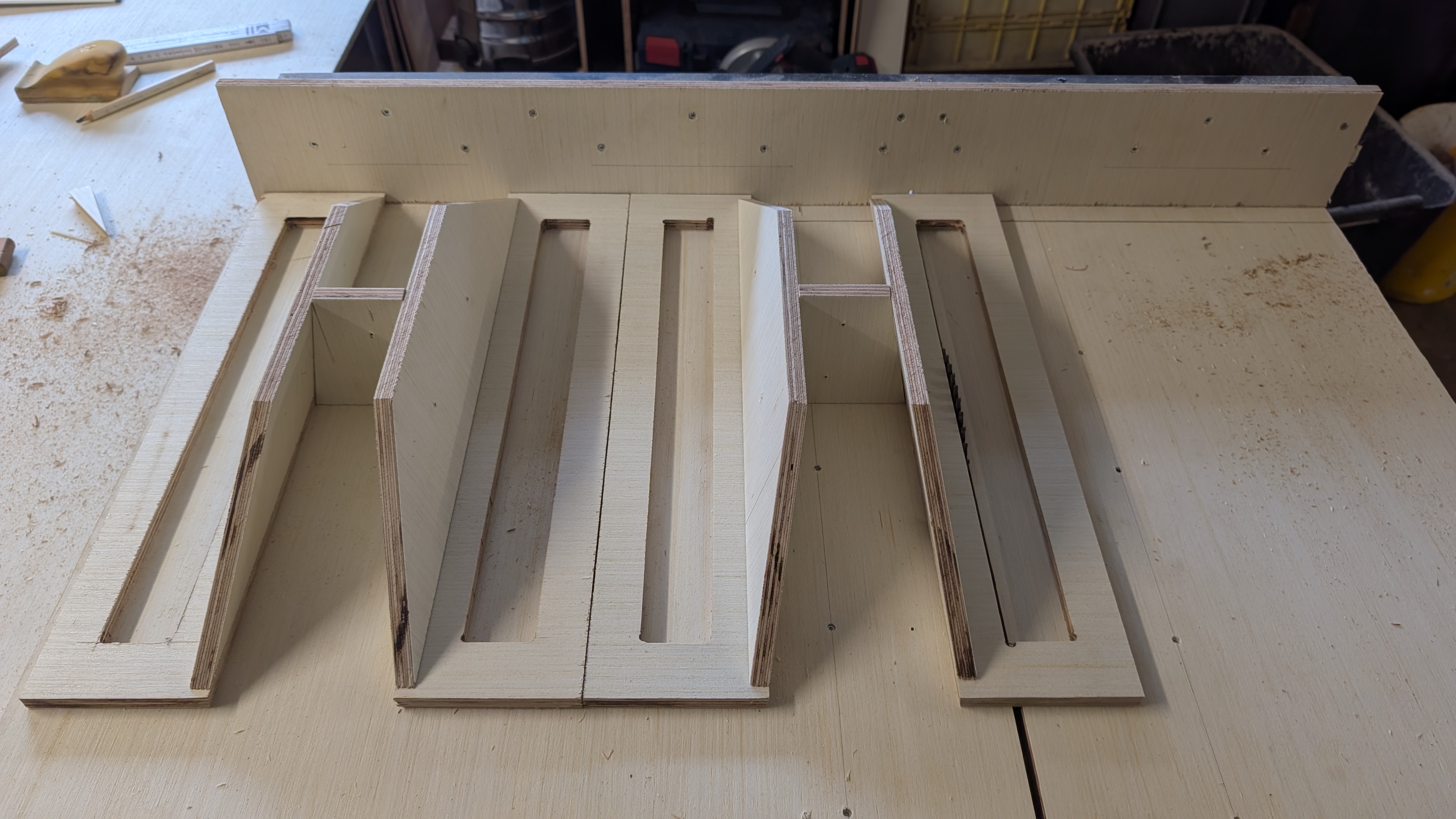

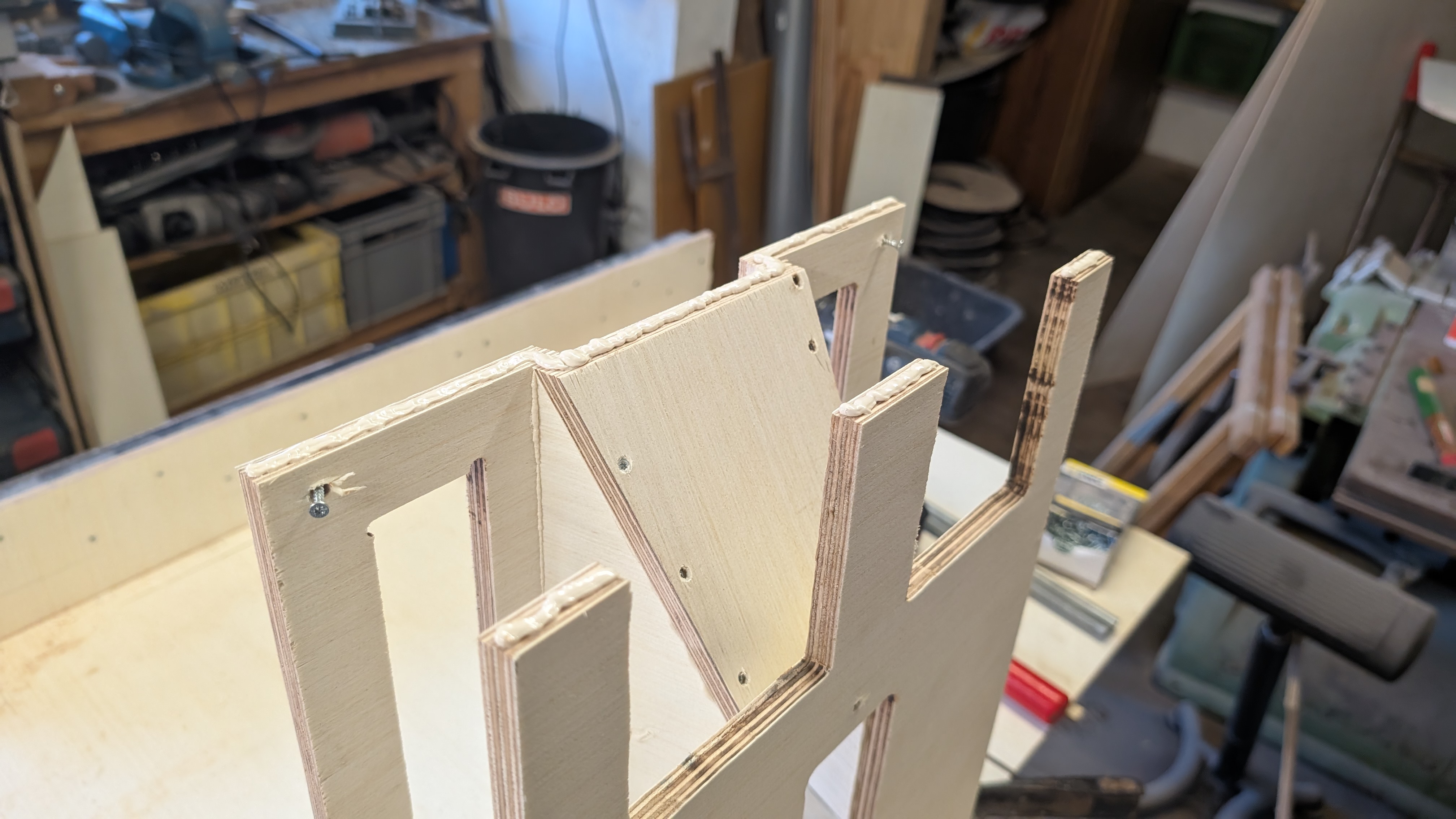

And then i started cutting, dry-fitting and gluing together; for now i finished the mid-horn (except the flushing of the horn entry and the angled cut on top/bottom), the baffle is cut including all angles and top/bottom is cut and has its markings for the horn path.
Sadly i didn't have as much time as i wanted, and the shop needed some cleaning first (and still needs more, but i wanted to start anyway); for now i spent two half days on everything including the cleaning.
Now for the eyes some pictures, will post more later:
(Waiting at the doctors office right now, more later)

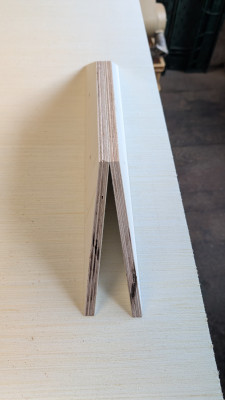

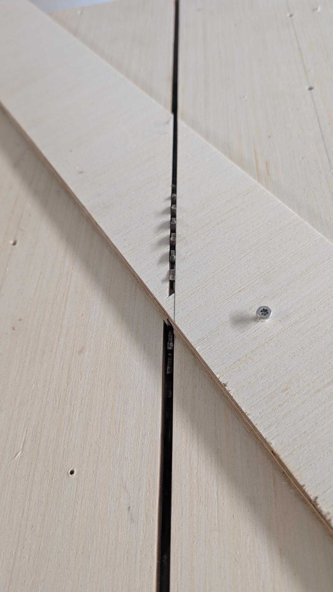

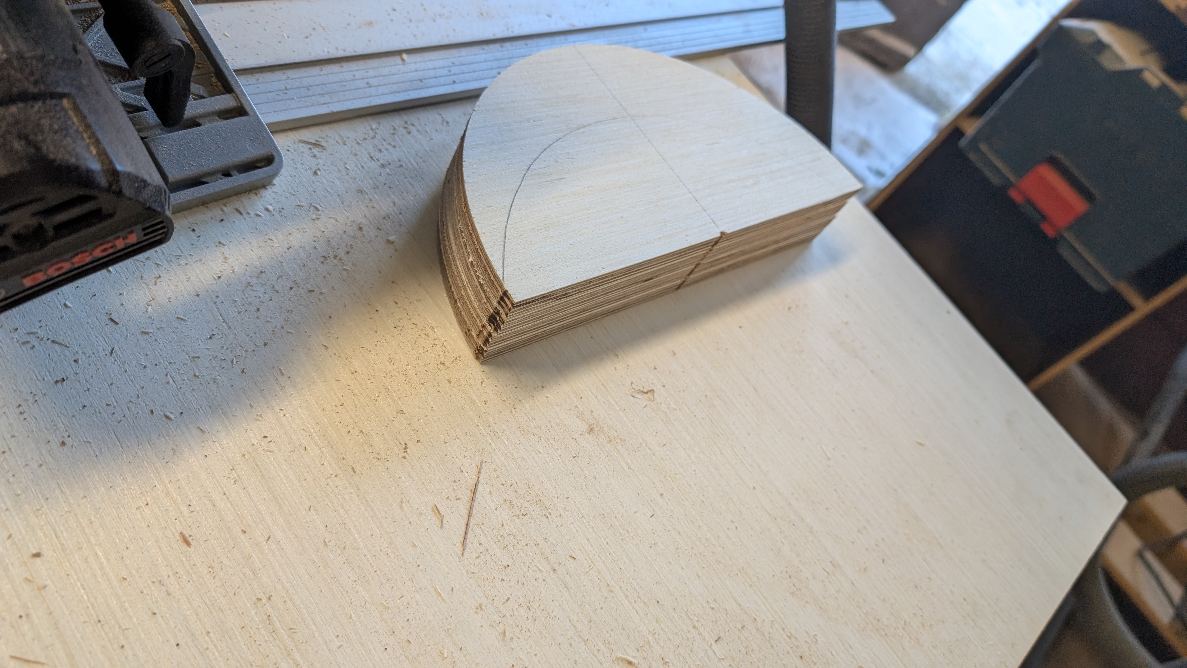

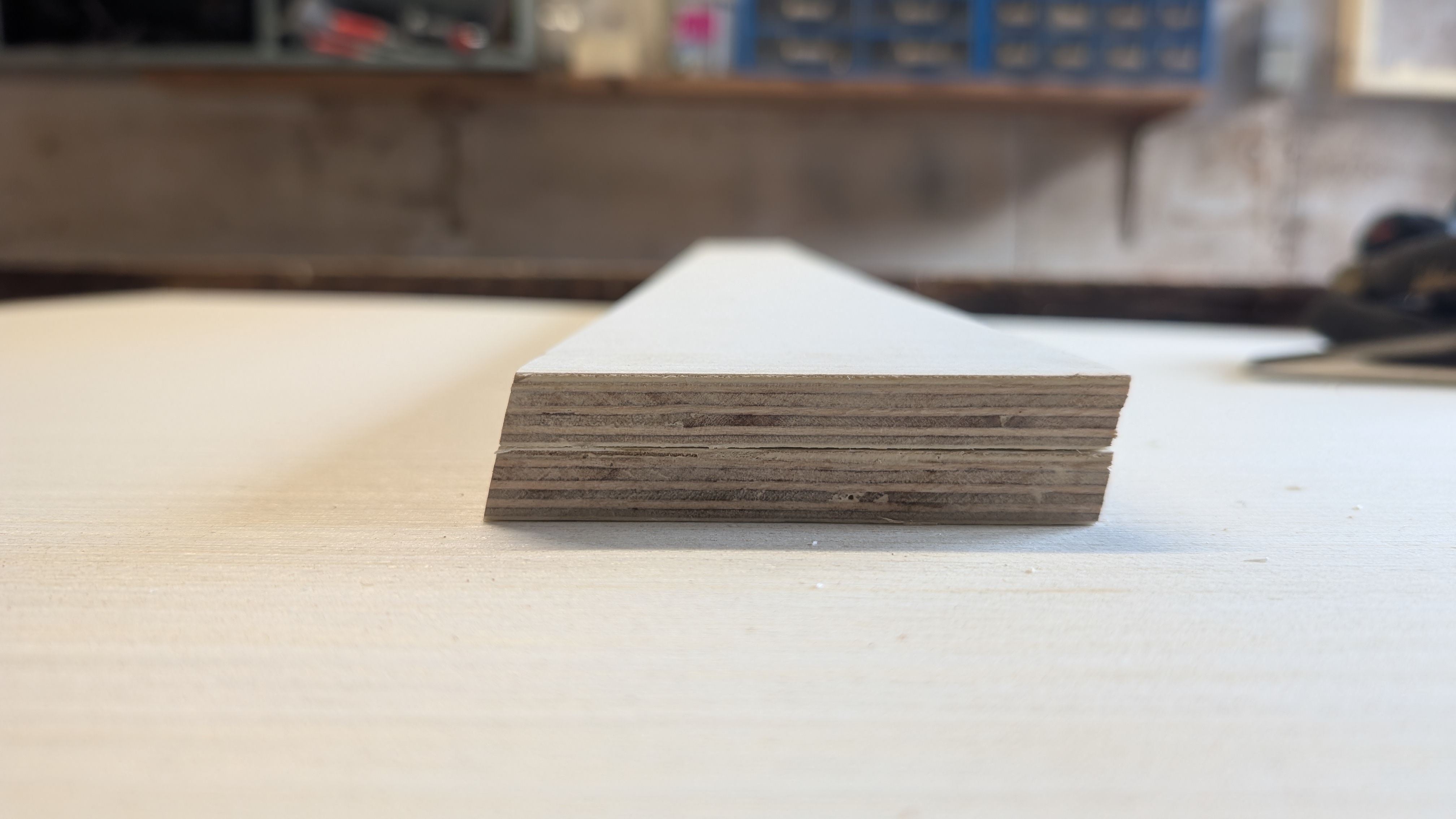

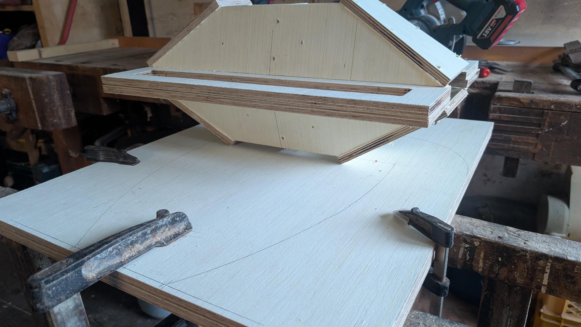

Cut in angle the whole board, to seperate the horn sides from there
Once fully understood, the different angles fit together. That took some errors to get it right.
All parts came together nicely

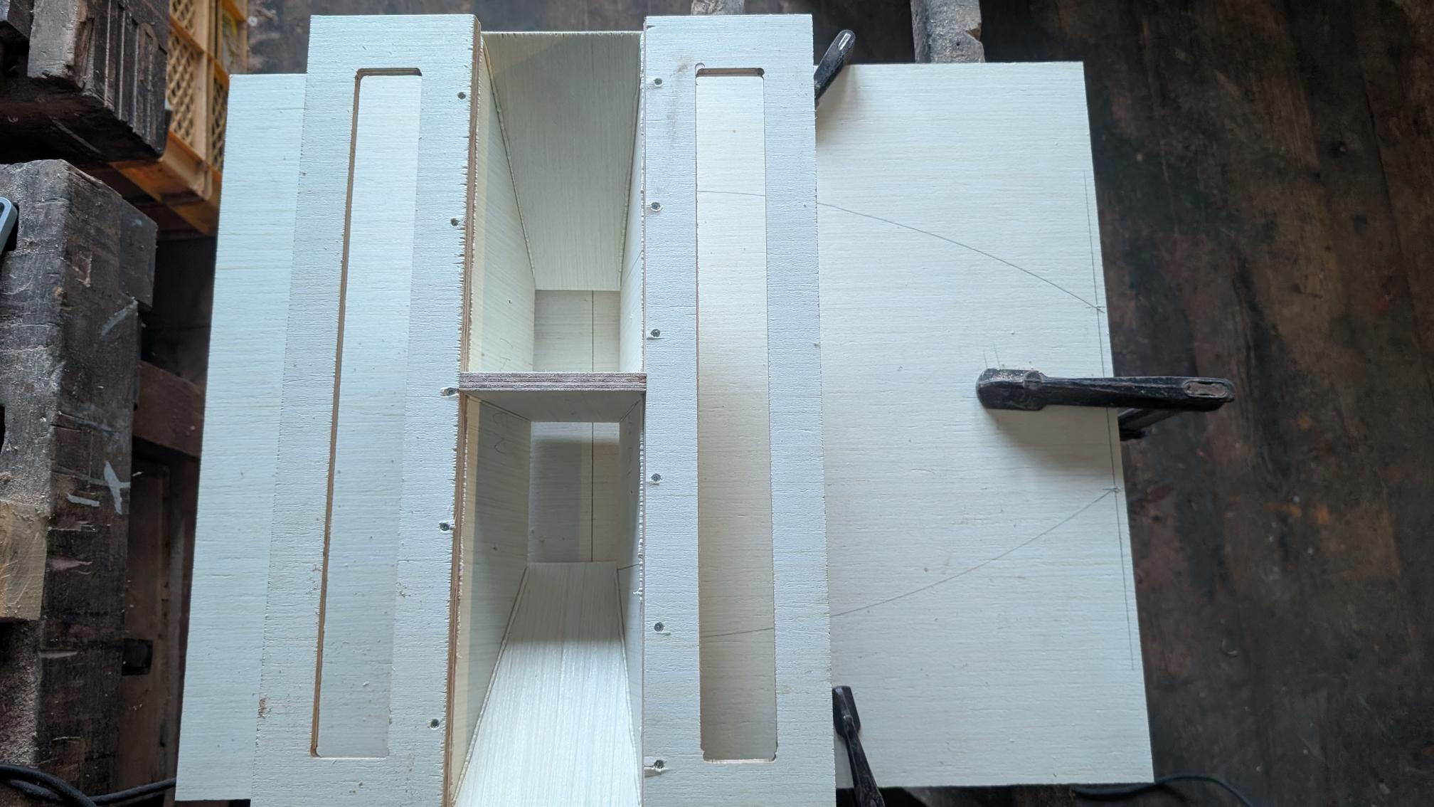

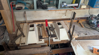

Clamps and screws to hold it all together while the glue sets. Top/bottom horn mouth bigger to cut flush later. Poplar super easy to handle in that way.
A question came up:
Here temperatures are below freezing, but the glue foams fine so far and even expands without wetting it. Anything to consider about that?
Will later add more pictures and my wiring idea, not sure if i get that right.
All in all i read a f*ckload of information the last days, just as it is mentioned: read it again and again and again will probably answer most of the questions. I needed a bit to fully understand that, now my head is sunken in :)

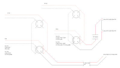

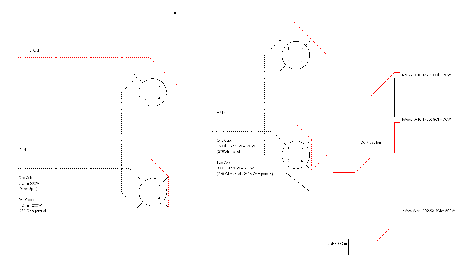

As for the wiring:
Going for Bi-Amped, and willing to couple two cabs per channel, left me with the following:
All power ratings the RMS-Levels from driver specs.
Four Connectors, LF/HF each in and out.
In/Out for both Bands parallel to each other, so a second cab would lower the impendance as written on the diagram.
No real need for 4-Pole-connectors, but whatever.
Any Errors on that so far?
Amps would have to fit the power of two cabs, with limiters lowered when only one cab per channel. Will have to store presets in the driverack for both variants.

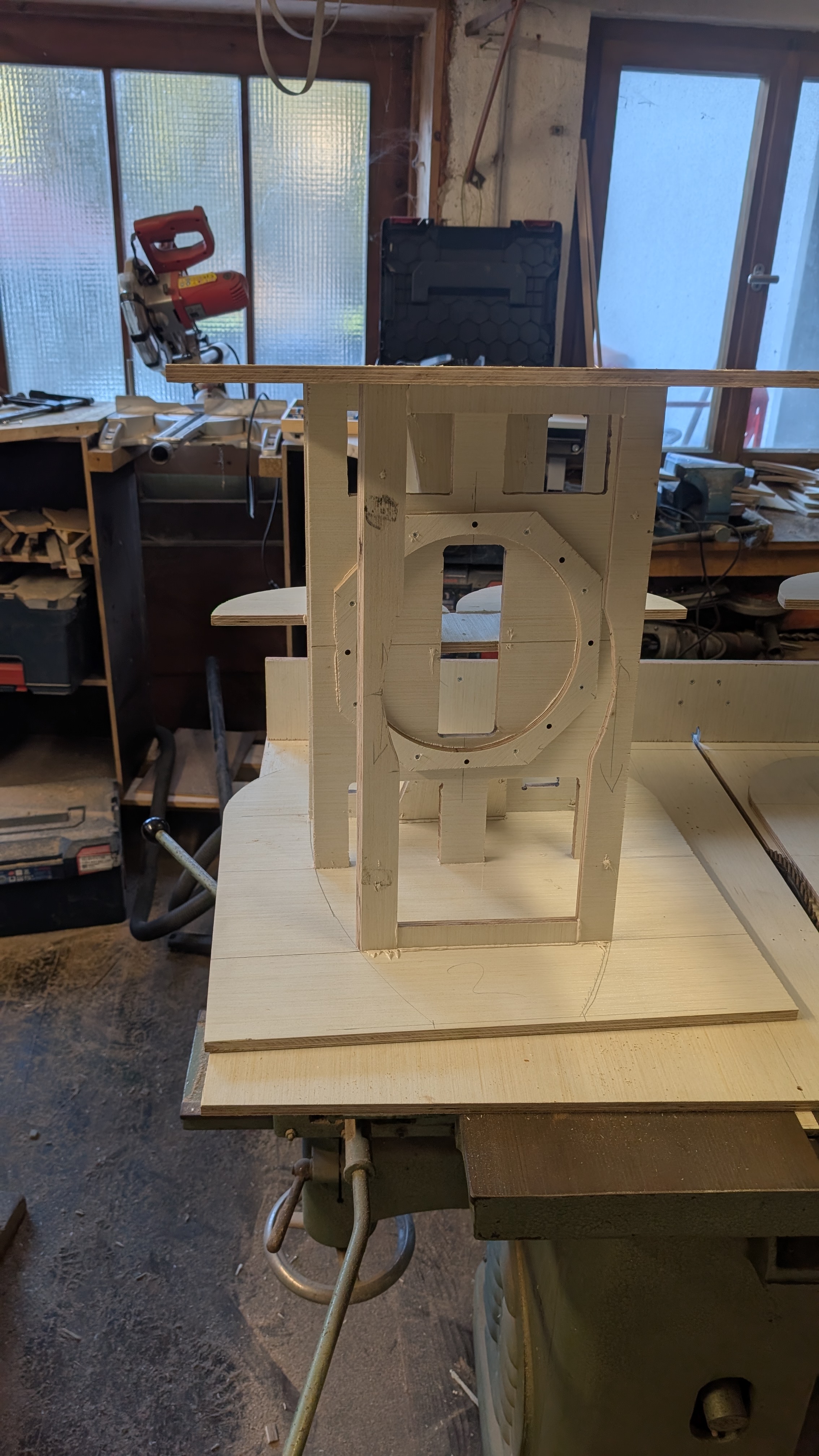

And to the build itself, here are some more pictures, today will hopefully work out to have top/bottom attached and get further on the bracing.

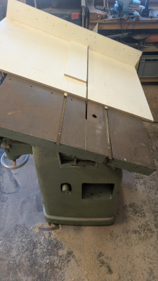

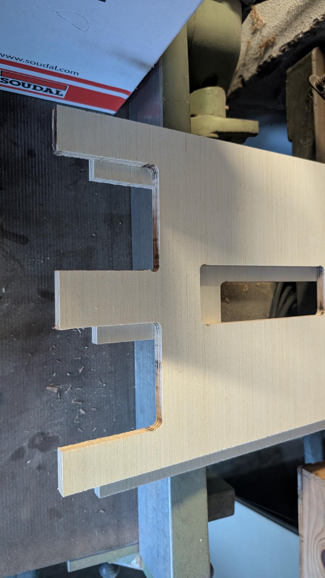

As my tablesaw tilts the table, not the blade, i had to screw the angled pieces for a safe cutting (will fill and sand the holes of course)

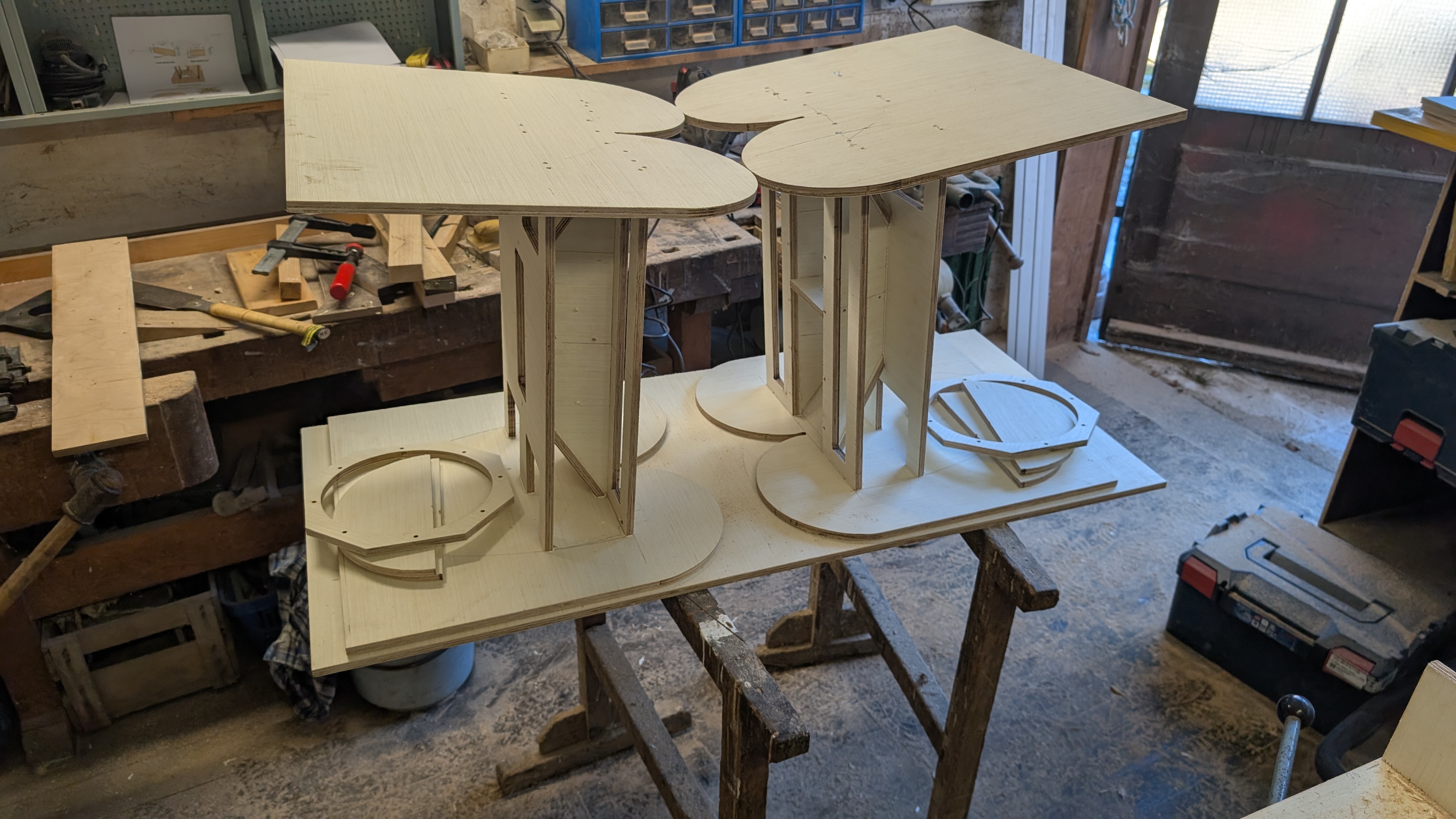

baffles cut
All set, super sturdy. Will probably leave the screws and just fill and sand the hats.
On to fill the holes, scrap the squeezed glue (chisel ftw, works like a charm) and then cut the cheeks.
Drivers waiting for their new home, and handles waiting for me to give them the sidepanels to live in.

Marflinger wrote: Fri Dec 26, 2025 3:30 am Four Connectors, LF/HF each in and out.
Is there a reason you're running this way? Would it be more simple to use 4-pole sockets and leads?
Marflinger wrote: Fri Dec 26, 2025 3:30 am Amps would have to fit the power of two cabs, with limiters lowered when only one cab per channel. Will have to store presets in the driverack for both variants.
Here's a thread dedicated to setting limiters,
viewtopic.php?t=8755
(Happy to be corrected here) As l understand, your voltage limit will be the same for 1 or 2 cabs per channel, it's a case of making sure your amp can handle 4 ohms and cover the power your asking for both cabs.
Not sure how you mean that.
One nl4-input with +1/-1 for lf in and +2-2 hf in, just chained to a 4 pole output?
I liked the idea of seperated connectors to not mismatch anything by error...but to have only one connector would be very pleasant in terms of the space needed yeah...
I'll think abou that, thank you for that input.
Amprack would need a patchbay to lead the both amps to the 4pole-socket, but having only one cable would be very neat as well yes.
@limiting: not been there yet, but i assumed it'll change the voltage when impendance is changed. But i'll look into that before i blow something up; my main part was the amp sizing which seems to be correct so far.

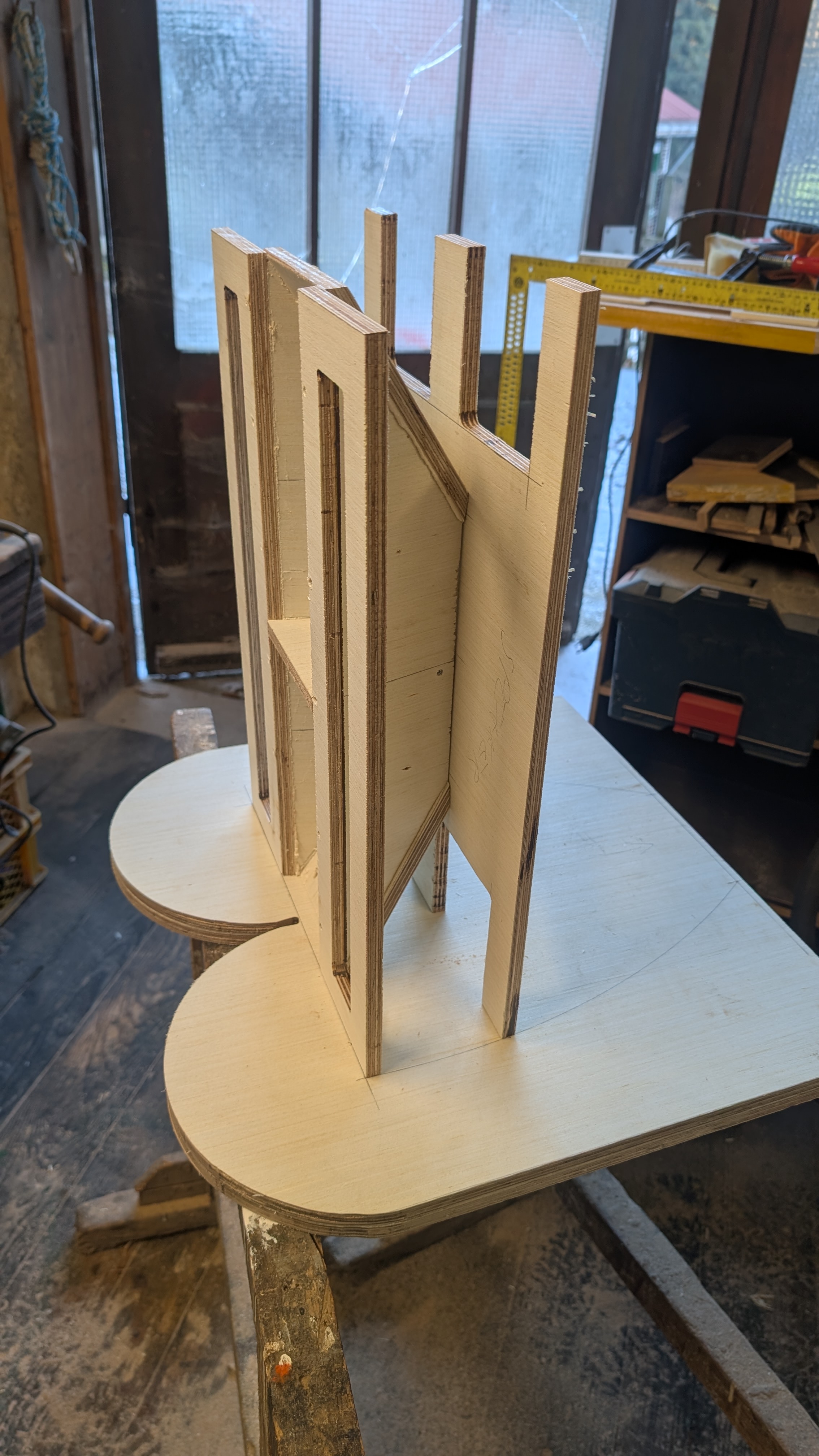

Didn't have much time today, but got the cheeks and dry-fit looked beautiful:

I second using 4 pole connectors for bi-amping. Once everything is built, it should be difficult to hookup incorrectly.
Just one cable in, then one to link to the next cab.
Either pre wire a patch panel for the back of your amp rack
Or some short breakout/Y cables you could leave attached to the amps to connect to your long 4 Conductor cables during setup.
Drive rack Voltage limit stays the same for one or 2 cabs in parallel.

I'll go for the 4pole-one-cable solution, thank you both for hinting that.
And as well for the limiting, i'll keep that in mind.

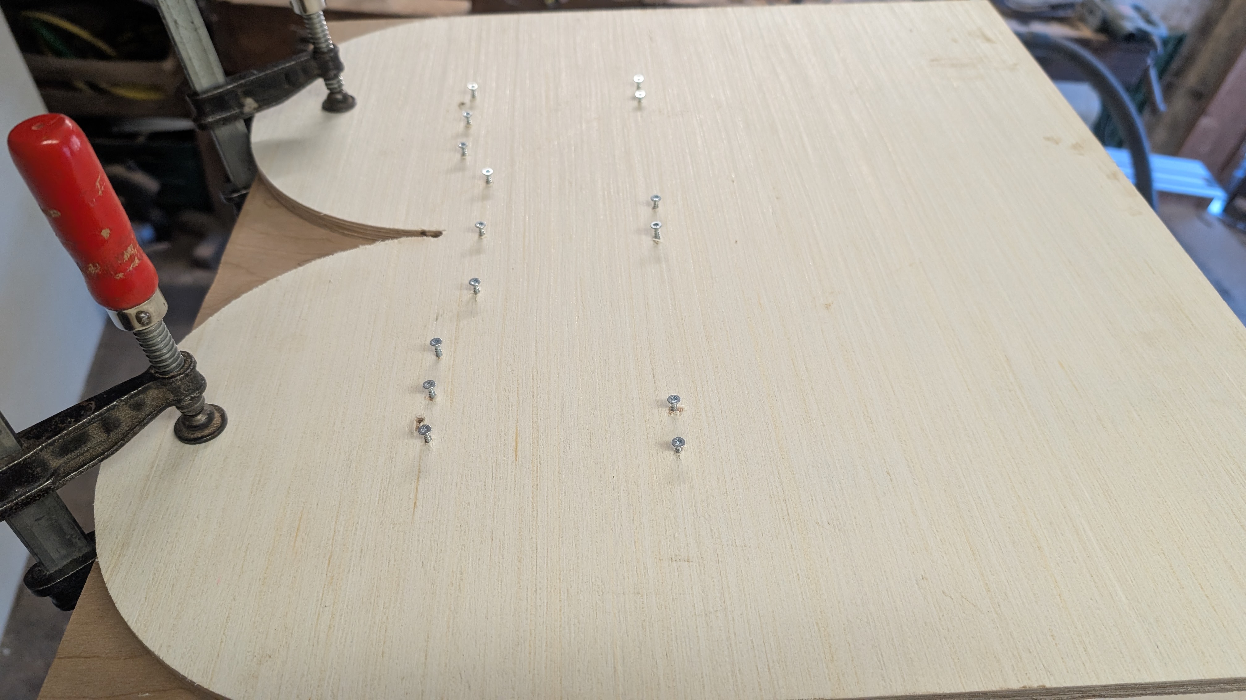

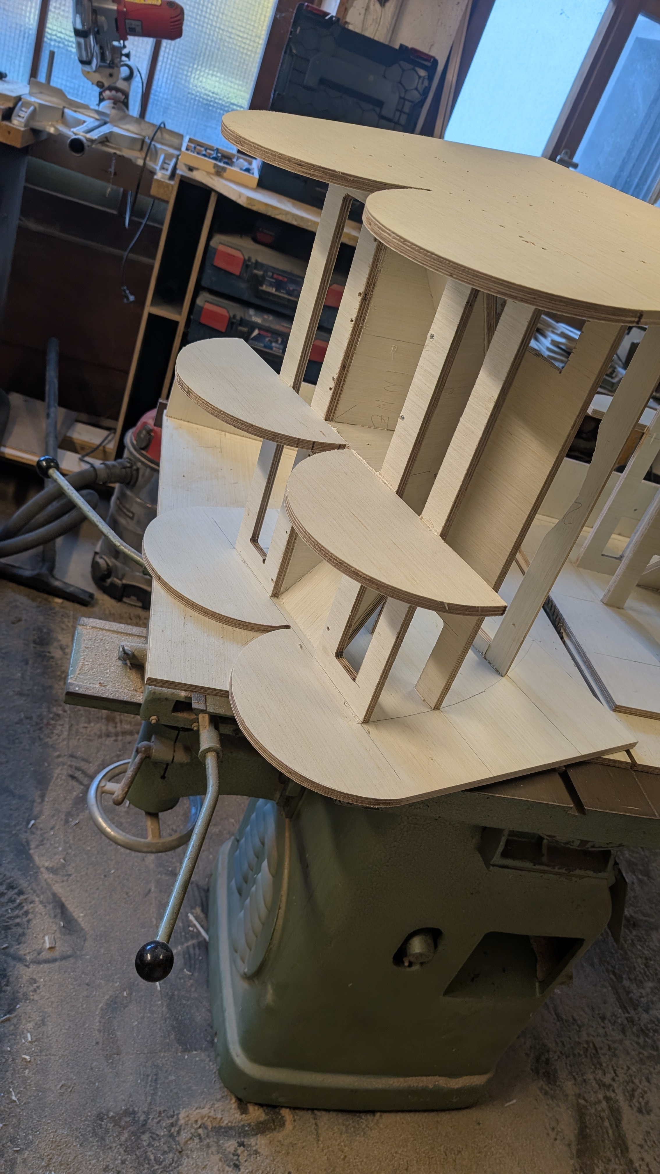

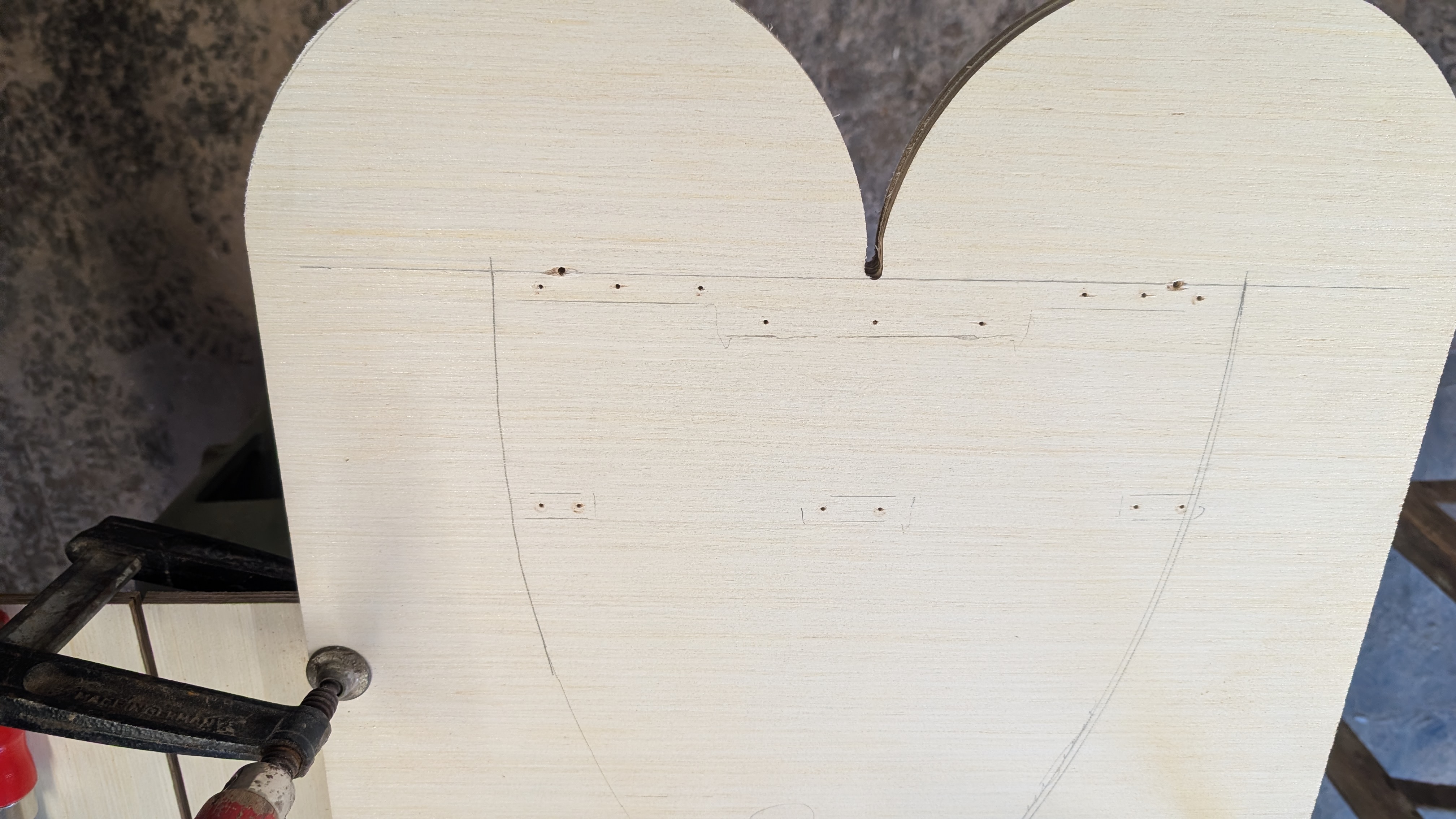

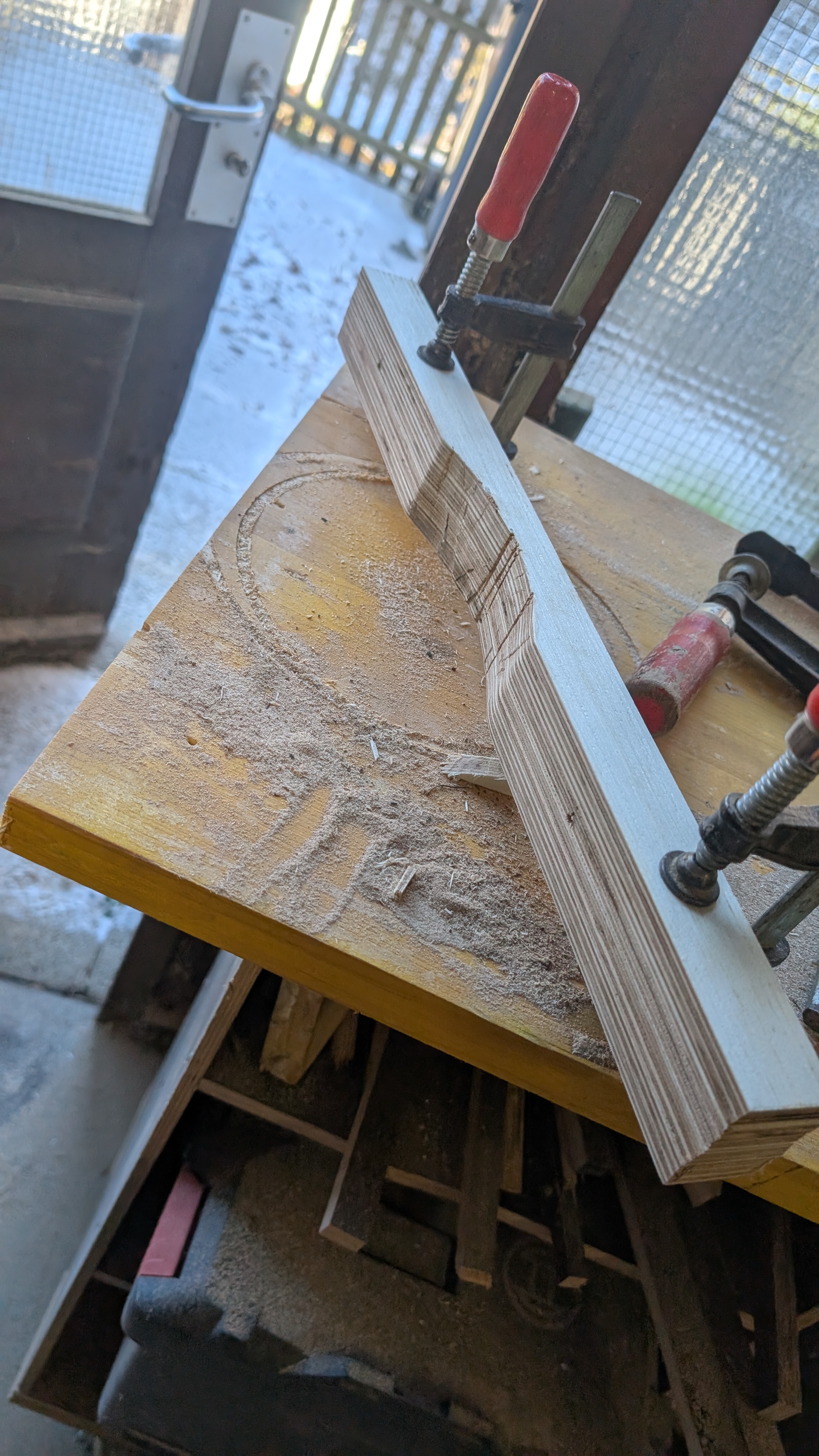

For now i only managed to cut some parts and fit the boys to their top/bottom; really like the part where the final dimensions become visible :)
Now the glue needs some time to set, as its friggin cold here this takes a while...
Together :)
So it'll never come apart
Handy to get the glue on that end first, and then screwed to the ruler first so fix in place
Halfmoons waiting
Spacer fitting
Drilling through both panels at once came out quite handy

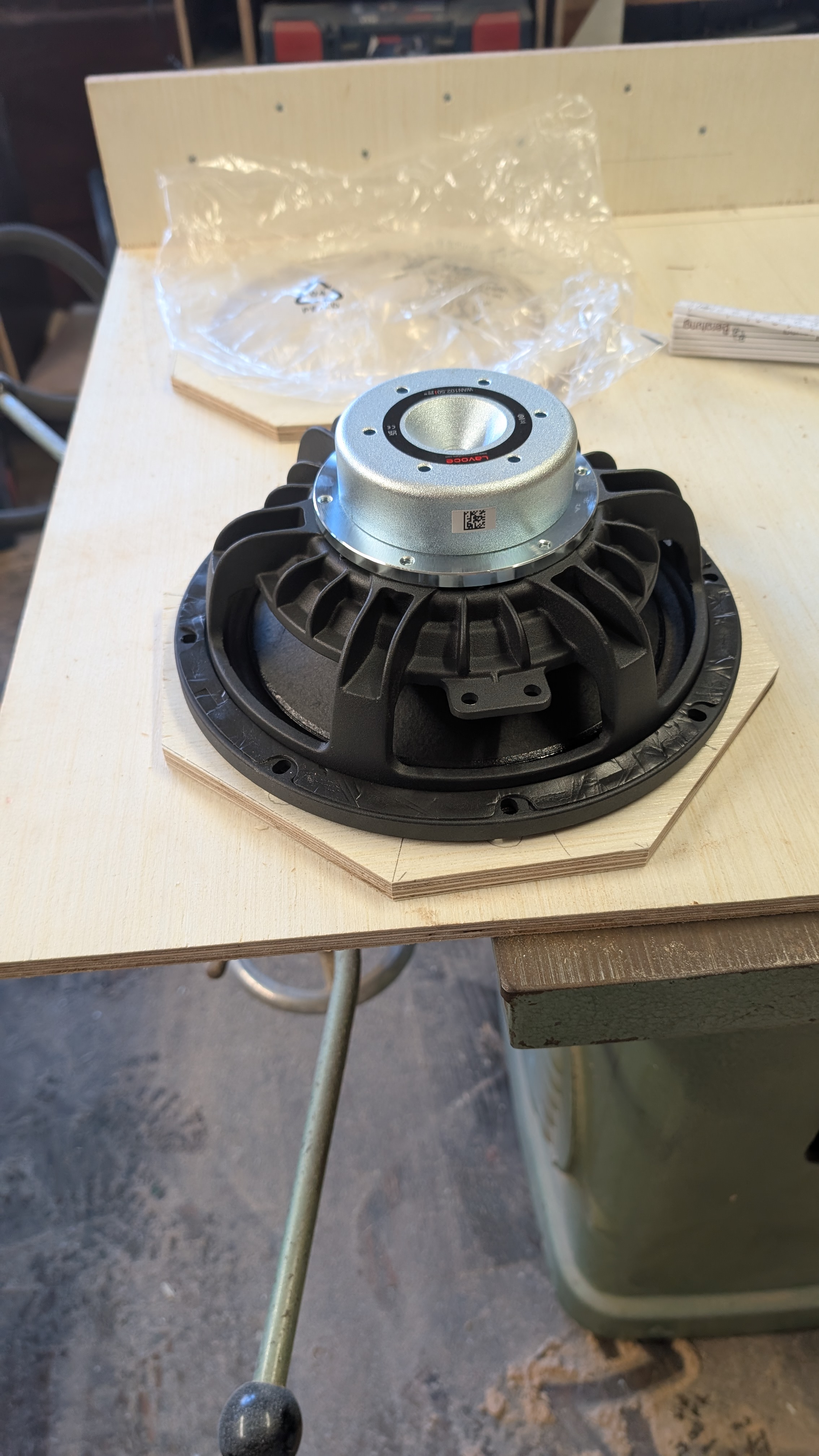

The woofer spacer somehow got too small, but i figured it wouldn't matter probably.

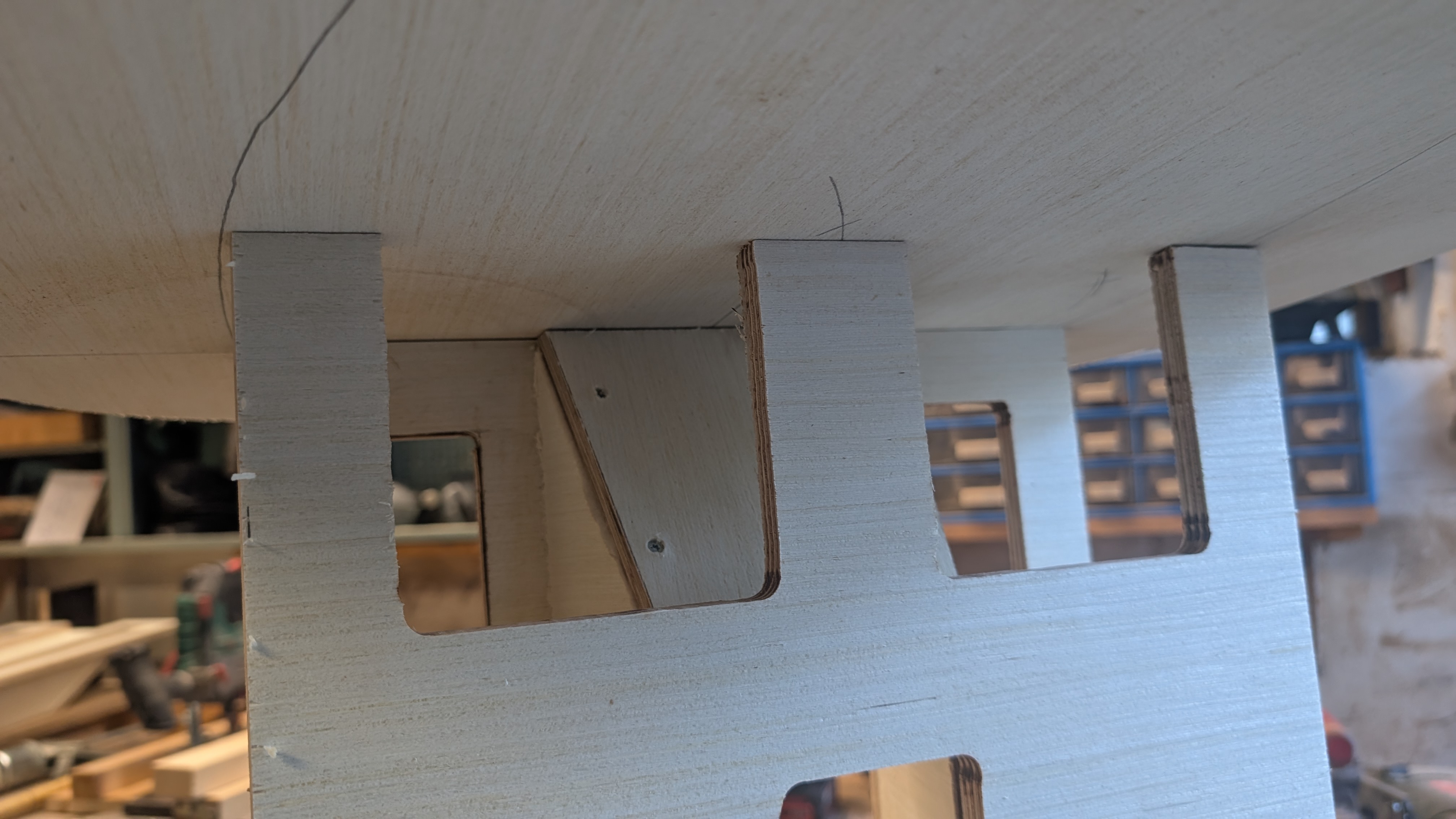

Im just not quite sure about the t-nuts for lf-driver: i could screw through the baffle as well, and place the t-nuts there - or just in the spacer before putting them on the baffle.
Through baffle seems better, but where the horn flares top/bottom meet the baffle, i have no way to get a tnut in there.
So either rotate slightly to get around the horn, or these two go just in the spacer - or all my thoughts are stupid and all go just in the spacer?

Marflinger wrote: Sat Dec 27, 2025 7:39 am The woofer spacer somehow got too small..
Which part of the spacer ended up too small?
Marflinger
Posts: 80
Joined: Thu Dec 04, 2025 1:20 pm
Location: Germany-Blackforest
Re: 2 DR250 build - Europe Materials
#12 Post by Marflinger »
Keryn O'Shea wrote: Sat Dec 27, 2025 3:49 pm Which part of the spacer ended up too small?
The outside dimension, about 8mm (i think 1/3"?) smaller measured between the parallel edges outside. The driver cutout fits, just the width of the spacer "bar"(?) The woofer presses on is smaller.
not smaller as the driver, so i assumed it would be fine? See picture, still overlaps.

Marflinger wrote: Sun Dec 28, 2025 1:06 am The outside dimension, about 8mm (i think 1/3"?) smaller measured between the parallel edges outside. The driver cutout fits, just the width of the spacer "bar"(?) The woofer presses on is smaller.
Okay, no problem

Alright, thank you both for the explanation. Woodscrews it will be, problem with nuts vanished :)
I got the spacer fixed now, as well as the middle cheeks and the horn bracing to the front as well. Now again letting the glue dry to get properly rid of the excess...by that time i filled every visible hole as well, they'll dry in the same time.
Today i brought them in the livingroom to support the drying a bit, will see how long it will take.
Next step would then be the horn sides and the pvc-pipe, will maybe fit into tomorrow.
Some parts for the eyes:
The tilted table, 20° are already wild. But that saw is working fine since around 1960s, love it.
Roughing the front braces to fit
Cheeky view, glue still wet
Braced and strong
