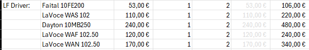

10" Driver:
Very useful database imho: https://loudspeakerdatabase.com/search/ ... %89%A450.0
here added the parameters from the plan to get an overview. Not at all a complete list, but gives you a range.
With maximum output in the low-end (and european availability) in mind i'm on to choose the LaVoce WAF(or WAN)102.50 (slightly out of specs by the Vas below 25l as the WAN as well; link for that specs included: https://loudspeakerdatabase.com/search/ ... %89%A450.0)
The WAN comes with a slightly higher pricing in germany, the question for me is if the specs will have an effect that would be worth it? Weight difference is obvious, but i don't really care about that weight.
WAF has a way higher Xmax? Higher power handling? Lower Fs, that will not be needed, but anyway? Vas closer to ideal? Weight aside, i don't see the benefit of the neo-variant.
My bad, compared to the discontinued WAF102.52.
WAN has the higher power taking of 100W, and increased 1b sensitivity. WAF slightly lower Fs, but not used anyway.
Anyone compared these two in theory (simulation) or used both?
These are my results getting quick prices:
(Total costs for 2 cabs on the right)
Not sure if the price of the driver goes linear with the quality at the end, any tips?
