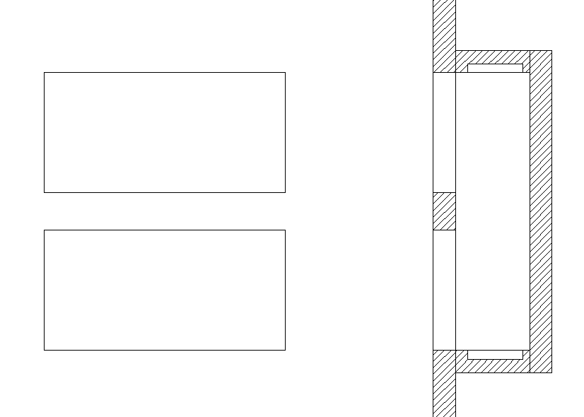

Second handling idea in the backpanel; including connectors:
To avoid sticking out cables, i really love the idea of hiding them sort of "inside".
Following sketch for the concept: The (closed Backwall behind the cheeks) moved that far outwards, to cut two holes inside. On the inside, a sealed box against the Backpanel, with the connectors in the top/bottom part of that box. the line between the two holes as another handle, that sits flush and "hides" the connectors sort of inside the cab.
As long as cables are connected, handle is not needed. And when connected, cables just stick inside. Measurments to be taken, how far the backpanel has to be moved to fit speakon-connectors; but i think it could be worth it. Couldn't find something similar here, somebody done before on a DR?

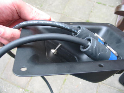

Connectors in the back panel: yes. But that may be simpler if you are not combining with handles. Connectors into the recessed seem deep to me.
I use Neutrik NL4MPR connectors on my cabs, not the smaller NL4MP versions. The smaller versions are OK on metal panels, they may rip out of wood when abused.
For recessed mounting I make a circular cut with a hole saw, about 5.5 to 6.0 cm diameter. Behind this I glue a smaller piece of 12mm or 15mm plywood with the small circular cutout for the connector, 2.4 or 2.5cm diameter. After painting I install the NL4MPR into this smaller piece of plywood with wood screws.
Again, if this does not make sense just let me know. I still have several cabs with connectors recessed like this. I will gladly post a picture if that helps.

My idea of the "angled" plugging is, that even the whole connector is flush with the surface, and only the cable is further outside. The combination with the handle was just by the idea, that when nothing connected the handle comes in handy; while during a cable connected, no more handling of the box. so a double-use of a single point if you will, and no connector showing above outer surface (and beeing pinched/ripped/whatever)...
I'll figure out the measurments needed and think about it from there, but thank you for your input.

Assuming these, which have a plate of 51mm, would end in a 60mm deep "Pocket" added to the inside of the Backpanel. Including the Lid of the pocket, assuming 12mm as the rest of the cab, would result in an overall addition of 63, lets say 65, mm (which equals to a texan slice of a cow i guess, or roughly 2,6 inches)
That addition could add the option to have corner handles around the backpanel as well, to make use of that additional space somehow, as in both standing corners the rounded cheeks offer free space by design.
Could be done smaller, adding a metal plate and the small connector like the NL4MPST; but i guess i will want the space to comfortly plug/unplug cables from there.
So, if so, i think the 2,6 inches extension would be my way to go. Seems sonewhat reasonable for me; could even add a cable channel in the back panel for keeping them flush as well by adding a vertical doubling brace centered above and below the added pocket, and slit a channel in the outer surface where the cable can sleep in...
I assume, the not needed extension and the adding of weight causes a headache in the designers head (who designed a super lightweight box compared to the power); sorry for that abuse in case that helps.
I guess i gotta hear the result without that (seemingly obsolete) addition; i am probably hanging on memorys that should have been gone for long but they still stick with me.Bill Fitzmaurice wrote: ↑Sun Dec 07, 2025 9:18 am Kick bins are a relic of 1970s tech, rendered obsolete by the introduction of true subwoofers and high xmax drivers in mains. When subs and high output mains came along all users of kick bins should have retired them. But many added the subs and high output mains while keeping the kick bins, making their systems overly large and complicated. The introduction of line array technology should have made kick bins nothing more than a memory, but somehow they still hang around.
I'll be super happy when i turn it on and do not feel the need to add something, looking forward to that

I have searched but did not find pictures of the handles in my DR. I do remember using a jig to cut identical holes on both sides for these handles. Because of the peculiar placement and angles I did not trust myself to just measure, draw, cut and end up with exact mirror image holes on either side. I'm afraid the jig may have been thrown away as well.
No worries, I see what you mean now. What you have in mind does a better job protecting the connectors from damage. There are some factory made dishes that help. They are not deep enough though to have Speakon connectors completely flush with the external cab surface. I do use these on some of my cabs:Yeah i can imagine that, thank you again for clarifying in detail. In your version, the cable still sticks in a right angle to the backpanel away from the cab, which is what i want to avoid by the rotate and hide inside the handle.

Just for not leaving threads unanswered:Marflinger wrote: ↑Wed Dec 10, 2025 1:48 am For the backhandly i'm waiting for different connectors to arrive to test the handling, will update soon.
Playing around with a cardboardmodel first, and then getting scraps together, i figured a (super roughly) version that works for me.
(sorry for buildquality, bur for handling and testing i didn't care and just got it somehow done) For super comfort handling, the holes have a height of 900mm, the bar 20mm, so total is about 200mm. Width came out at 165mm, which is kind of the limit (i wouldn't go more narrow for two connectors) Both connectors work; i didn't have 12mm sheet scraps, and i figured to take 18mm for the bottom/top for using bigger screws for fixing them would be a good idea. even the small one is super sturdy that way. Both sunken in to be flush - when done precisly and not bye eyeguessing as in the picture that should add more stability.
Backsides could be same Material as the bent cheeks behind it in the box, maybe somehow damped. I'll take a look for that.
To be comfortable, the Handle should be doubled on the inside, as the corner handles in the plans are usually added with a quarter rounded stick, half round in this case.
Measurements will follow, depth is 60mm without the back; so 63mm in total but it will fit a bit between the cheeks.
Edit: Measurements as following:
For two connectors, the width in the back would need to be 85mm.
Bi-Amping wants to have two inputs and two outputs, i'm thinking about the need for bi-amping to be honest.
But assuming that, the total situation would be like this: and add 32,5 mm in the back.
And if not bi-amped, it can be done like this: Which would add just 9,5mm.
I'll think abpout the bi-amping, and decide before doing the backpanel. But one of these will be my way to go.
Just for getting the dimensions, this would be the backpanel in its correct size with the addition from the outside:
