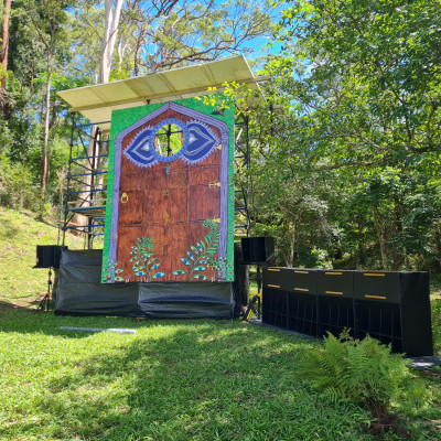

My next door neighbour spoke about a friend of his who wants to coordinate EDM events, so l contacted her and took 4xT48s & 2xDR280s to her farm for a demonstration in September. There was around 20 people who came & went over the night, & the responses to the system were very positive & was asked to bring it back for her first event for 200-300 people on the farm 7-9th November :)
All went well with around 40hrs of run time and 32 or so Djs over the three days, l made a few connections with people and it's looking good for being hired for future events.

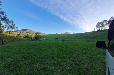

The site was challenging, l would've liked to stack & V-plate the subs, but the space wasn't available. What l noticed about the site was the LF was super strong ahead of the stage, l had to pull it down 12db to find a balance, but behind.. there was next to none! We were setup right in the bottom of a V shaped valley, with a steep hill behind. The bass was so strong, l moved my camp to 150m away around the hill on the flat & it was still loud! We were at 110db on the dance floor & the amp just idling. Was the topography of the site doing this..?
This shot is looking forward from the stage

Keryn O'Shea wrote: Tue Nov 18, 2025 3:52 amWhat l noticed about the site was the LF was super strong ahead of the stage, l had to pull it down 12db to find a balance, but behind.. there was next to none!
I noticed this, as well, when I went to see this.... viewtopic.php?t=26480 which had 4 T48s per side.

Bill Fitzmaurice wrote: Tue Nov 18, 2025 6:58 am ..With a sub you're starting off with 360 degree dispersion..
Yes l can grasp the theory of this Bill, which is why l find it interesting when situations are experienced contrary to what should be happening. Tom has also found this first hand, and thinking back when l did the demo, the subs were stacked and V-plated in the middle of the field in the picture, then when three of us walked up to where the event was to take place, we noticed the LF dropped substantially to near nothing as we walked up to the site, about 150ft.
Though the bass was strong 1/4 mile away on the road in front of the stack. Seth has mentioned "Beam Forming" before.. could that explain it?
Tom Smit wrote: Tue Nov 18, 2025 10:24 pm I noticed this, as well, when I went to see this.... viewtopic.php?t=26480 which had 4 T48s per side.
Whoa!! Man that's a beastly system :shock:
Tom Smit wrote: Tue Nov 18, 2025 10:24 pm I'm glad for you Keryn that the event went well for you on several counts
Thank you very much mate :)
Posts: 28995
Re: All the gear, and no idea
If I was there I could explain it, but there's only so much I can do without actually being there. Beam forming is a thing, ask anyone who's been subjected to a Vox AC30 on axis at 110dB while someone thirty feet to either side can't hear the guitar. :shock:
