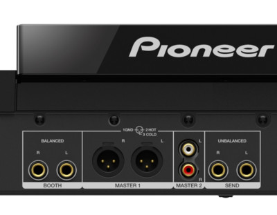

Originally the splitters would connect directly into the XLR Master Out of the Pioneer XDJ-XZ, XDJ-RX2 or DDJ1000, one XLR lead to the monitor system input (DCX2496/FBQ3102HD/600wx2 Amp), and the second XLR lead to the FOH system (PA2/CVR-D2004). However,Bruce Weldy wrote: ↑Sat Oct 11, 2025 8:19 am Explain exactly what you are using the Y splitters for?
in searching images of the outputs, all 3 mixers have booth outputs and volume control. Using the mixer booth connection would surely be a better way? Nobody needs to go near any of the SP.
And set maximum volume via the input gain on the PA2? (limiters set correctly of course!)
I'm not sure if you've worked with DJs before Bruce, sometimes they can challenging, and there's 38+ performing on these decks over the event! I'm aiming to make the setup as simple as it can be.

You really don't want to split the L and R to go to different places.....your source material is stereo, so you'll only get half in the monitors and half in the FOH....so, difinitely use the extra outputs for the monitors. While I'm typing this, I think I figured out that you were talking about 2 splitters...one L, one R. So, disregard the LR stuff.....unless that's what you were considering.
I'd definitely hard limit the FOH and the monitors. And make it clear that anyone who pushes their mixer into the red will be shut down - right then. No reason to let someone hijack your system and blow up drivers. Not to mention, it sounds like crap when driven to distortion.
