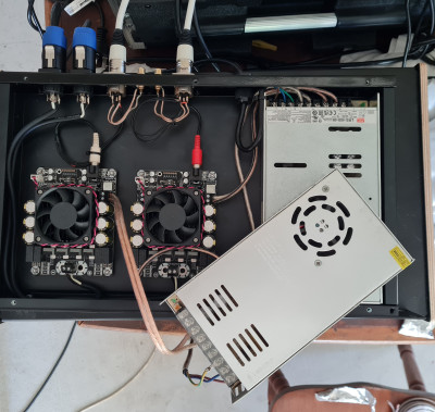

G'day gents,
An amp l threw together has always had a slight noise once both inputs are connected to the DSP, it sounds like a mosquito. With one input plugged in, its silent, with both, that's when you can hear it. Used with the DR280s, the noise is just noticeable, however l plugged SLAPs in yesterday and the noise is very noticeable.
After trying to diagnose, (insulating leads, lifting grounds, changing power points, leads, amp, ect) l found using a second power source eliminated the noise.
I'm aiming to use the SLAPs as DJ monitors in four weeks, and when you're that close, the noise is annoying! Apart from running a second external power source, is there something which l can try? I'm hoping a magical resistor in the right place does it!

It could be a ground problem. When there's more than one path to ground on the inputs a ground loop can cause noise. Since the amps appear to be chassis grounded via the power supply the input wires should not be grounded at both ends of the input wires.

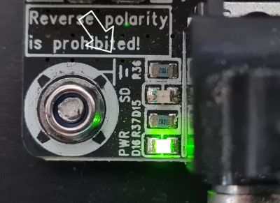

Right.. l removed the amp mounting screws which had the ground symbol
And lifted the ground on the power supply, which cut the noise in half, sweet!

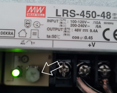

It was still annoying me though, so l reconnected the grounds and checked the voltage out of the power supply, it was 47.8v which is surely acceptable..
Not being able to leave things alone, l tweaked the plastic voltage adjustment screw
The noise lowered it's pitch all the way to zero as it approached 48.0v :shock: , then a hiss developed on the way to 49v. So at 48.5v, there's a totally acceptable, quiet and normal amplifier noise :D

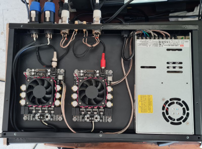

Bill Fitzmaurice wrote: Sun Oct 05, 2025 6:24 am When there's more than one path to ground on the inputs a ground loop can cause noise. Since the amps appear to be chassis grounded via the power supply the input wires should not be grounded at both ends of the input wires.
Bill, would this apply to an amp with balanced input signals? Because l have another DIY amp with a similar problem, and it has balanced inputs, the first amp pictured is unbalanced.

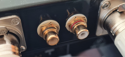

Bill, are you saying that the input negative wires inside the amp case should be on pin 3 rather than pin 1? And, that the RCA terminals should be isolated from the case?

Tom Smit wrote: Sun Oct 05, 2025 10:05 pm And, that the RCA terminals should be isolated from the case?
Luckily these sockets have insulating washers

What you want is only one connection from the amp signal inputs to the chassis ground. If one is present via the power connection don't add another via the input wires. This only applies to unbalanced inputs, not balanced.

Moving on to amp no.2... the first thing done was removing the mounting post screw, which indicated the earth from 1 amp module :fingers:
And the noise is GONE! Just the normal, very slight and acceptable buzz remains.
