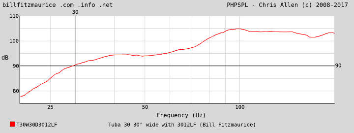

30Hz outdoors is doable with one T30/T45 (although one cab is technically supposed to be high-passed at 35Hz, it's rhetorical) if you're standing right next to it and you're in a setting without a lot of ambient noise pollution. But, to get USABLE and impactful 30hz outdoors for anything more than an undersized suburban backyard get-together, you're looking for 8-16 T30/T45's.
Here's the first reason why it will take so many, Equal Loudness Contours. In a nutshell, the lower the frequency, the less sensitive your ears are to hearing. For 30Hz to "sound" as loud as 60Hz, it needs to actually measure an SPL of at least 10dB higher. Once properly EQ'd, 30Hz will probably measure about 20dB hotter than the frequencies produced by the mains/tops to sound the way you'd expect it to sound in your ears.
The second reason, which kinda compounds the first reason is; for all sub cabinet designs that I'm aware of, the sensitivity is lowest at the bottom end of it's usable frequency range.

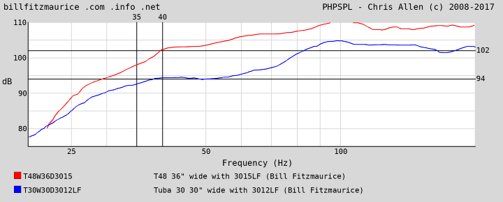

Looking at the response of the 30" wide T30 (BTW, always build cabs to their max width unless it would make them impossible to deploy, transport, or stow within your specific set of circumstances and requirements)... anyway, looking at the chart this cab has a sensitivity at 30Hz of 90dB, measured at one Meter with an input of 2.83 volts (one watt, based on the 8Ω nominal impedance of the driver).
Every doubling of distance comes with a 6dB drop in SPL.
Every doubling of cab count comes with an increase of 6dB SPL.
Every doubling of watts is an increase of 3dB SPL.

Let's say you're standing 8 Meters (about 26 feet) in front of your speakers and the SPL of your mains/tops is a reasonable 100dB. Let's calculate what it would take for the bottom end to reach a level that properly represents and faithfully reproduces the desired response curve. So we're looking for 120dB at 30hz, at 8 Meters/26 feet.
First, I'm going to add the gain from applying the maximum allowed input voltage of 45 volts. I'm not going to go into the math, but the difference between 2.83 and 45 volts is 24dB. Adding that to the cab's 30Hz sensitivity of 90dB gives us the maximum 30Hz SPL one cab is capable of producing if measured 1 Meter from the mouth of the sub, 114dB.
Now let's adjust for our listening position, -6dB for every doubling of distance. We're 114 at 1 Meter, 108dB at 2 meters, 102dB at 4 Meters, and finally 96dB at our 8 Meter/26 foot listening position.
Need 120dB and we're at 96dB, short 24dB of where we want to be. So let's double the cab count until we get there, +6dB for every doubling of cab count. 1 cab 96dB, 2 cabs 102dB, 4 cabs 108dB, 8 cabs 114dB... Still not there. For simplicity I'm ignoring some of the benefits that occur with larger stacks, but 16 cabs to get 120dB at 30Hz at a distance of only 26 feet. And they're full out on 4000 watts combined power. Wide open, on the limiter, giv'n 'er all she's got captain!
The same goes for any other speaker design. Don't be fooled by marketing hype. Use the response curve for any cab and run the numbers like I did here and you'll see, it just takes a butt load of cabs to hit 30Hz outdoors.

Now, if we adjust the bottom frequency expectation to 35 or 40Hz and run the numbers on a 36" wide T48... where 35-40Hz will only need to be 12-15dB hotter than the mains to have a nice balanced sound with a full bottom end.
Adding the 26.5dB increase in output based on the 60 volt limit for the cab brings the maximum output at 40Hz measured at 1 Meter from 102dB to 128.5.
Adjust for our listening position, -6dB for every doubling of distance, brings us to 110.5dB.
Need 112dB and we're at 110.5dB, short only 1.5dB of where we want to be. So let's double the cab count until we get there, +6dB for every doubling of cab count. Well, 2 cab's put's us at 116.5 meaning we've met our goal and are now able to run this volume with 4.5dB of headroom, plunking away on only 315 watts.
Four, full 36" width T48's can be high passed at 35Hz, which means they'll play 30 and below, just slightly attenuated... And it would take a butt load of T30/T45's to even start to keep up, indoors or out. I highly doubt four full width T48's will leave you in need or want of anything different. I think the PRV driver is the latest hot ticket for those and they're affordable.

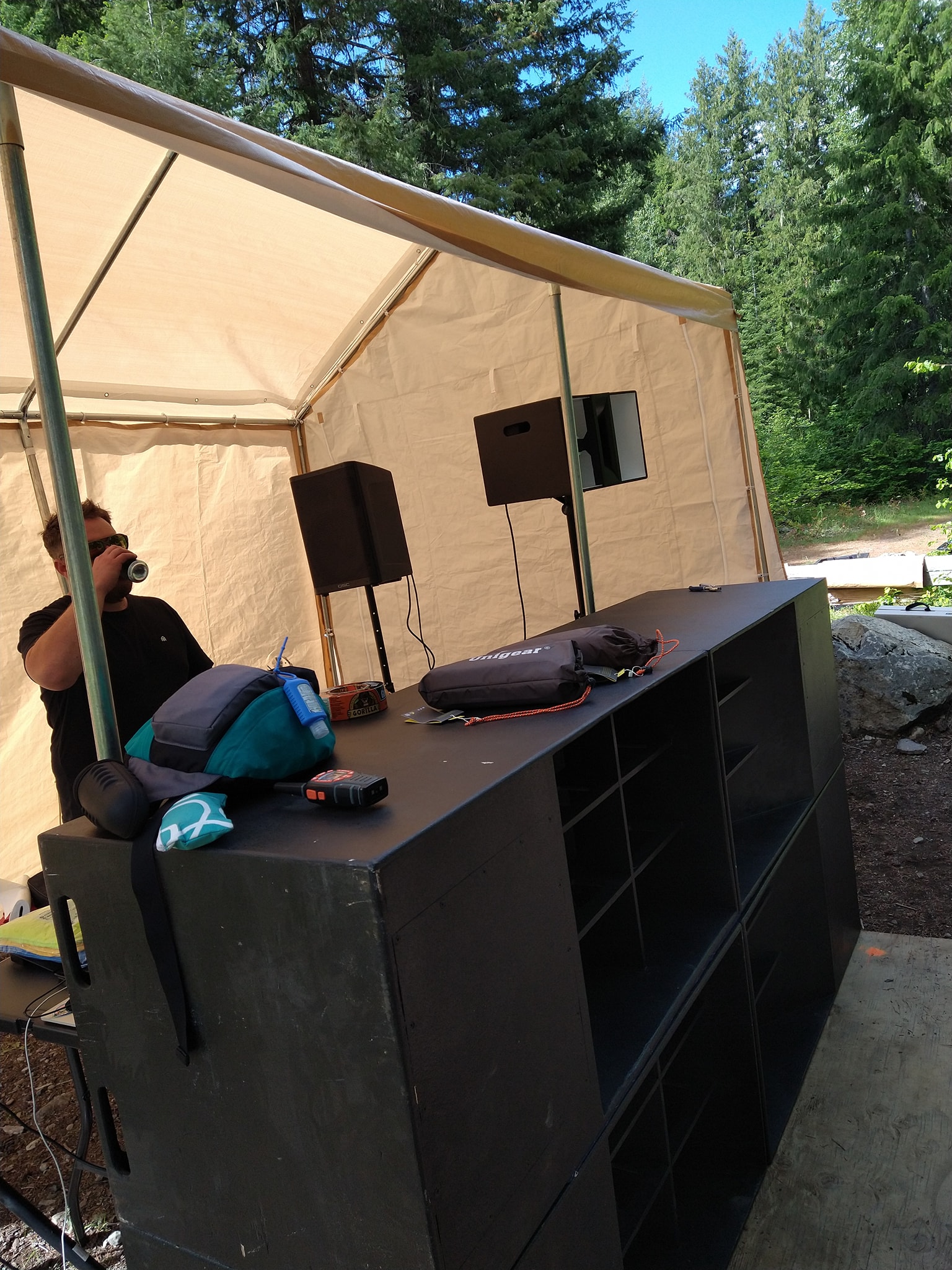

Some T48 review quotes over the years...
Wylandright206 wrote: ↑Tue Jul 21, 2020 3:39 am Myself and armchair pirate worked a renegade festival this weekend and we brought two of our t48s out, and I'll say, that was nothing short of a treat. I cant imagine why a majority of society would ever have a need for more than 2. These things make f1s f221 sound like small dice.We had people dancing 2 miles up the river follow the sound, and eventually find us to join the party. I never felt like i was anywhere near topping out at any point. But the ground in front of the horns was basically hovering at the kick. I dont know what you did bill but you did the shit out of it and I'm happy to rep your brand here in seattle. I wish leland still had those BFM name badges I would buy 8. Basically every attendee and musician was consistently absolutely floored by the sound being produced by your designs. I'm convinced anyone who doesnt enjoy the sound of these is either a paid shill or completely deaf.
Wylandright206 wrote: ↑Tue Sep 21, 2021 1:09 am ...I think it's worth noting that the extension provided by 4 t48s is more than enough to deal with the vast majority of bass music. Even that wonky leftfield stuff. If you really need more than 35hz there are ways you can go lower but it involves setting lower voltage limits and sacrificing total output. Best to just leave it at 35hz. I work with bass music pretty frequently, almost as much as house music, and I've never once thought they were missing anything. The flexibility offered by the t48 makes them ideal in my eyes. If you are doing heavy bass I would recommend atleast 4 subs. But for content like drum n bass, breaks, trap, and whatnot 2 titans run down to 40hz is deeply satisfying.
As you could imagine the forest party in the photo was bonkers. These horns start doing some funky shit with 4 or more. I think that weekend was the moment I realized those horns are absolutely fit for bass music in a pile.
