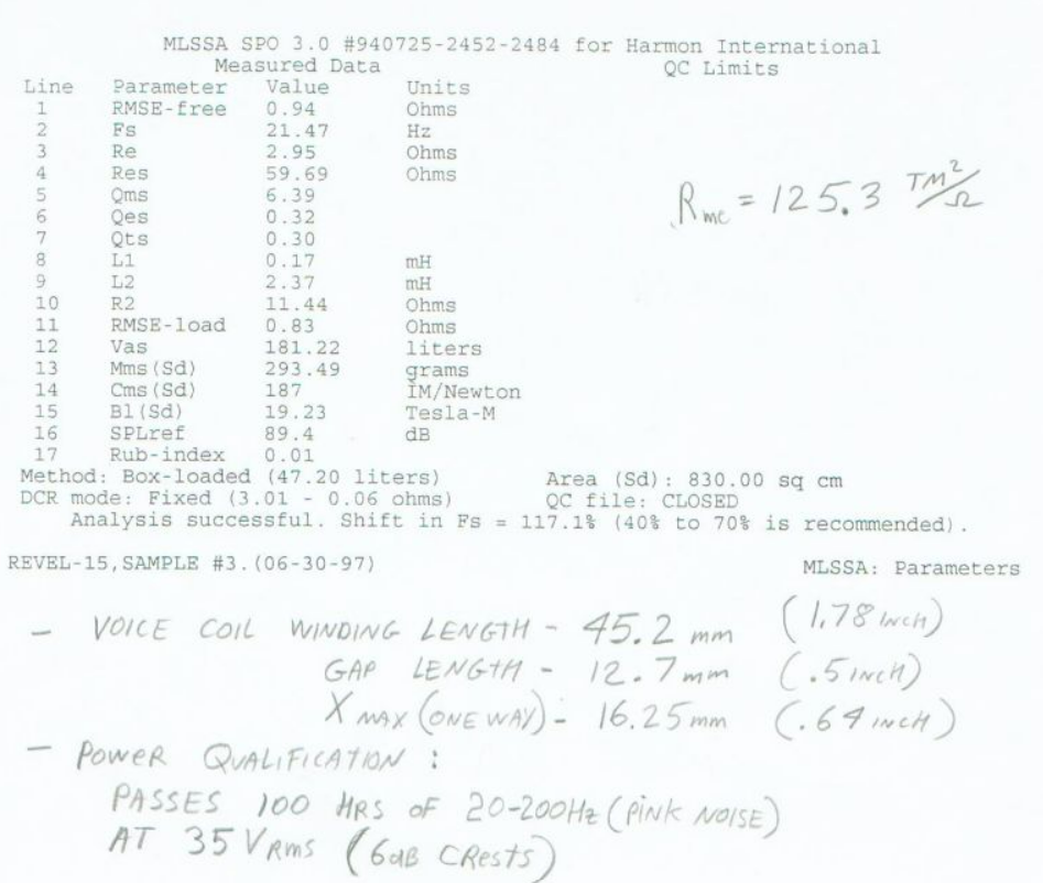

Hi all, new on this forum. Autumn is coming and time to build some speakers.
Trying to keep cost down I would like to use a pair of 15" drivers I already own. Its a pair of JBL SUB1500 and they have the parameters seen in the attachement. The FS, VAS, Xmax etc seem to be fit the bill. What do you think? Is there a way to model how a driver will perform in at THTLP with a certain width?
