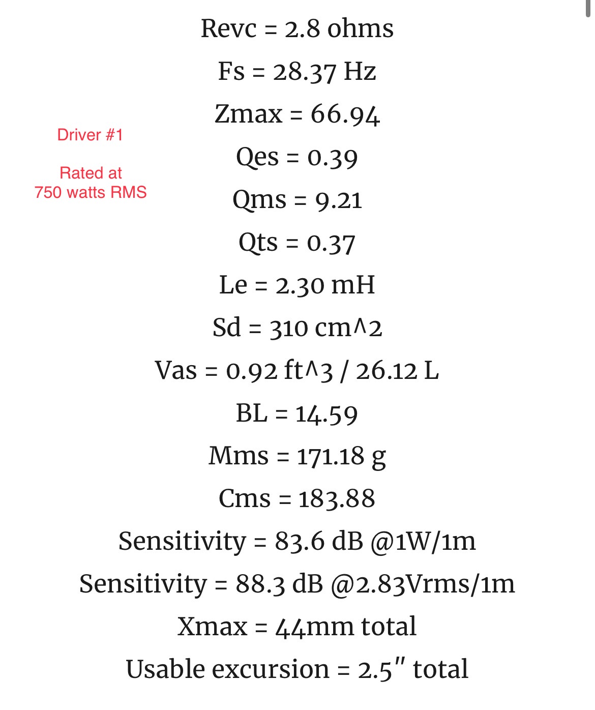

I can build a ‘decent’ width 2x8 cab or a ‘weak’ width 2x10 cab. That being said, while looking at the drivers in the plans, and doing some calculations for different specs, I came across a 10” driver that looks pretty well in spec, that makes me lean to a 1x10 cab, as seen here:
Revc = 2.8 ohms
Fs = 28.37 Hz
Zmax = 66.94
Qes = 0.39
Qms = 9.21
Qts = 0.37
Le = 2.30 mH
Sd = 310 cm^2
Vas = 0.92 ft^3 / 26.12 L
BL = 14.59
Mms = 171.18 g
Cms = 183.88
Sensitivity = 83.6 dB @1W/1m
Sensitivity = 88.3 dB @2.83Vrms/1m
Xmax = 44mm total
Usable excursion = 2.5″ total
Mounting depth of 5.1”
I would think it’s a realistic 20mm Xmax one way driver, similarly to the recommended MCM 8” driver is more like 10mm Xmax one way, based on it’s magnet height.
The kicker is that 10” driver is rated at 750 watt rms and available in dual 1 or dual 2 coils. I already have a 600 watt rms amp (60 amp fused), so no biggie there.
So smaller cab, benefits of a horn, but ‘uses’ more power
or
Bigger cab, benefits of a horn, less power needed?
Huge difference in performance between the two? My novice guess is it will be a slight advantage to the single 10” cab, mainly dependent on which Xmax figures are used for Vd calculation. Perhaps it’s solid performance and can still save some space too. 😂😂

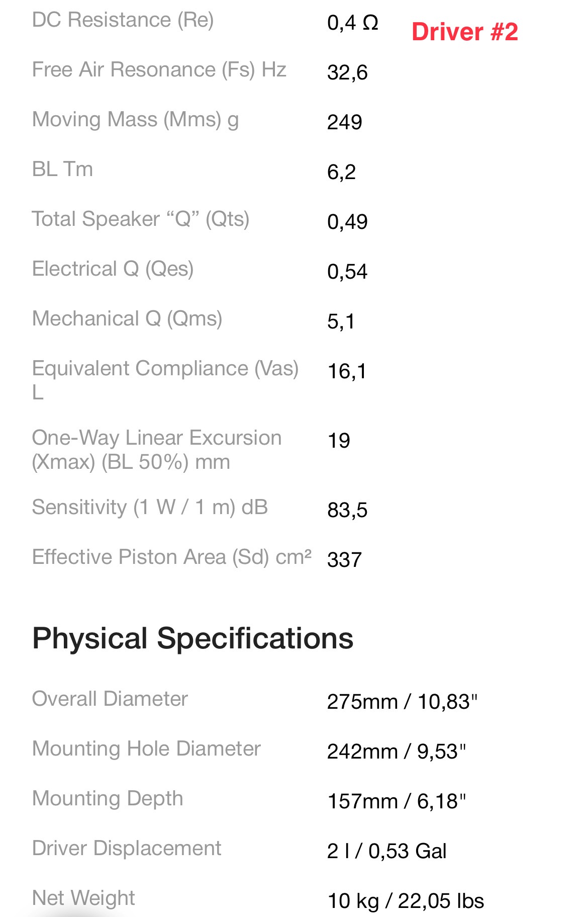

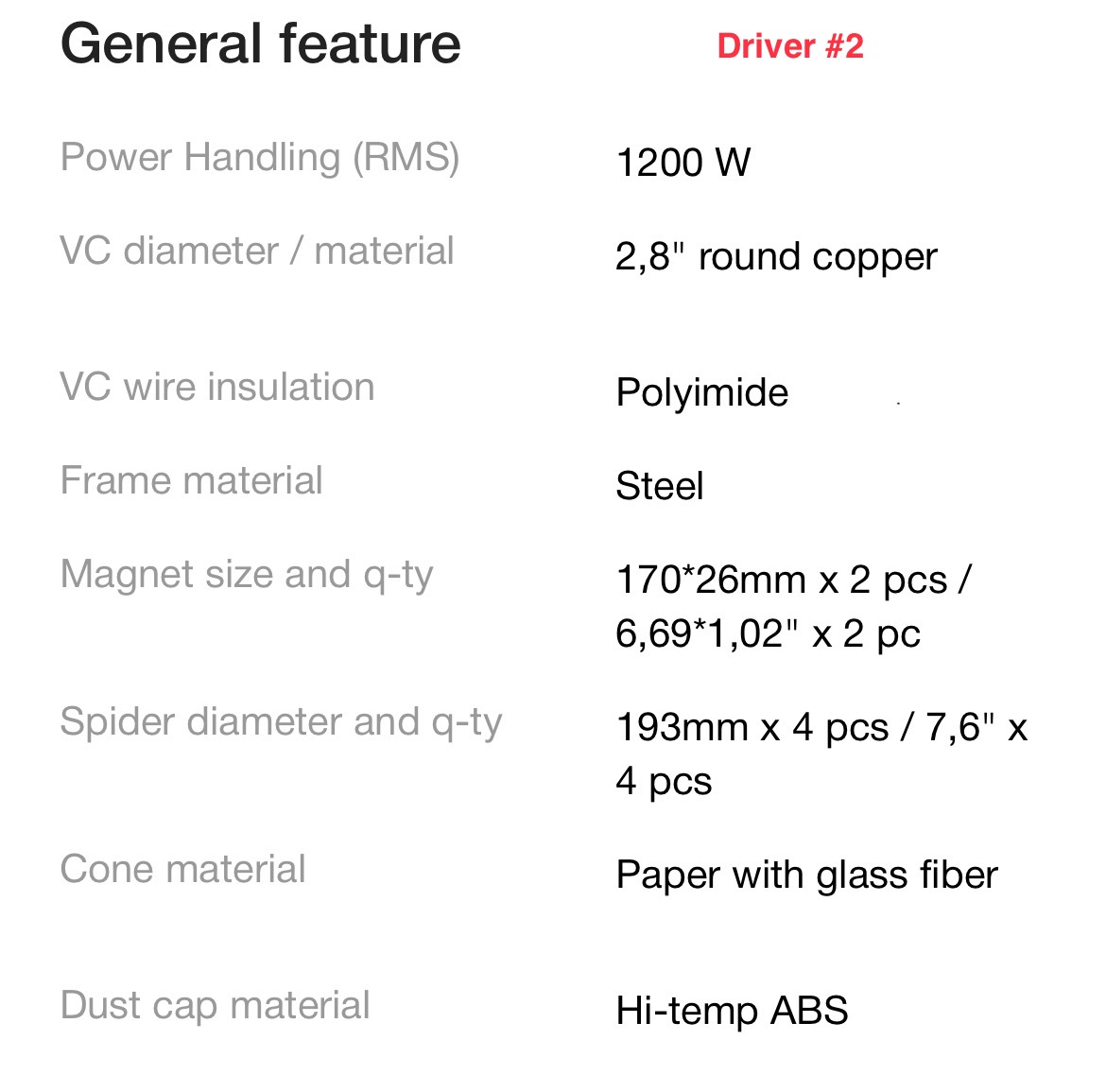

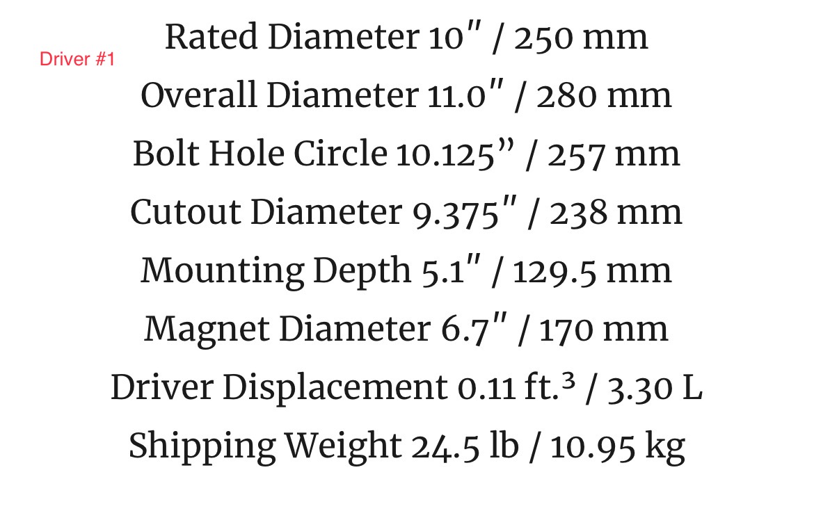

Which of these two 10” drivers would you choose and why if up to you for a Tall Auto Tuba that will be extra braced to handled the extra power. Goal here is best overall high performance. Trying to weed out possible marketing claims etc.
Driver #1 or Driver #2 marked on each slide. Thank you!
Posts: 29051
Re: Auto/truck tuba designs
#27 Post by Bill Fitzmaurice »
Probably neither. Horns don't need monster drivers. That's one reason why we use horns.
Benflitv30
Posts: 36
Joined: Fri May 11, 2018 7:51 am
Location: NE Florida
#28 Post by Benflitv30 »
Bill Fitzmaurice wrote: Thu Jul 11, 2024 5:39 pm Probably neither. Horns don't need monster drivers. That's one reason why we use horns.
I apologize, Bill. It’s the same reason my first cab of your designs that I built was a 36” THT. Just wanted the headroom for the times I ‘wanted’ it, but truth be told..I definitely don’t ‘need’ a THT. Not to mention, I rather just build something once and be done. But once, cry once.
Candidly, trying to extract as much performance out of one TaT as possible. Both of these drivers meet the specs within the plans, but there are variances mainly in Vas and Qts. Curious on the impact those would have if tested side by side. The power ratings I figure are likely inflated.
Btw….These days, the two drivers I listed are rather ‘entry level’ in the car audio world. Amp power is incredibly cheap now, which lead to true monster 100+ lb sub designs with 4” and 5” voice coils being much more common place. I’m not going that route, uninterested. Example nonetheless:

Posts: 29051
#29 Post by Bill Fitzmaurice »
Drivers with huge xmax and Pe are required to get high output at low frequencies from small sealed cabs. That's of value in a car, where you generally don't have room for a large box. Not only is that unnecessary in a horn, it can be counter productive. http://www.readresearch.co.uk/loudspeak ... icle_1.pdf
