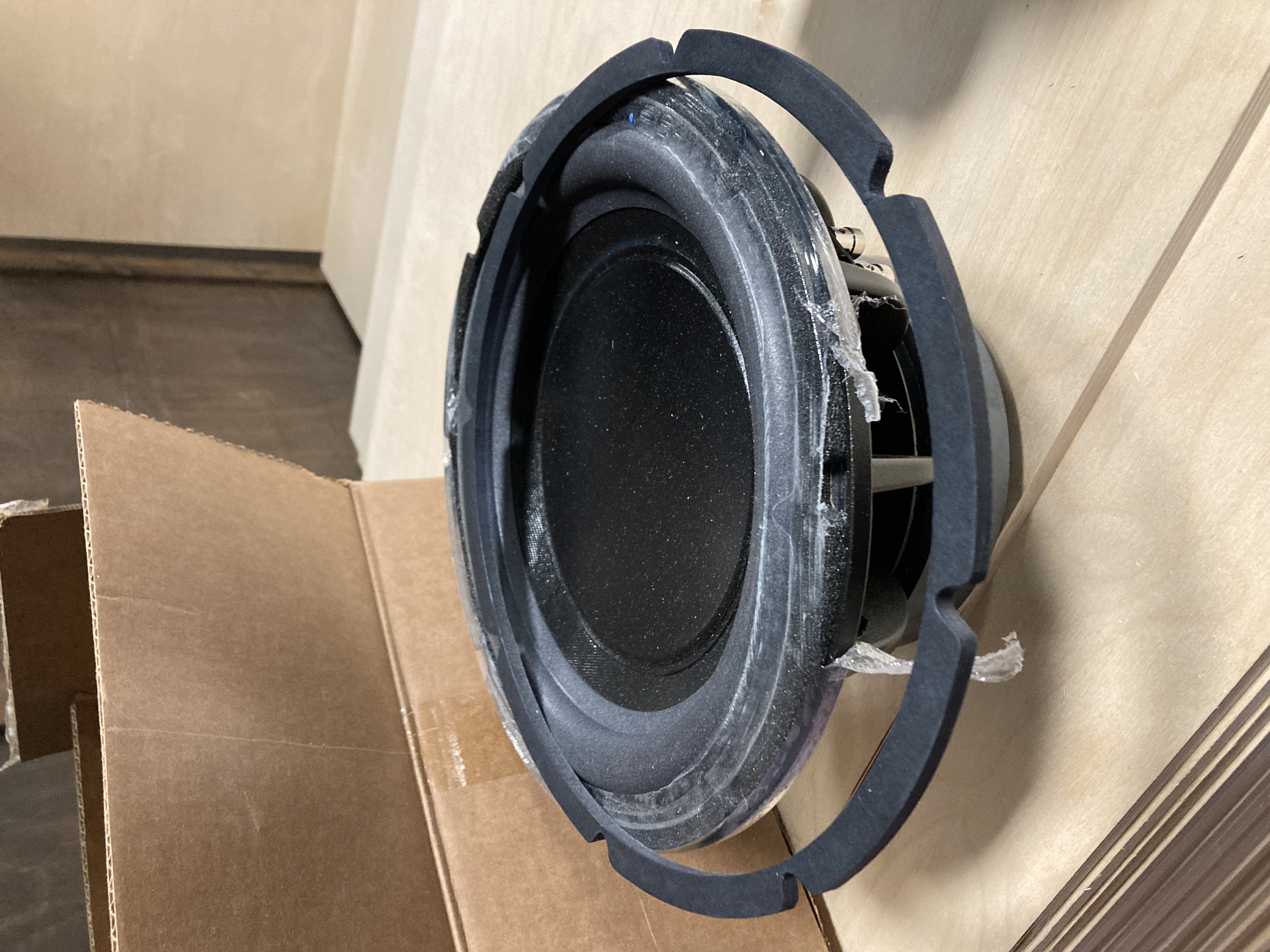

Driver Spacers
Do you guys use them? The hard ones that come with the drivers? Or do you just mount with the driver gasket right against the plywood? It seems like the 1.5" length for driver mounting screws is perfect if I don't use them. But if I do, then I'd need to get 1.75" long.
Also, silicone anywhere as an insurance policy?

Driver Spacer Ring
This is probably a stupid question. I feel like I should ask it, though, before I do anything stupid.
Driver spacer ring. Or at least that's what I think it's called. It comes with the drivers, not attached though. See the photo.
It seems like the LAB12 would be just fine mounting directly to panel 3. With the screws and lock washers, the foam gasket that's already on the driver frame will compress nicely to create an airtight seal. Right?
This would also correlate with using 1.5" mounting screws, because that distance matches up.
However, I am not completely sure of this, because in the T60 plans, page 3, second paragraph:
"The only rule that can't be violated is that every joint must be absolutely airtight. This includes the woofer joint with the spacer, where a potential leak source is gaps in the woofer gasket on the front of the frame. To prevent leaks there fill any gaps with acrylic latex caulk, smoothing the caulk flush to the gasket face with a wet finger."
So do you use the spacer ring? Because it gives a little more room for driver excursion? But you have to be sure to caulk it where it meets the plywood?

I don't have any personal experience with LAB drivers. It appears there's an open cell foam gasket already glued on the cone side of the mounting flange. I wonder if they just put the other one in there to keep the box/packaging from pressing on the surround while the driver is boxed up during storage/transport.
That loose driver gasket is a one piece deal. Some of the driver gaskets are composed of 3 separate pieces, each covering 120º of the circle. I always thought that advice about caulking the gasket meant to caulk where the multi piece gasket ends meet together.
It's difficult to tell in the photo, but if you feel the gasket that's already on the driver flange will be air tight, I'd just go with it. If you feel it won't be air tight, I'd carefully scrape it off with a razor blade and apply standard weather stripping tape with the butting ends cut at a sharp angle.
Maybe one of the other guys here can better speak to the gasketing needs of that specific driver.

Lab12 extra gasket,
I understood it was for when you want to back load the driver if not using it in a horn cabinet.
Keep that gasket though, as it is a perfect template for marking out your driver cutouts on the baffle and mounting points.
