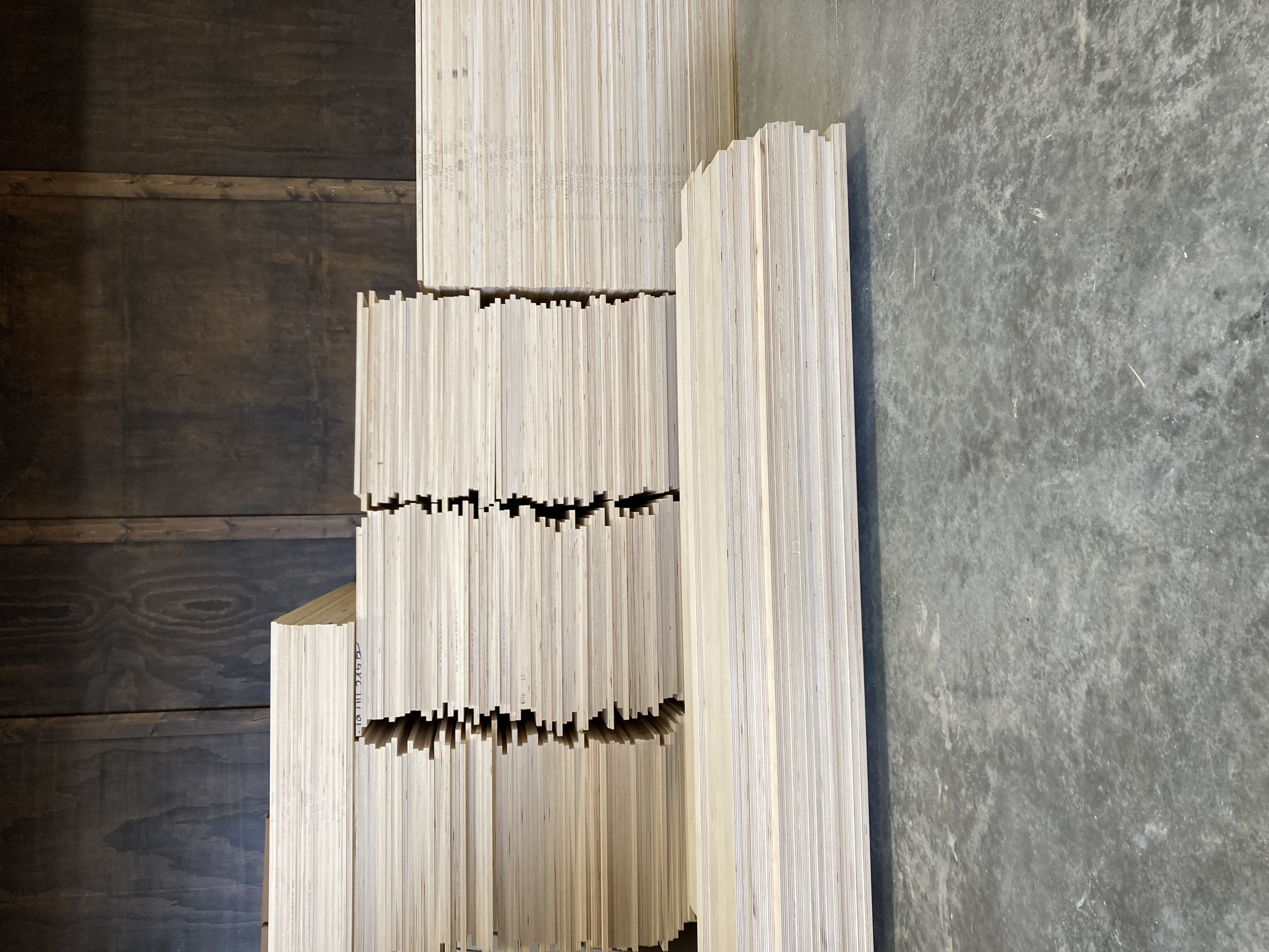

Re: Are 24 x T60-LAB15s Enough? ;)
Oh, and I almost forgot!
Wood porn!
Driver porn!
Enjoy!
Wood porn!
Driver porn!
Enjoy!
