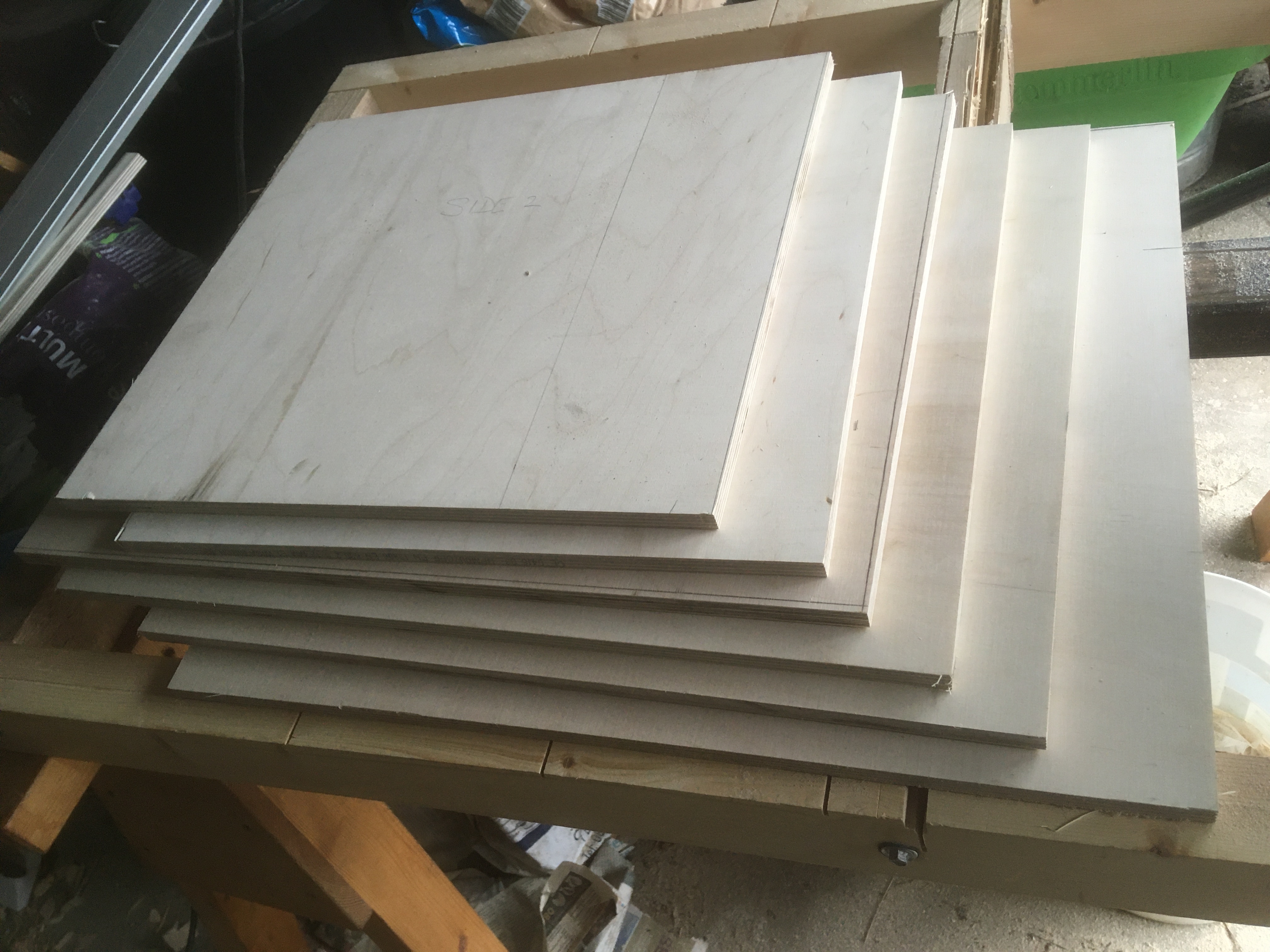

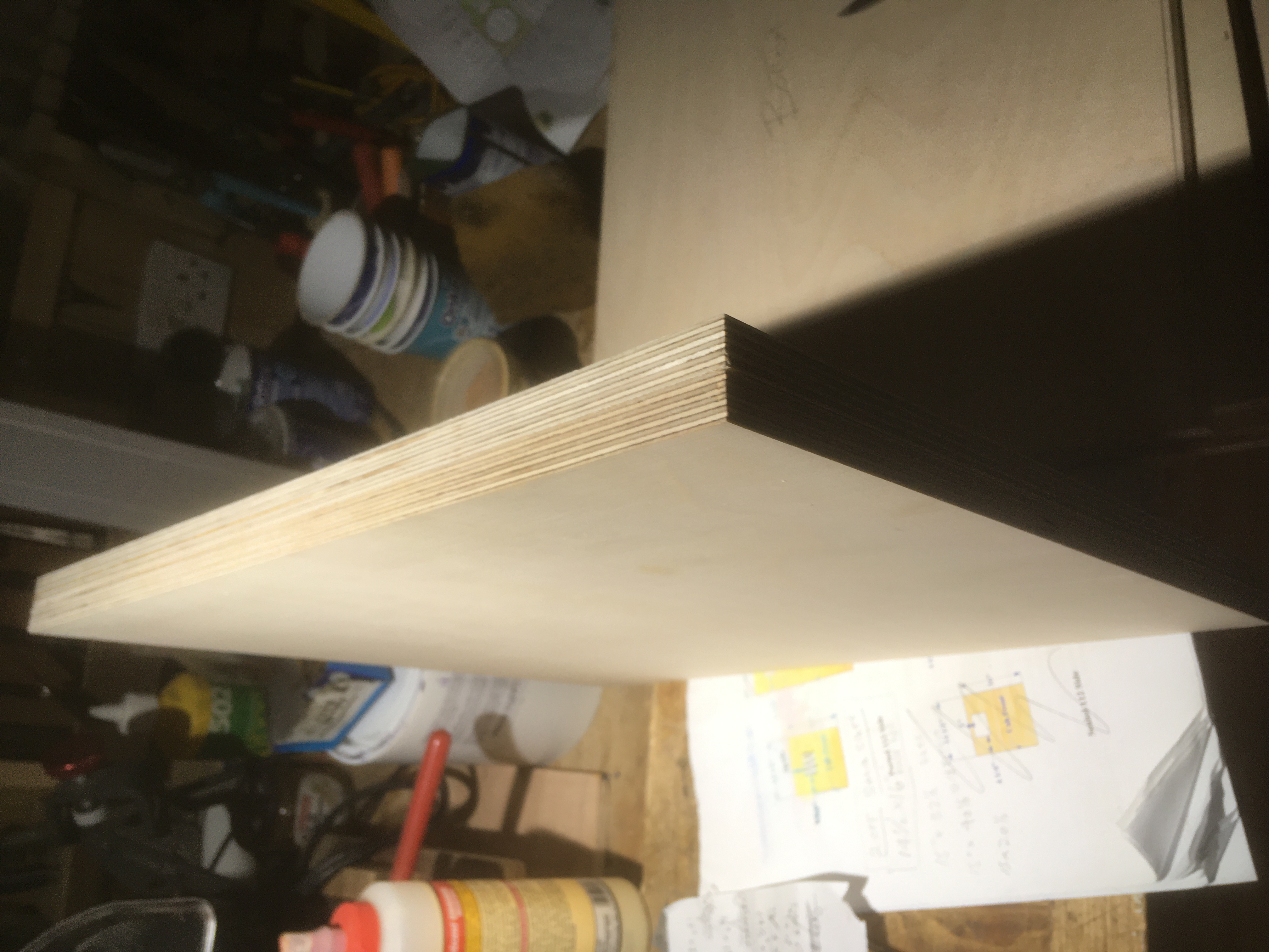

Better plywood (WISA birch) from Fall Timber in North Yorkshire, UK.
Pieces cut oversize before being trimmed to final with router & straight edge
One used as template with flush trim router bit
Perfect edges
Perfect edges

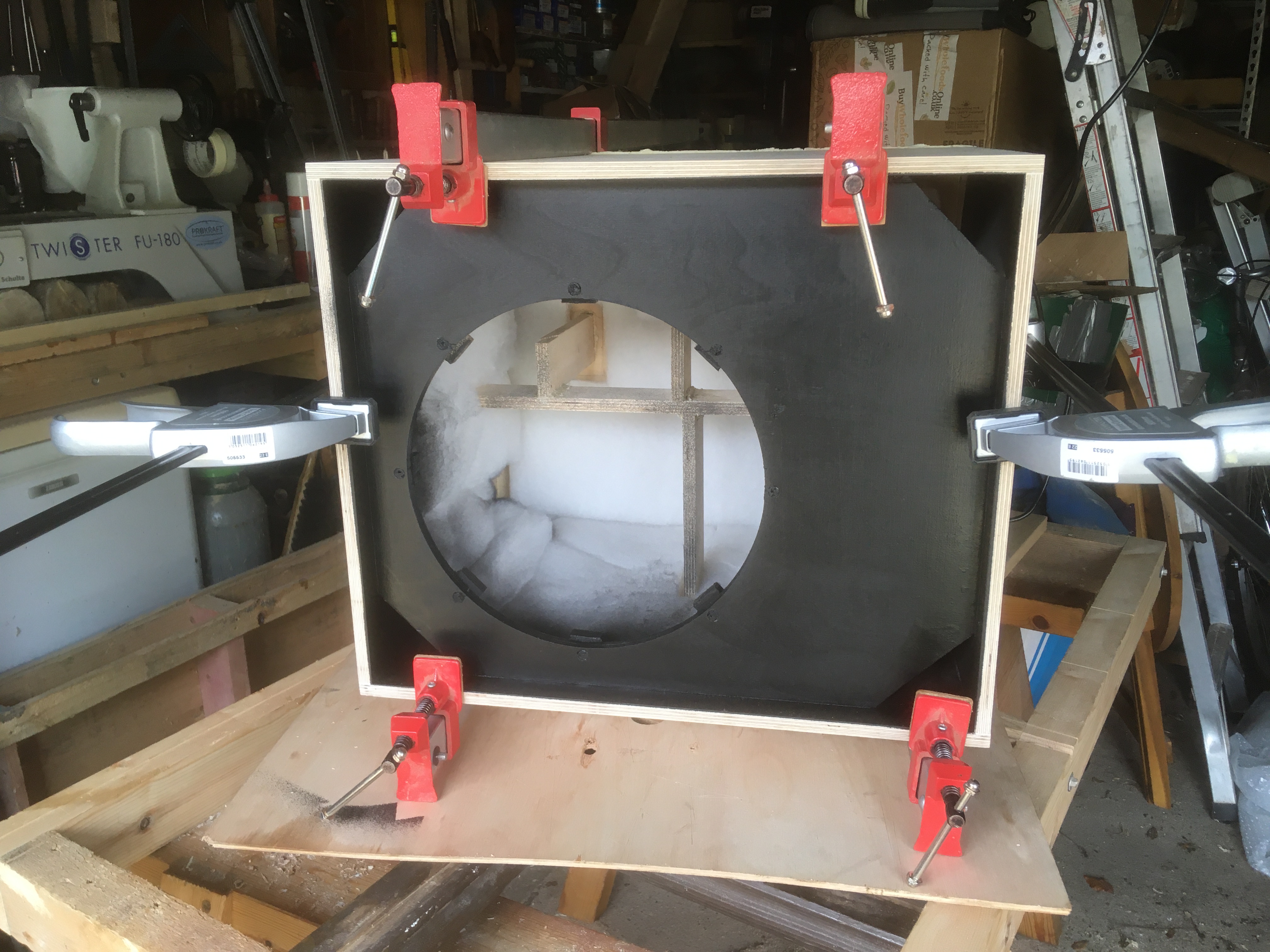

Test dry fit with top & LH side and base & RH side only glued

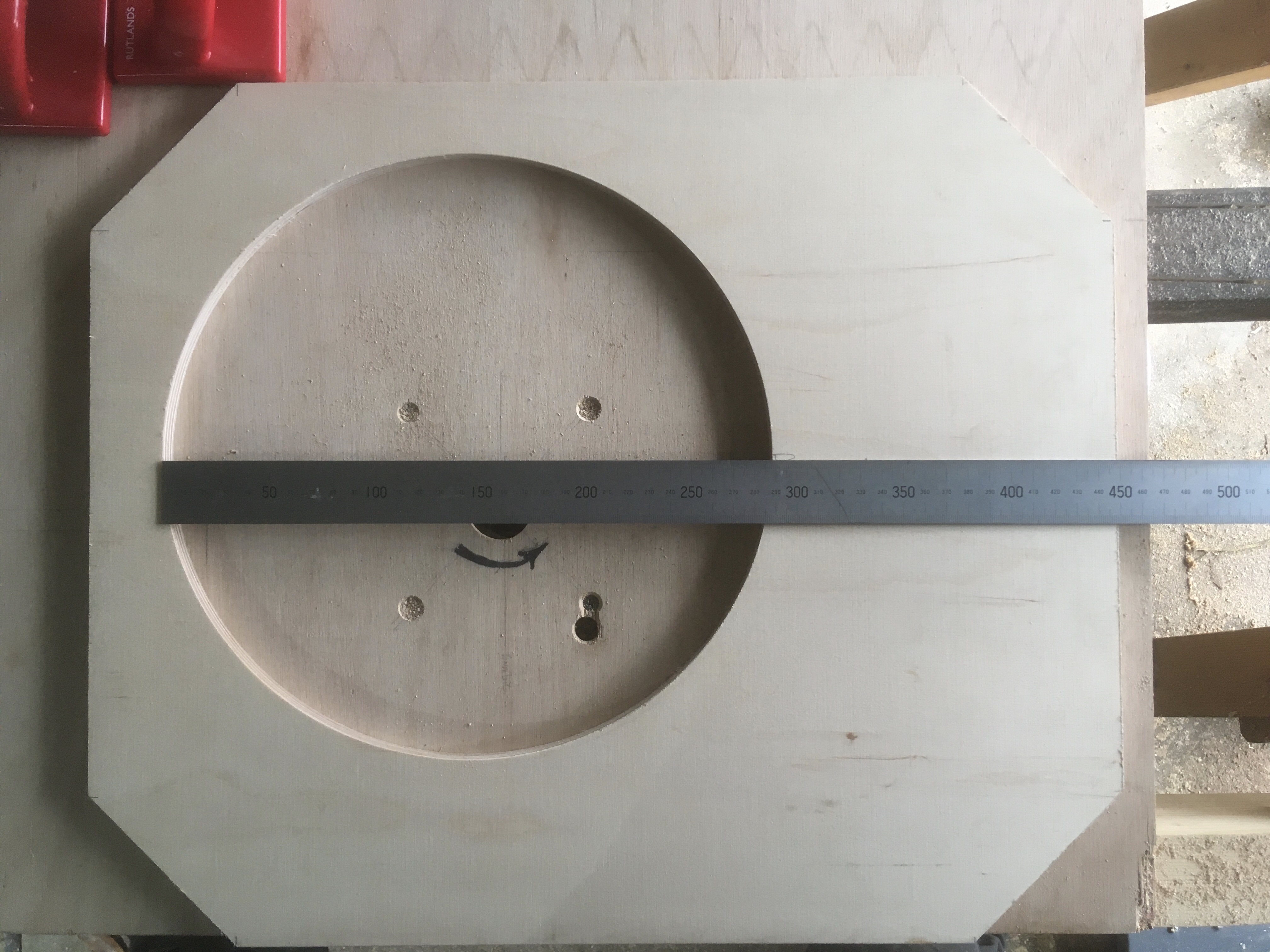

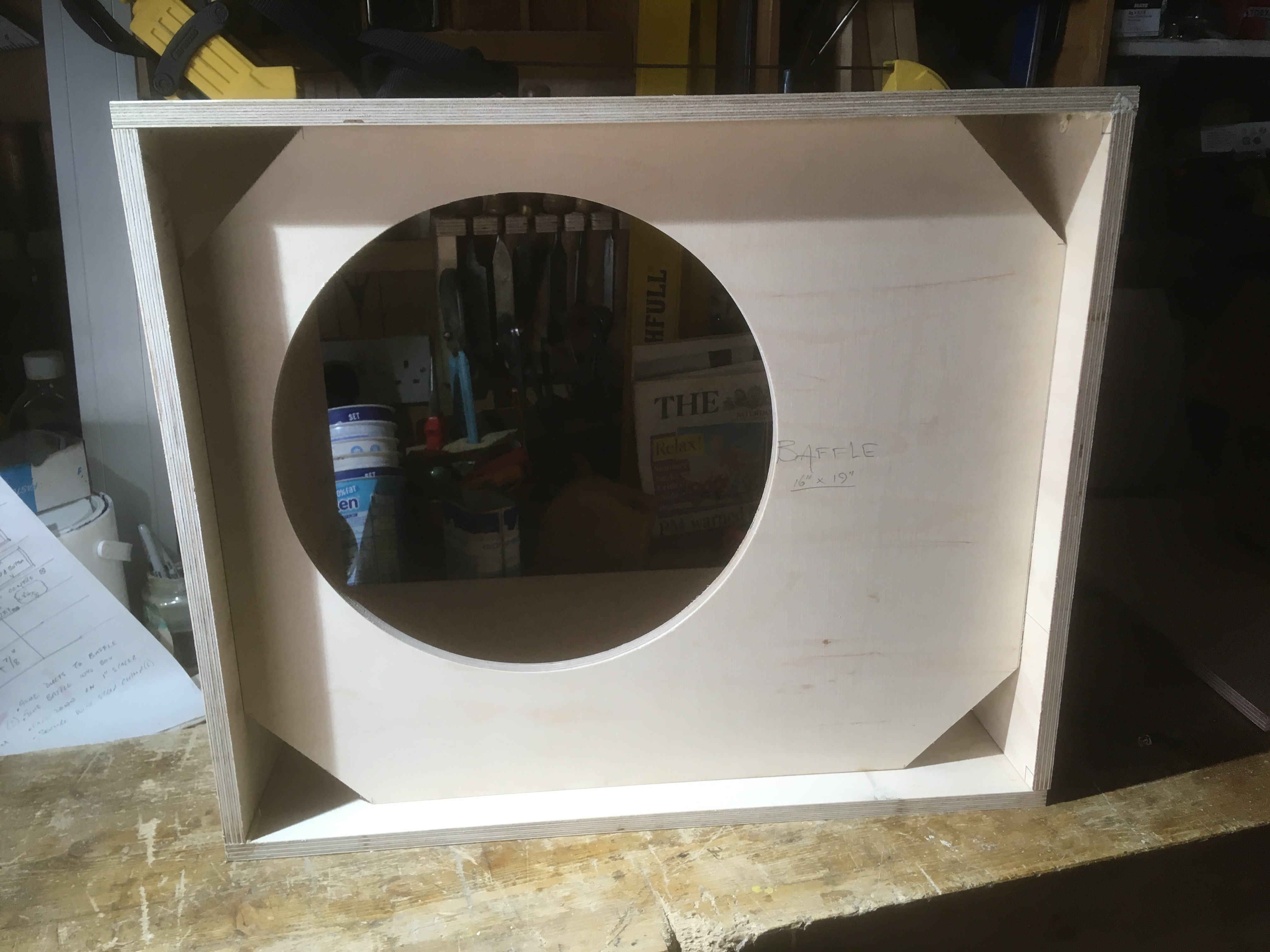

Set up to route out baffle hole
Baffle hole is only 1mm over intended size

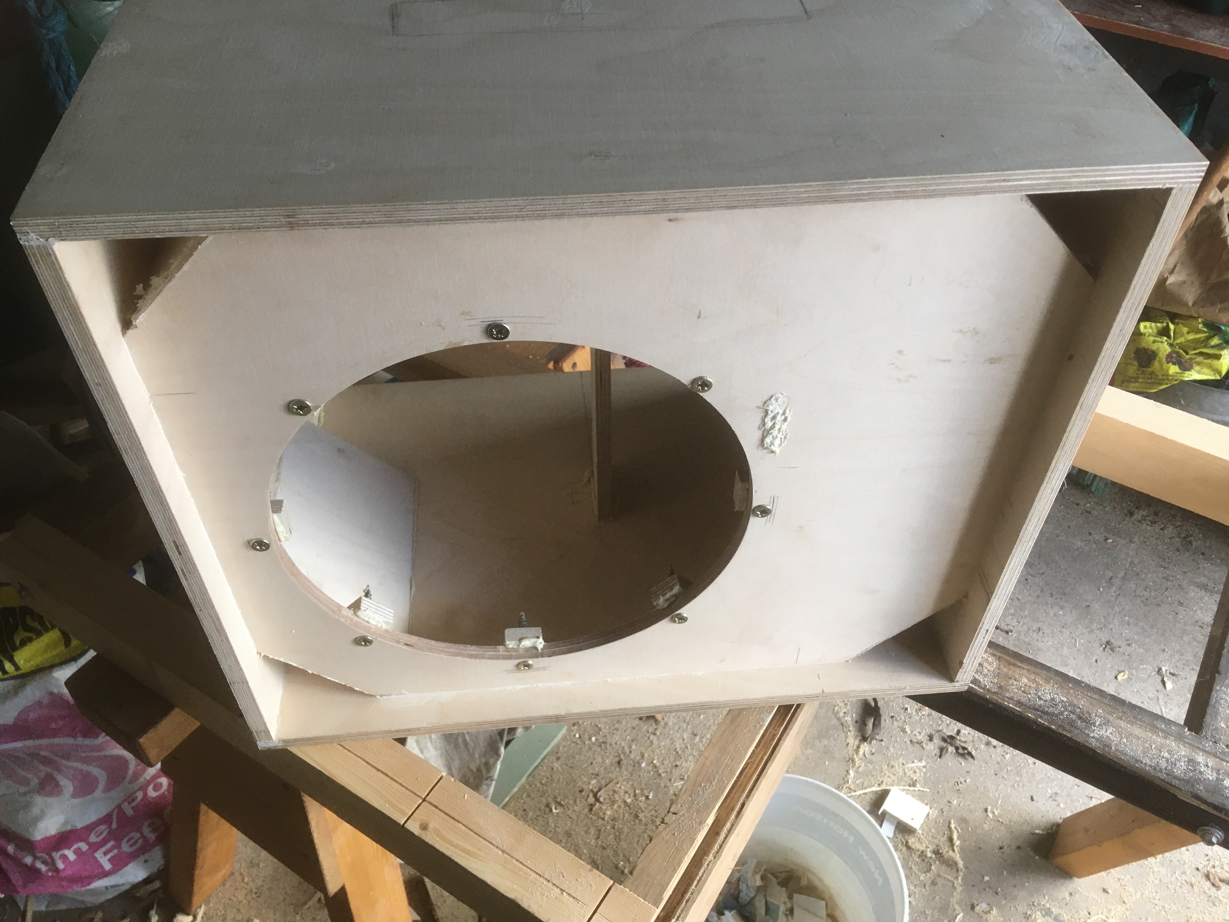

Dry fit clamped around baffle
Square glued joint close-up
Glued cabinet (minus back, ports & braces)

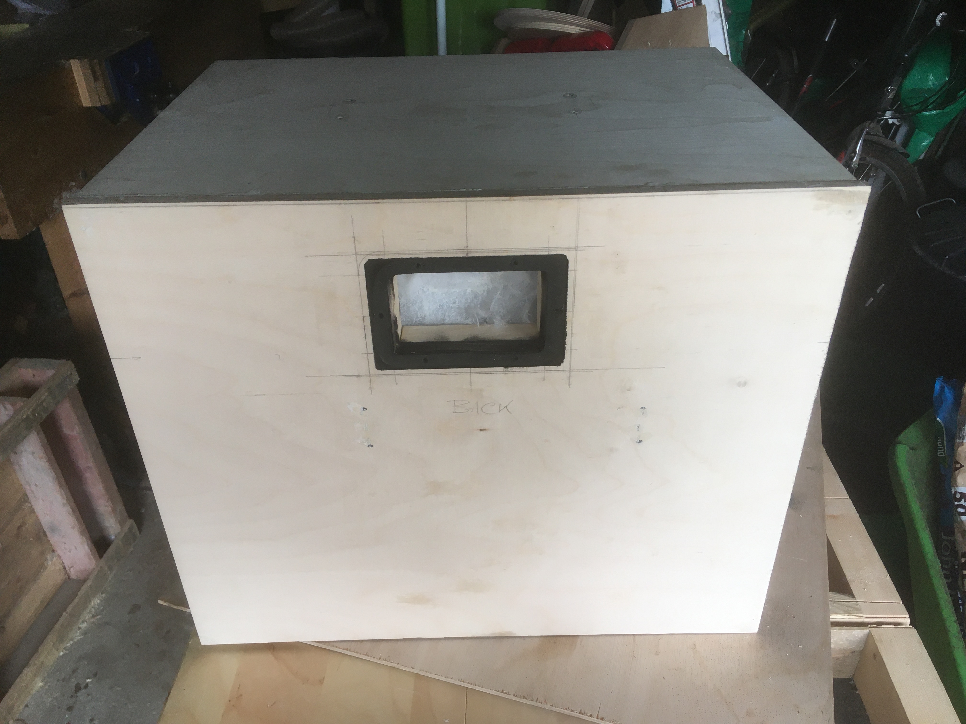

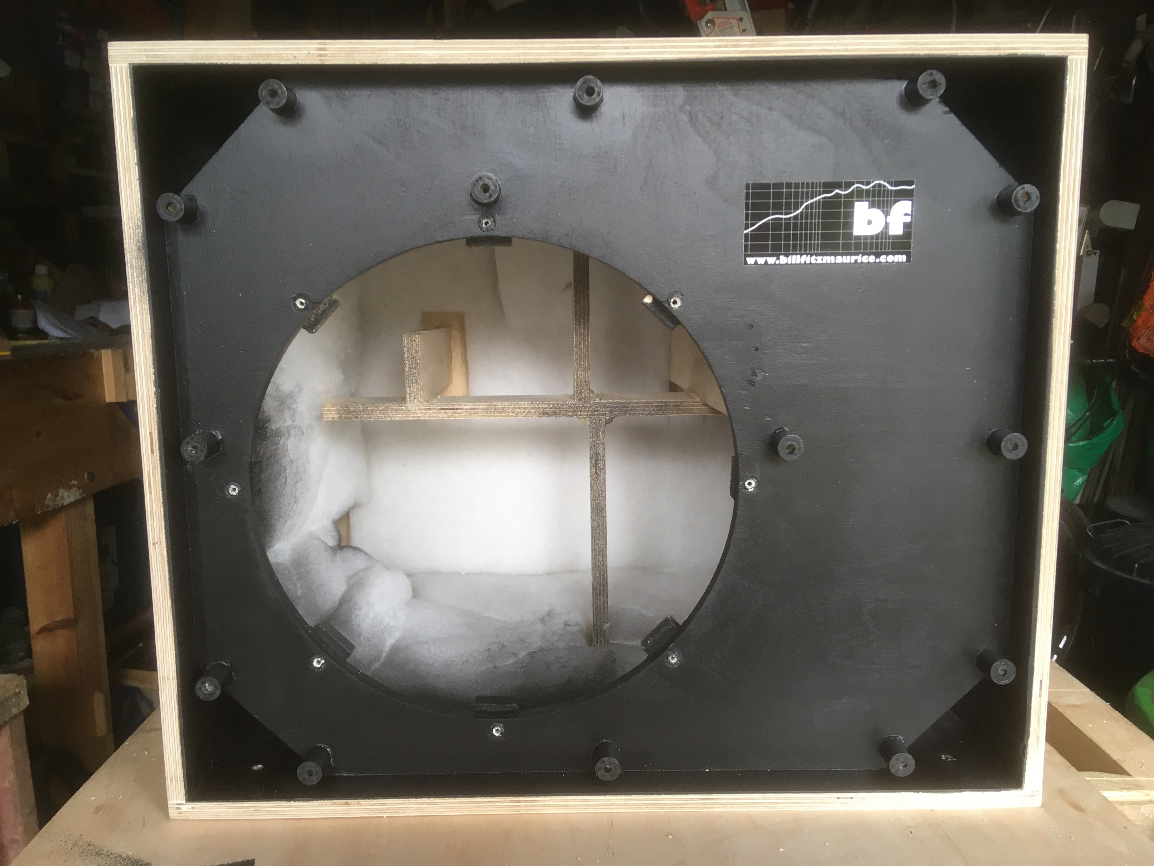

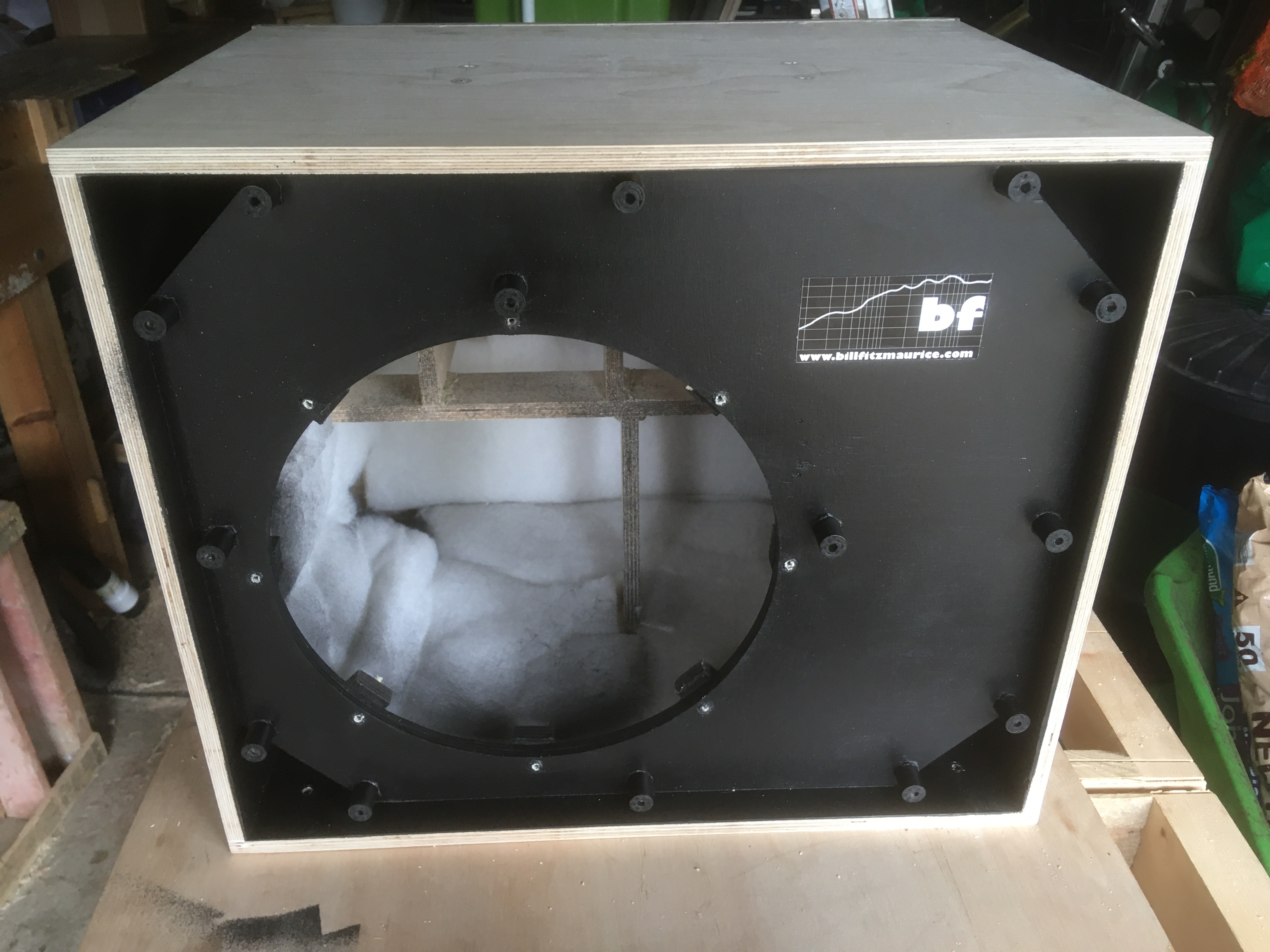

Fitted ports & braces.
Glued nail holes.
Replaced retention blocks for mounting driver with screws instead of bolts.
Cab. With braces, ports & blocks for screws

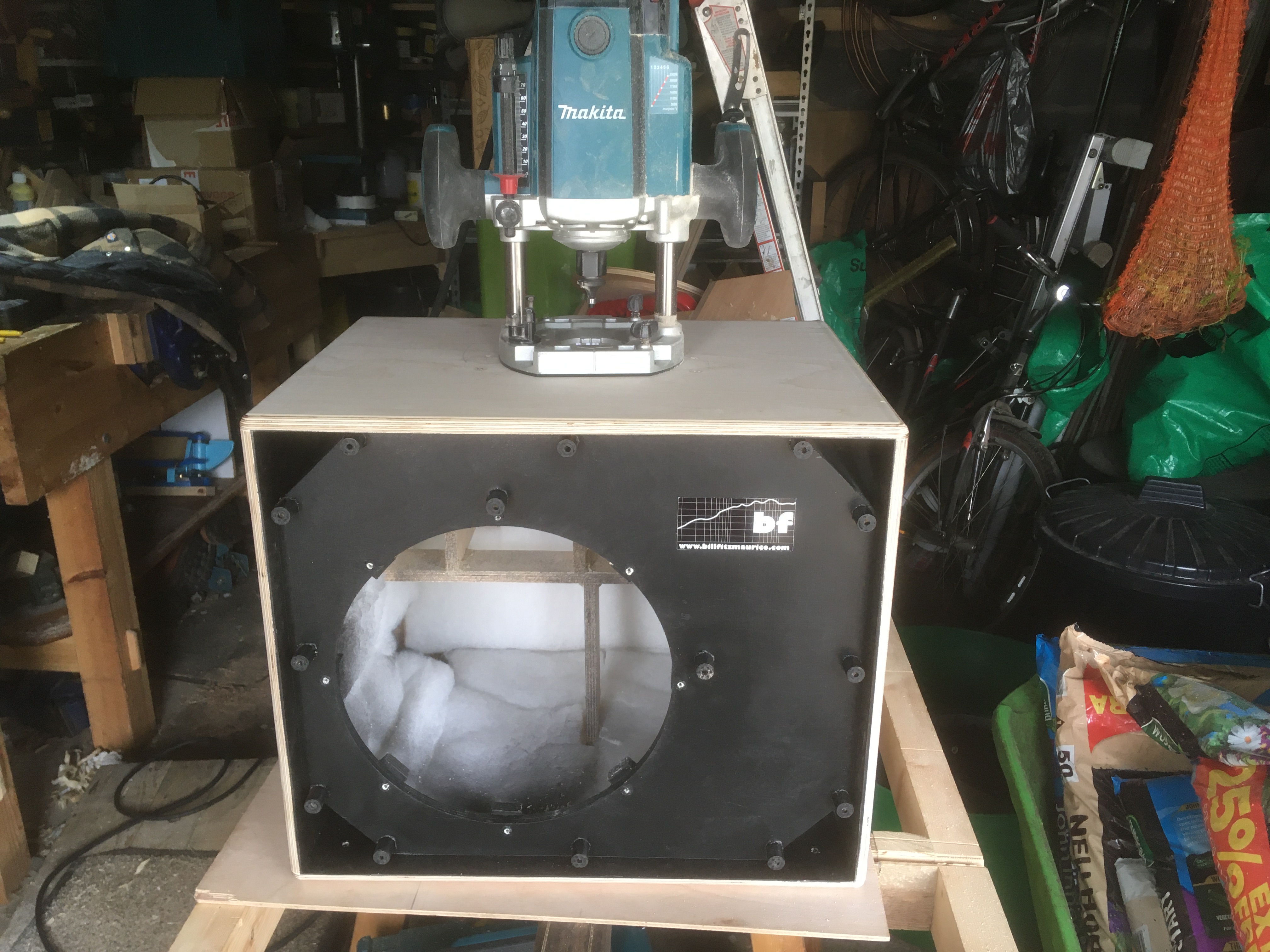

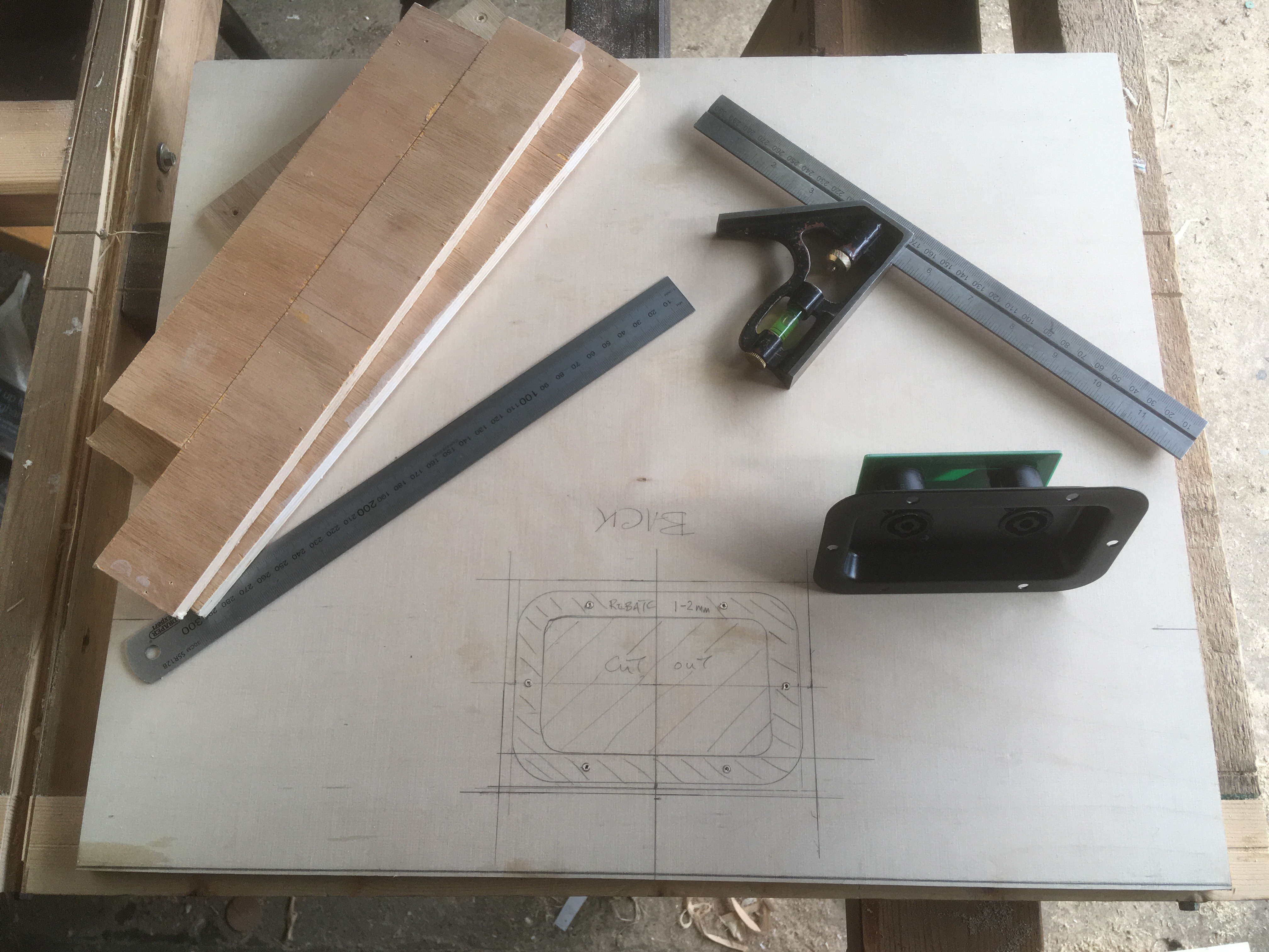

Setting out for routing the hole/rebate for the pre-assembled jack plate (from Blue Aran U.K.) containing 2 x 4-pole speakon connectors.
Preparing to route cabinet back

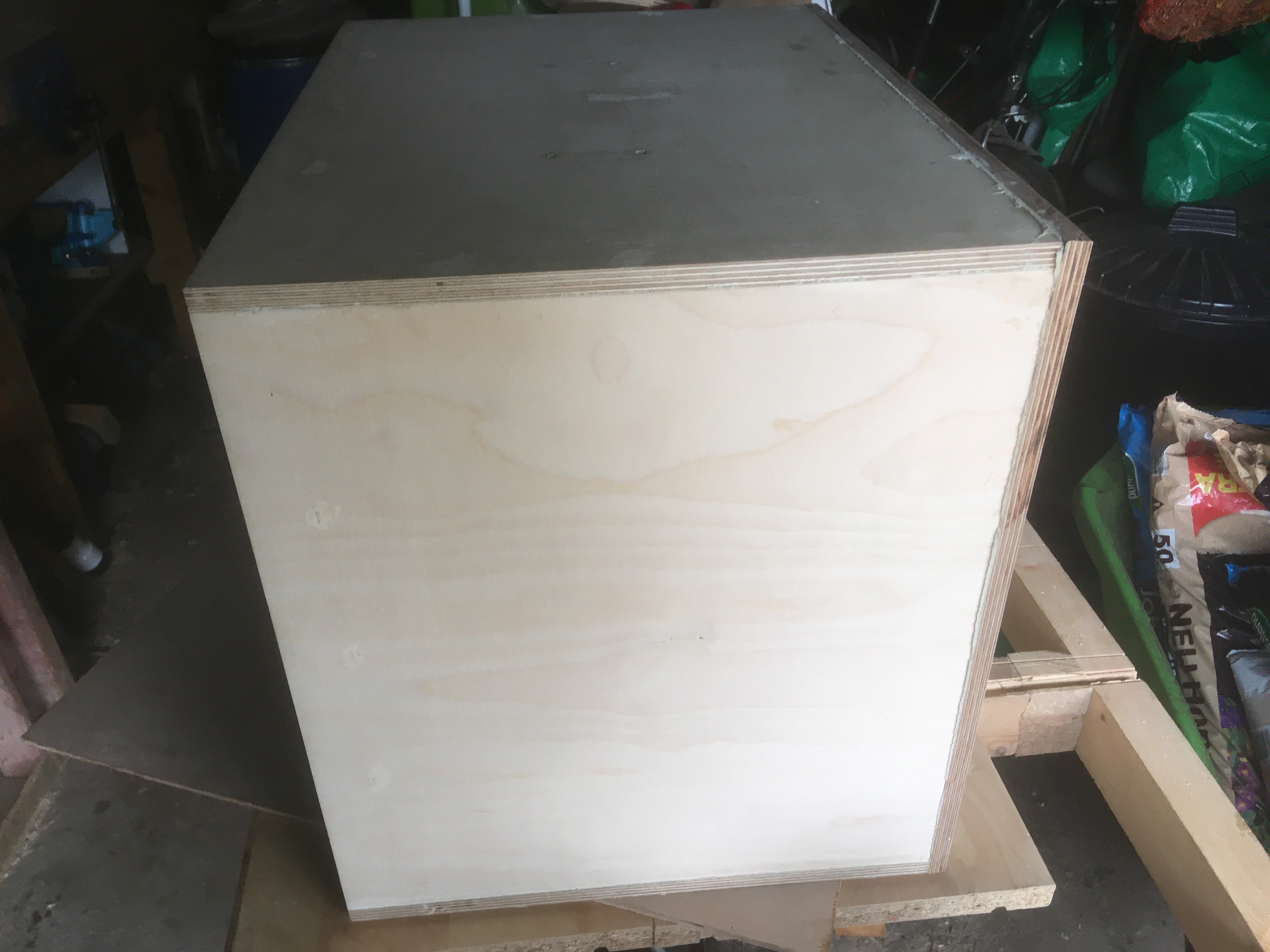

Completion of the second Simplex 12
Glued back to cabinet. Can you have too many clamps?
Back glued and clamped

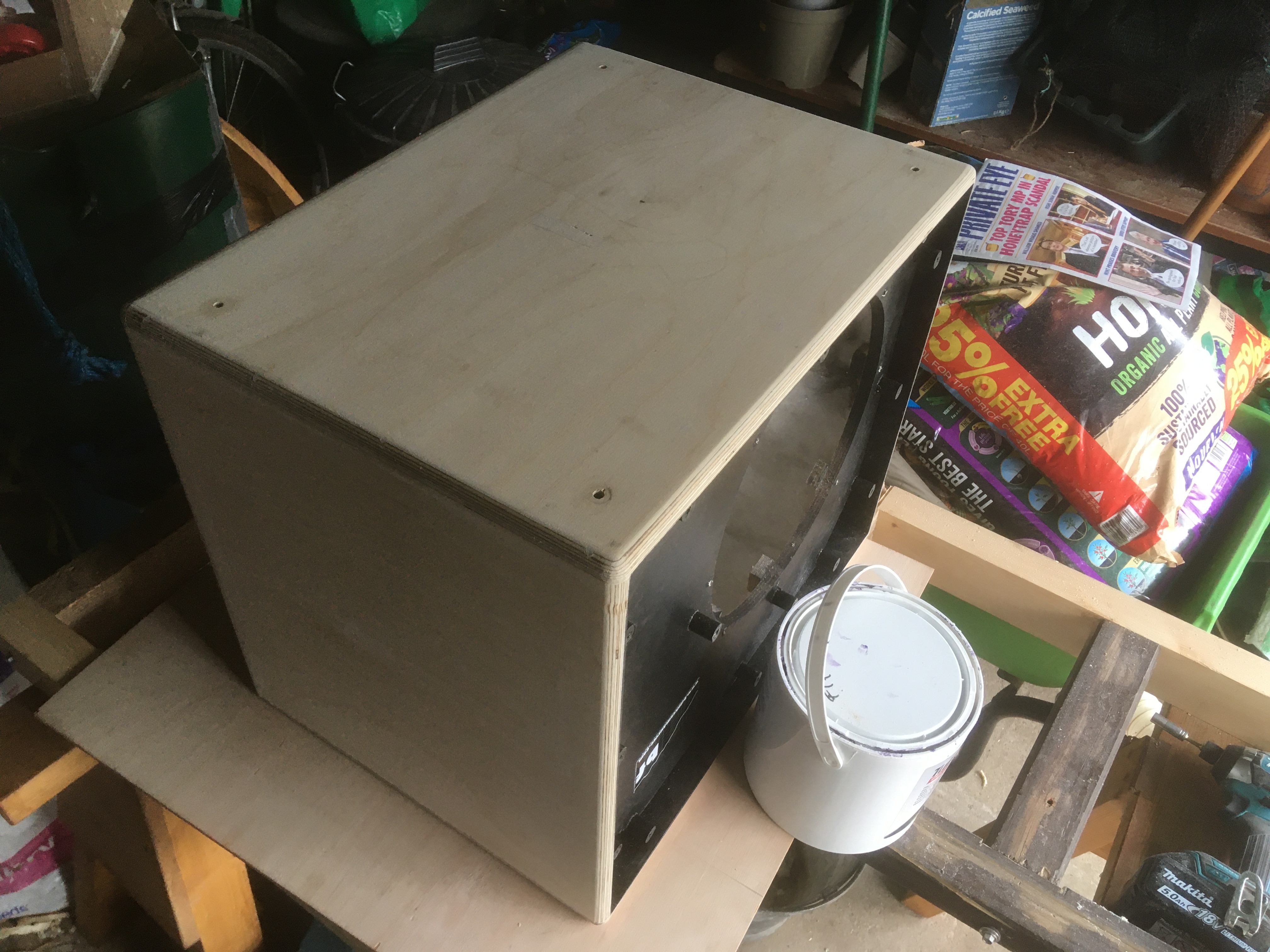

Woodwork finished - all edges except inside front baffle rounded over with 9.3mm radius router bit
Rounded all edges - front

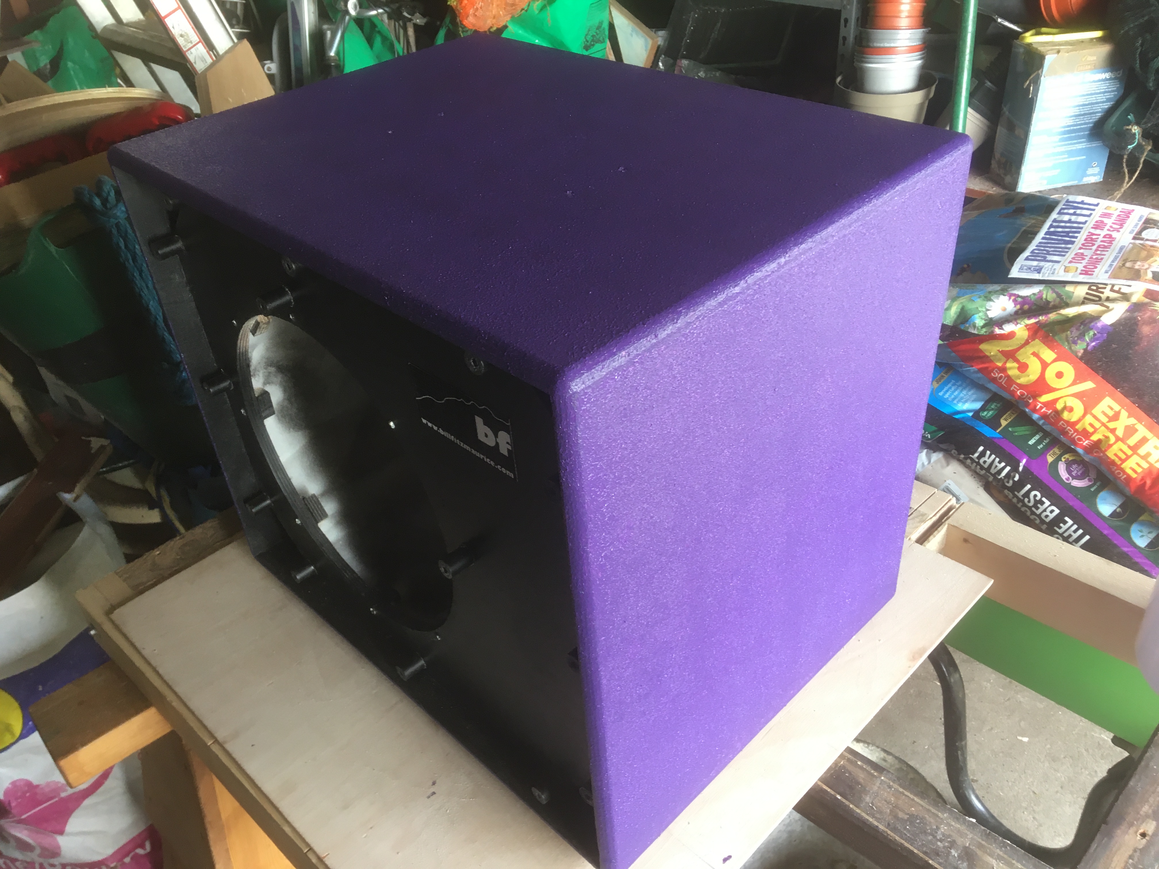

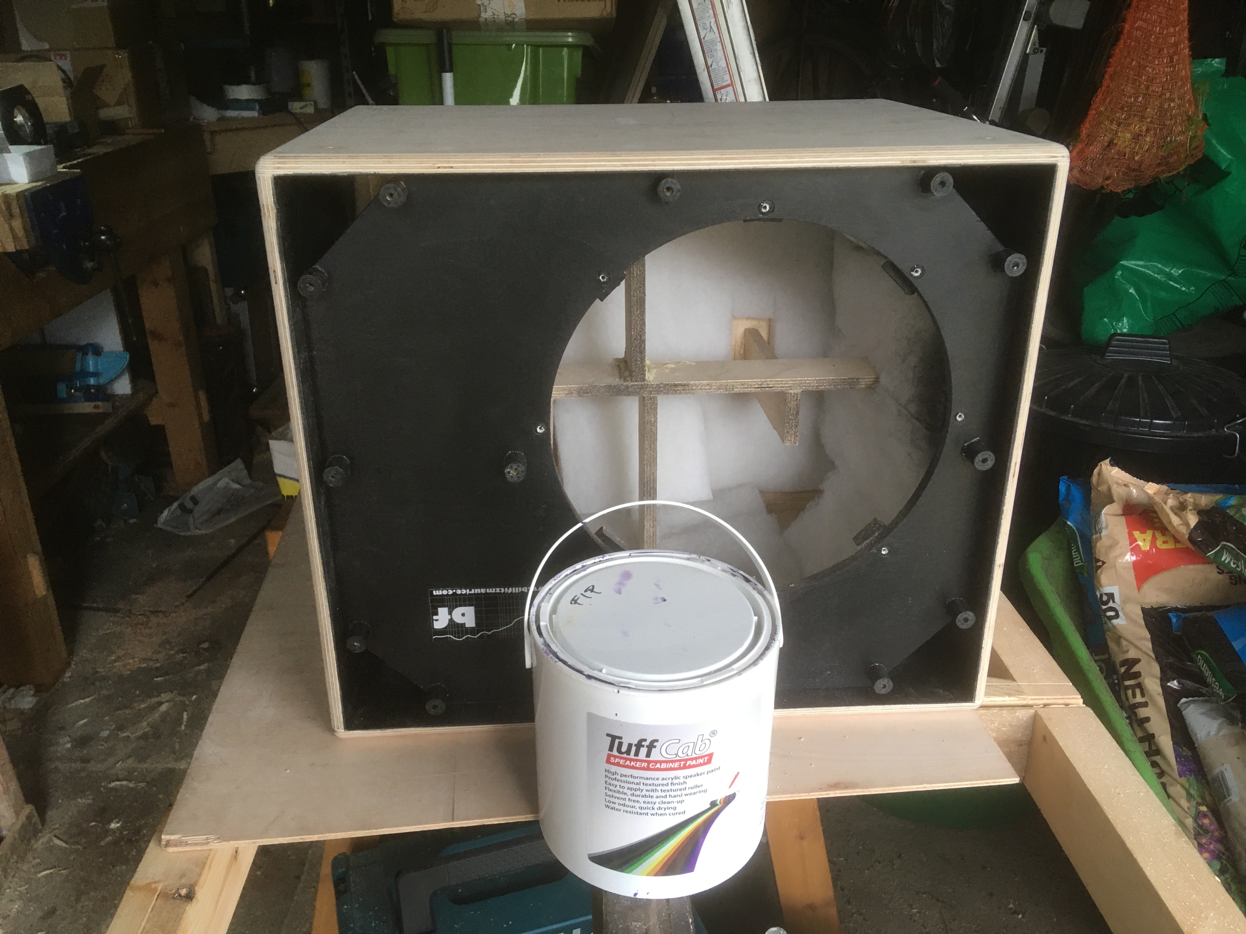

Ready for the "Funky Purple" TuffCab paint - takes about 20 minutes per coat to apply, dries within 5-6 hours (even at 9 Celsius).
Starting with the bottom of the cab.
After painting the bottom, put 6mm x 50mm wood-screws wrapped in a little masking tape into the bolt holes to act as feet while painting the rest of the cab.
Finished cabinet with first of three coats of TuffCab "Funky Purple" paint
"Funky Purple" - coat 1 of 3
