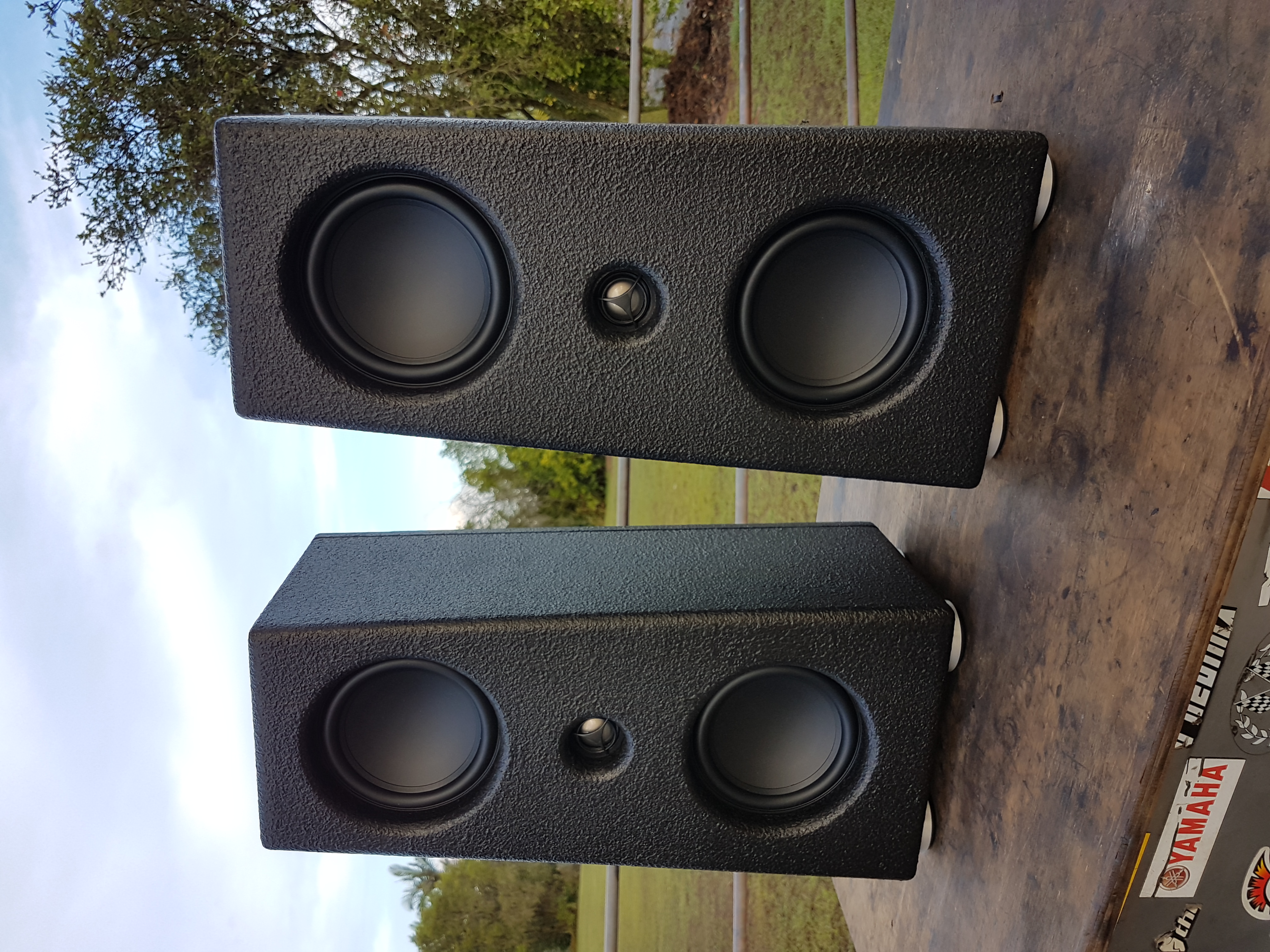

Camillo wrote: Mon Feb 12, 2024 8:55 am ...and make 2xmtm stand alone cabs to hang on the Wall, stereo config with only one sub
You could build the MTM and a TT..
