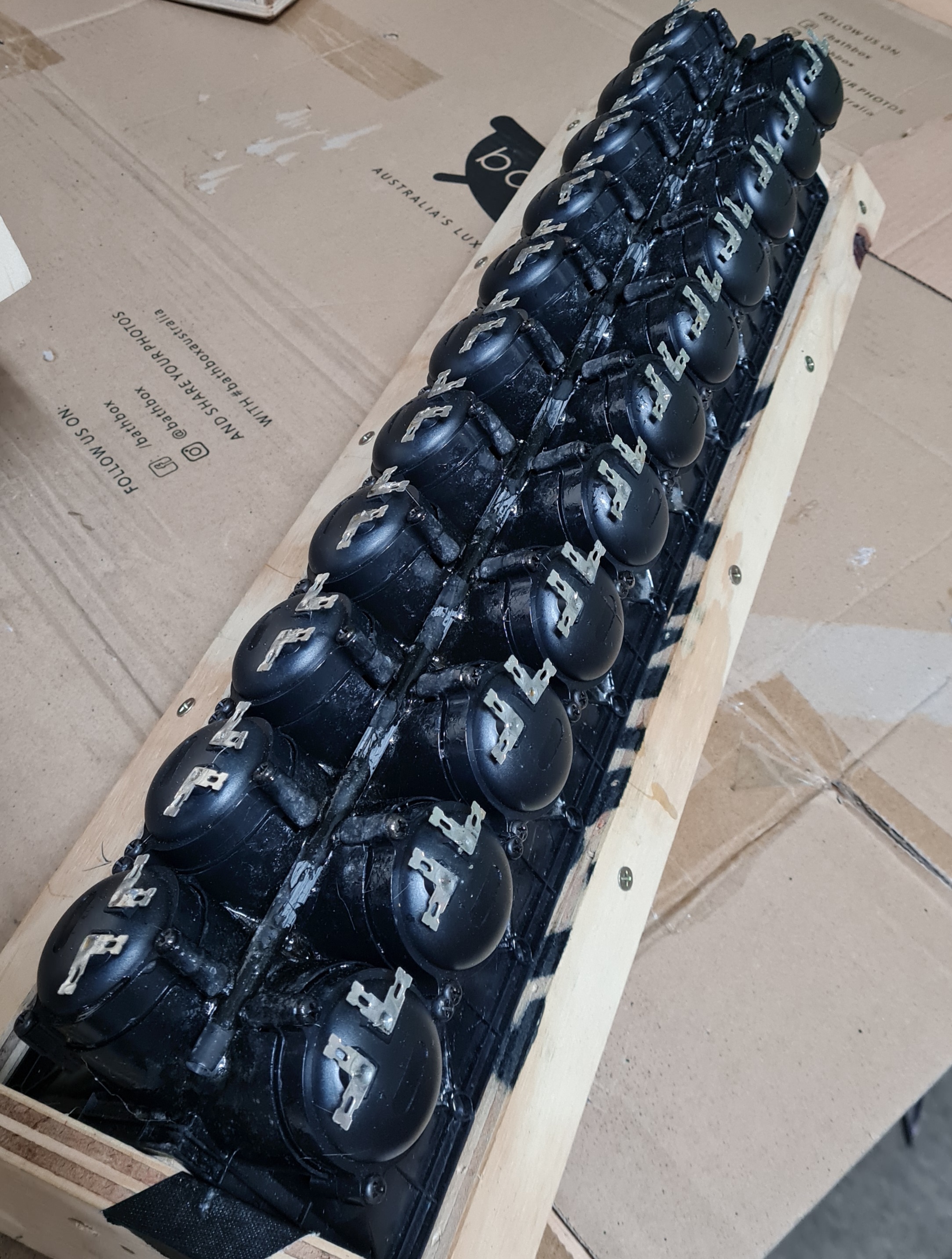

I'm struggling to find a neat way to attach the diffuser. It's a poly water pipe, l liked the black gloss finish. Maybe fine screws from the inside, but there's a carbon arrow for strength in the way. I could always glue it, but the CA glue develops that whiteness in the area after curing. What about the rubberised CA glue used for attachment of the caps to the KL3015CX, would it do the same thing on poly?

What glue did you use to assemble the array? Wouldn't that work? You should be able to wrap the tube in sandpaper and rub it up and down a coupe times to mark the tweeters and know where to apply the cement.

It was model aeroplane cement initially, then PVC pipe glue. The cement is great for transparency, but won't hold it by itself.
I had thoughts of aviation lock wire today, threaded through in three spots, and anchored to the arrow, I'll entertain that this week & see if it'll work

Tell me a little bit about this little bit of trim work that covers the screws on the melded array. I've never seen that before.

It's a peice of 90 degree aluminium trim which l had 9/16 taken off one side by a local window manufacturer. There will be four small black screws each side through the trim attatching the array to the module, once l sort out attatching the diffuser and these trims I'll post a pic mate.
