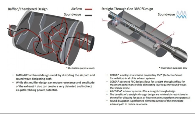

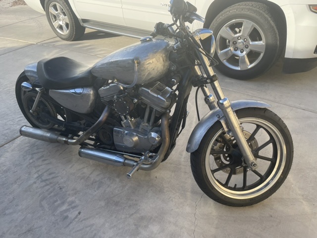

I am interested in a baffle design that can efficiently absorb/attenuate spl level without restricting the flow of the exhaust gases. See my attached, there is so much snake oil regarding this topic.
My bike is the rough unpainted job, the other picture is of an bike with an exhaust system that I really like, the issue is that those LAF pipes are just to impractical. How to builds pipes like that that cut 15db and still flow sufficiently!!!!

A lot of this stems from my tinkering with the oem exhaust system on my sportster. I started out with it as used and abused 883cc. I installed a basic 1200cc conversion kit with a capable programmer. I started with tinkering on the exhaust system by gutting it and then using the various parts I removed to establish some experimental baffling. I have attached a crude drawing depicting a variety of configurations that are easy-ish to achieve. It would be fun to be able to hear the sounds the engine makes while actively adjusting the dimensions of the different parts to achieve an optimal desired form factor or a least better understand the possibilities. For a stretch it would be fun to actively dyno the engine at each change just to see how the performance is affected. I realize that of all the ways to pinch extra power out of an engine that this is a low potential return on investment but still my curiosity is peaked.
The drawing I attached is a result of the possibilities I have from modifying or altering the oem parts but the amount of options are just vast enough to make me want to experiment.

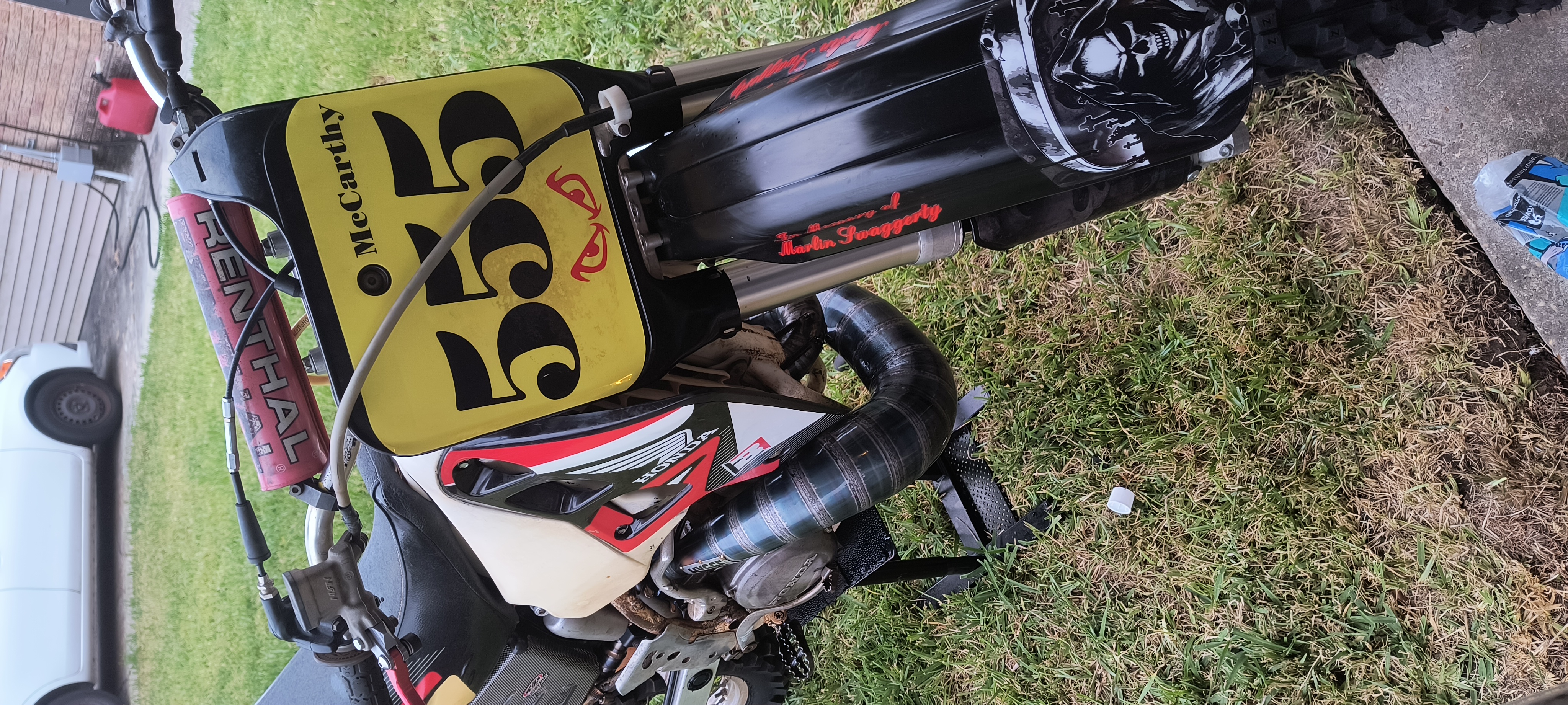

One thing I do know about sound engineering and combustion engines, is that it is important for engine performance on a naturally aspirated 4 stroke for purposes of scavenging during the intake and exhaust overlap.
When it comes to 2 strokes such as motocross bikes, specially the 125 cc 2 strokes.. you take that pipe off and the engine falls on its face in power output. Not only does the principle apply for scavenging like on 4 strokes, but it also pulls extra air and fuel into the chamber that goes into the expansion chamber for a split second before the sound wave bounces back and shoves the mixture back in after the intake port has been sealed by the piston just before the piston closes off the exhaust port. There is a reason the expansion chamber looks like a horn lol.
I added a picture of my Honda CR500 with a good view of the pipe for reference.
