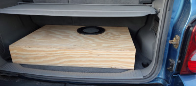

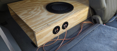

Finally got the Truck Tuba in the Jeep Liberty wired and crossovers somewhat set. Tuning is ongoing and the biggest problem is from the dash and door speakers. The subwoofer is great sounding as it sits. I have adjusted the crossover anywhere from 80Hz up to 200Hz and it simply works. Now that I see it in the hatch area of the Liberty it does take up more space than I realized it would but that's ok as it is easy to remove. The 8 channel amp I am using has the 7th and 8th channel driving the tuba at a maximum of 40watts per channel so 80watts total and it works. I am going to add a separate two channel amplifier for the tuba eventually but the simply setup at the moment works. Making the tuba pretty is next. I have carpet and duratex paint.
Posts: 3140
Re: Truck Tuba in the Jeep playing
#2 Post by Seth »

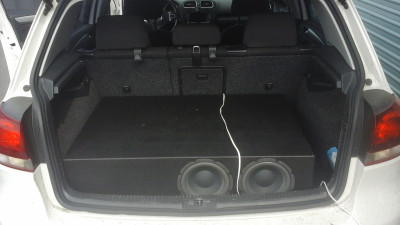

The size of your cargo area looks to be very similar to my VW golf...
And I agree, it does eat up more space than I had envisioned too.
Keep us updated as it comes together :thumbsup:

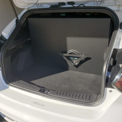

Looks great in the Liberty. Here’s mine in Ford Focus ST. Same for me, love how it sounds on Factory amp, but still might add a small amp. Love Seth’s dual tuba, too!

Seth wrote: Mon Nov 20, 2023 1:11 pm The size of your cargo area looks to be very similar to my VW golf...
I originally bought the plans to make this for my golf. I sold it before it happened but its good to know it fits as I keep looking for another golf.
With your speakers on the short side it keeps the cargo area more usable than my setup. I have a metal speaker grill but you still don't want to set anything on it.

#5 Post by Bill Fitzmaurice »
Put 1.5 inch legs on the cab, then you can flip it over.

Bill Fitzmaurice wrote: Tue Nov 21, 2023 8:32 am Put 1.5 inch legs on the cab, then you can flip it over.
I was wondering how much clearance was needed to flip it. I have some legs already. Thanks Bill.
