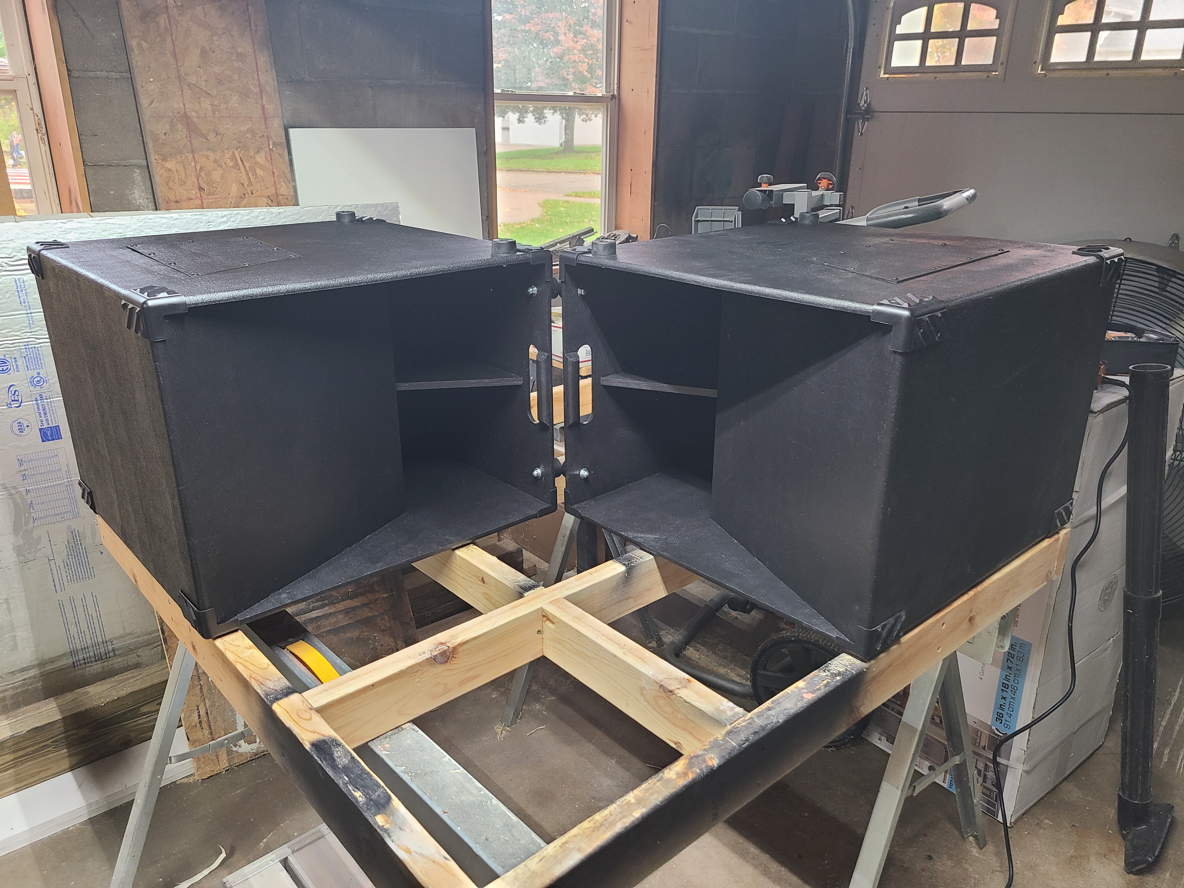

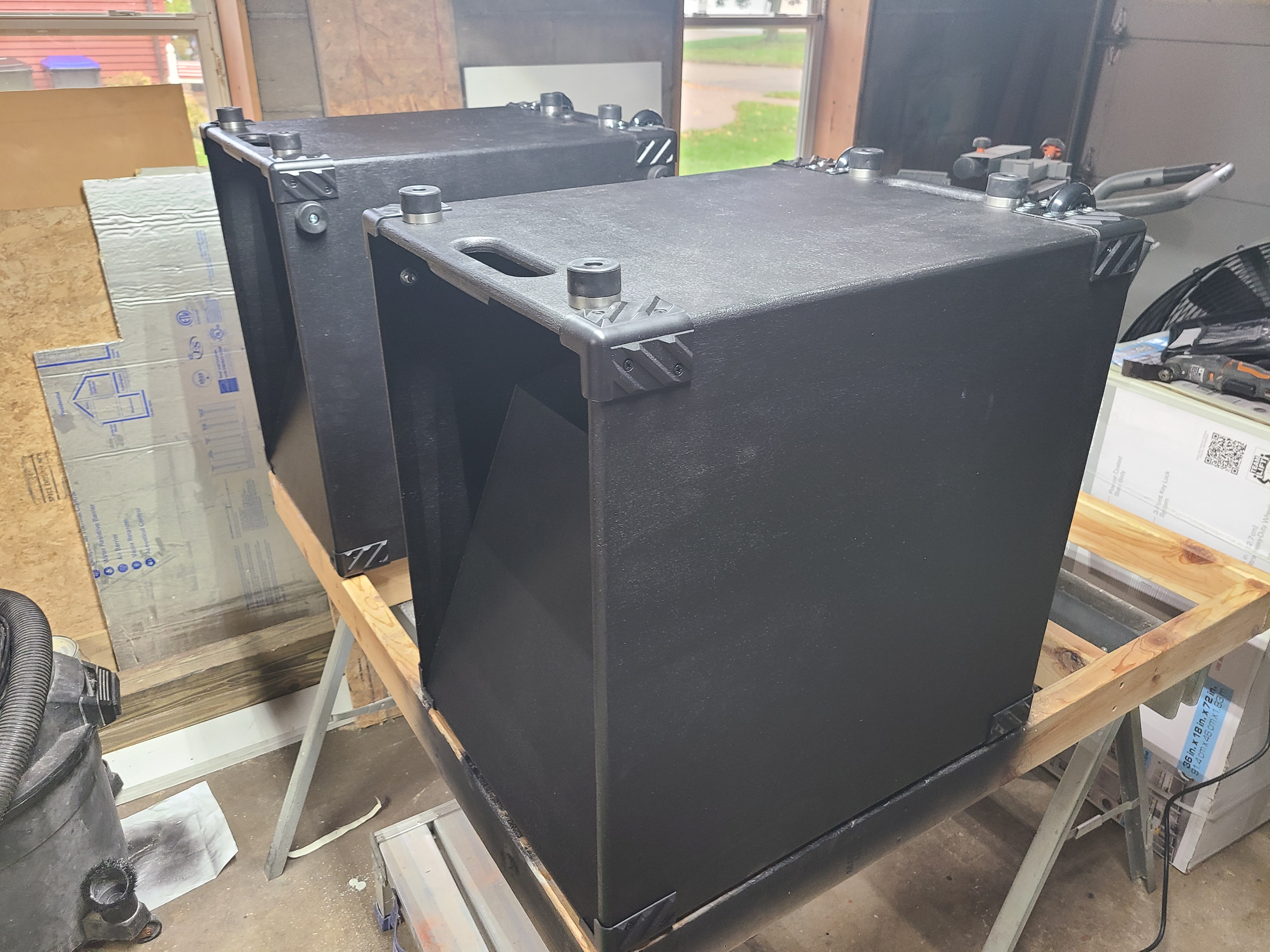

Been a bit, busy with a vacation week and camping on weekends, but cab 1 is finally done.
I've been listening to it a bit while on sawhorses and sanding/finishing. Hoping to break it in more, as I did not give it a full 8 hours of tones as recommended and I normally do. I ran each driver a few hours, and let music drone on them last two weekends I was home, while working in yard. Now the pair is complete, I've stacked them for now, next to my T48's. As expected, I have to turn them up two notches to match T48 output levels. I'm going to listen as is for a few days. Hoping to set the whole rig up in the driveway this weekend for a proper listen and thrash. I can see where I need to set a low pass, for sure there is more low end i'm not used to hearing in the garage with the Titans. Odd bits are rattling more, granted they are a foot or two closer to the back wall of garage, but also 2ft away from sidewall where Titans are parked. I have to say, I do like the low end on newer music, Rihanna and what not. I don't listen to much new stuff, but definitely some punch there. Also some classic rock has kicked a bit more i feel. That could be the Emperors New Clothes effect though LOL. We'll give them both a listen outside this weekend, with limiters set and low pass to get close to apples to apples.

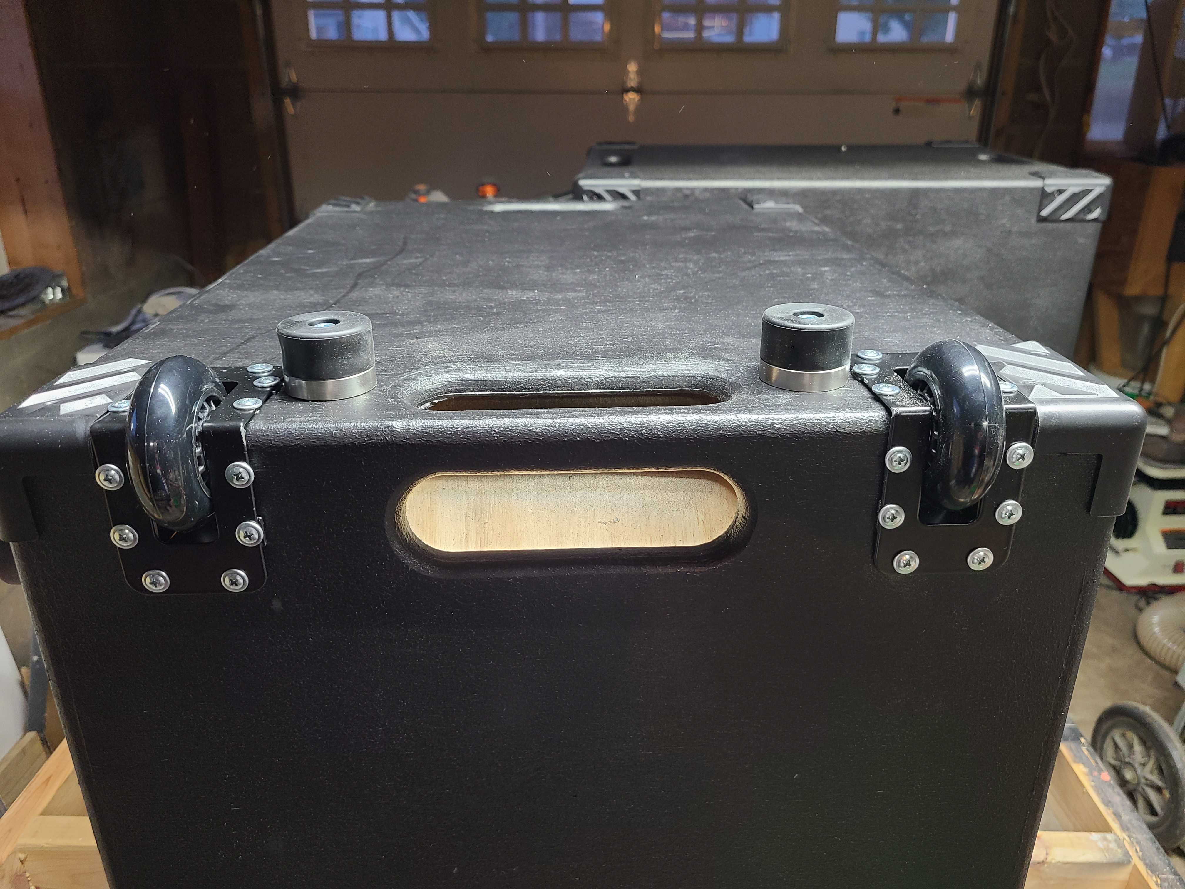

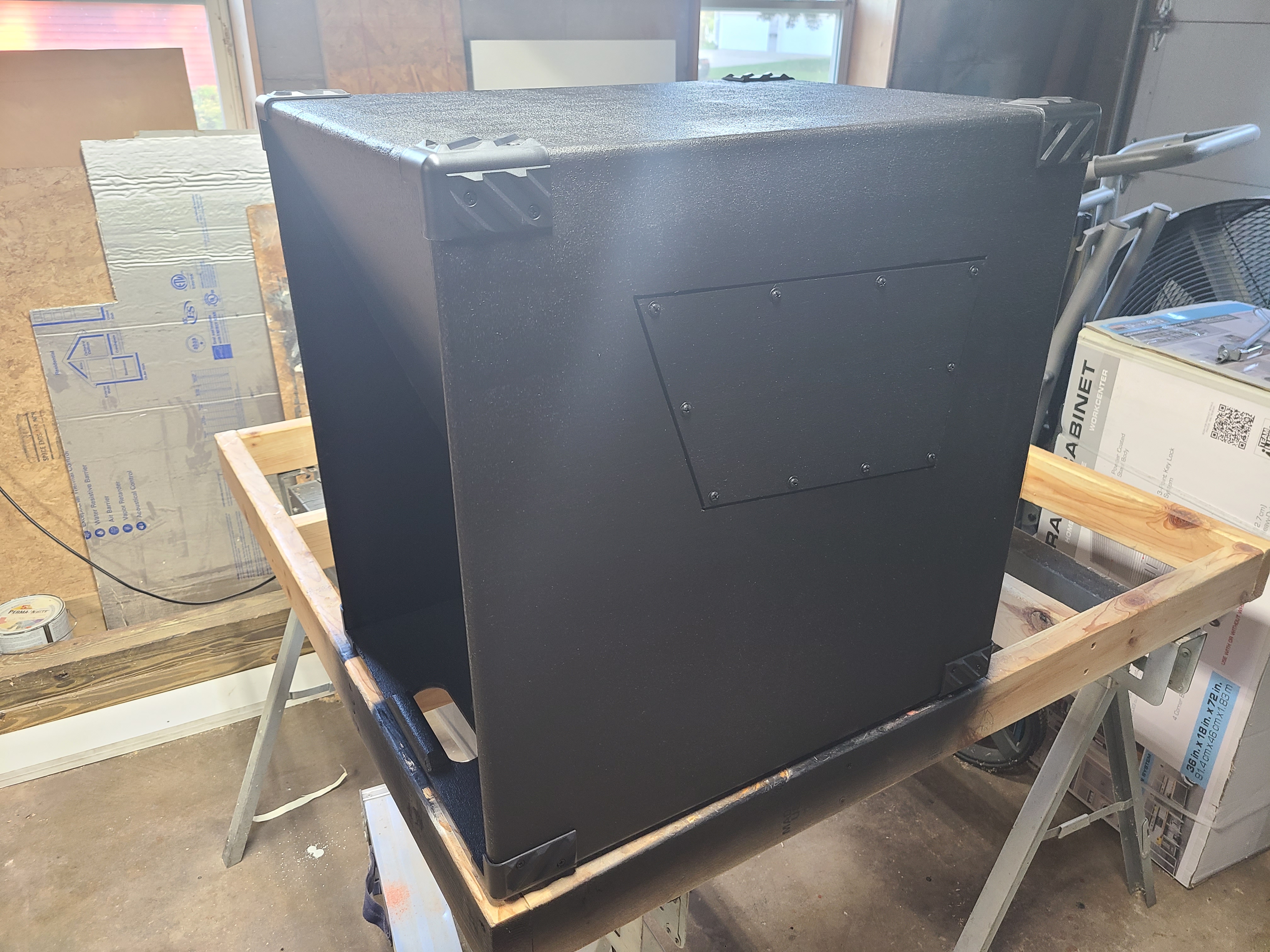

I have a v-plating question, so I need to show my progress, or lack thereof lately. I've been fiddling with casters and feet. I don't remember if I ever showed, but I put the Reliable Hardware Company RH-9024BK-A Recessed Tilt Caster on my T-48's that recess into the corner reflector area some people cut off to save wood and add 'normal' casters anyway. I like them, they move my Titans with ease, combined with the built in handles. Then I ended up putting Reliable Hardware Company rubber feet on my Titans for sitting on my garage floor. So I thought I'd do the same on the T24's and buckle them together as Bill shows in the plans. I have my casters in, feet on bottoms, and I'm putting some on side to V-plate. Then I realized my bottom ones are close enough to the front edge that it keeps the cabs about 3/4 of an inch apart at the mouth. Is this an issue? I may just drill new holes 'behind' the corner stacking chevrons ( I won't use to stack LOL, I just like the looks). I put 4 feet on bottom, and now I'm feeling like I only put 2 on the T48's and let the back sit on the wheels. I'll have to dig them out and look.

I put my T24 on 4 casters. I can't see how you can tip those back and use just two casters as short as they are. Are you going to stack them for moving? Maybe I'm not understanding how you are planning to use 'em.

Yes I planned the casters for stacked moving. Roll them to truck, tip up and roll other end in!Bruce Weldy wrote: ↑Thu Oct 19, 2023 5:50 pm I put my T24 on 4 casters. I can't see how you can tip those back and use just two casters as short as they are. Are you going to stack them for moving? Maybe I'm not understanding how you are planning to use 'em.

Sounds like a plan.howiez wrote: ↑Thu Oct 19, 2023 7:16 pmYes I planned the casters for stacked moving. Roll them to truck, tip up and roll other end in!Bruce Weldy wrote: ↑Thu Oct 19, 2023 5:50 pm I put my T24 on 4 casters. I can't see how you can tip those back and use just two casters as short as they are. Are you going to stack them for moving? Maybe I'm not understanding how you are planning to use 'em.

PRETTY sure Bill has said that the gap will be of negligible importance, but if it bothers you, just move the feet of one both outboard a bit, or move all four frontmost ones back a wee bit for clearance.

A gap would be a problem if it was a significant portion of a wavelength. The shortest wavelength passed by a sub would is around ten feet.

Question/clarification please... The lower frequencies which see the most benefit from the use of a V-plate would still benefit, even if the cabs were a foot or two apart and "V-plated"?Bill Fitzmaurice wrote: ↑Fri Oct 20, 2023 10:52 am A gap would be a problem if it was a significant portion of a wavelength. The shortest wavelength passed by a sub would is around ten feet.

To some extent, yes, but I wouldn't recommend it. Why would you have to?
