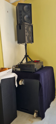

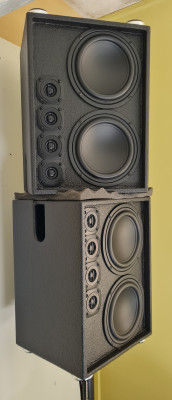

These are the HiFi frankenshorties built from the other SLA, they look weird, but sound nice! Crossed at 5.5k 3rd BW with Jantzen filters, I fumbled around for a while with impedance, though settled on 16ohms, the drivers are 8ohm series wired Jaycar 6.5" Hifi/GT302 tweets with an 8ohm resistor paralleled on the tweet filter output (cheater, yea..), the sub is a 28" Lab15 T30, powered by an ancient Pioneer receiver with a 200w Sure HiFi D amp for the T30. One day I'll fit a second top hat for a safer spiral array if they go outside, they do well in the Billiards room. That AT sitting there, is that affecting LF output just by being in the room? I ask as the next room over has the second T30, and a LAB15 THT also in the same room, not using them together though, one system is HT, the other at my work desk for 2.1 sound.
Posts: 3075
Re: Uses for a single SLAP
#17 Post by Seth »
Is it me, or do I spy a Dayton Audio KABD-4100 in there too? Or, is that the Sure?

Seth wrote: Sun Oct 01, 2023 11:21 pm Is it me, or do I spy a Dayton Audio KABD-4100 in there too? Or, is that the Sure?
It could be mate, this was bought through Sure though, the AA-AB31243

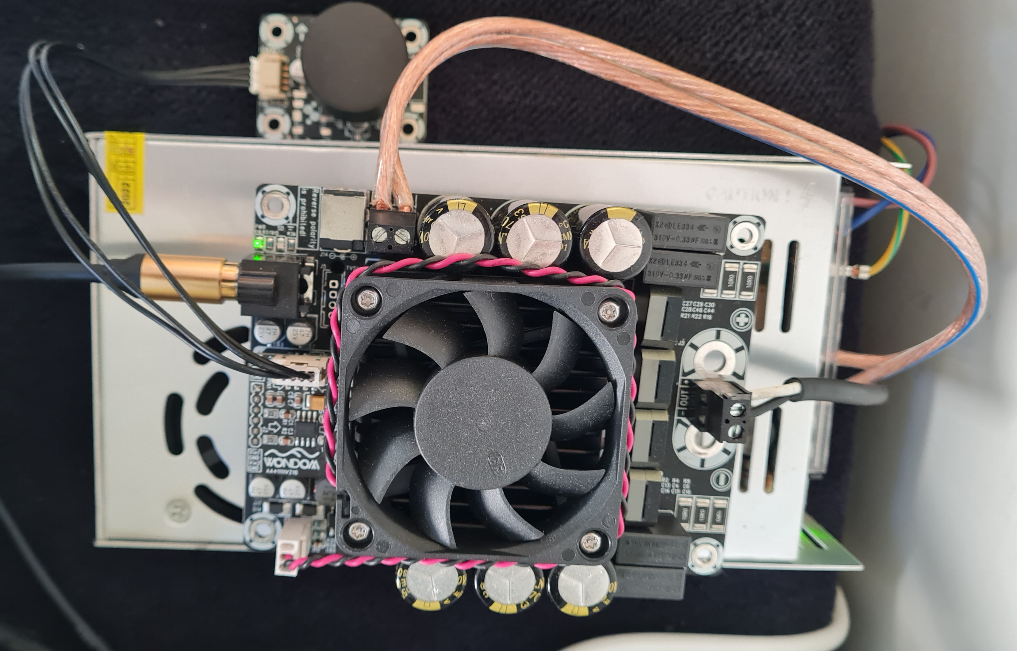

The input attenuator works well, auto standby. Its turned -13 detents to be balanced for my liking
