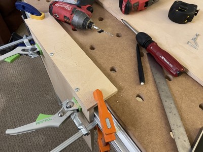

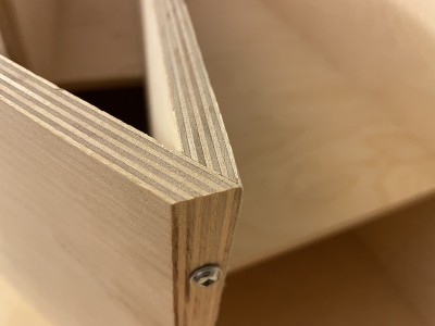

In the slim width, the instructions are to cut panel 1 into two pieces...This had me quite worried at first as this only leaves but a sliver of panel 1 with which to attach panels 2 & 5, all the while trying to keep things absolutely square.
This is where the panel-cornering jig feature of the MFT saved my butt. Locking everything down to the table, it was no big deal to sink screws into that small piece. Once attached to a larger piece, it could be placed back up to where it needed be with much less fuss. At the end of the day it was only 1mm out of square over the entire 14" width, without the second side in place.

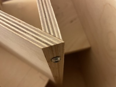

Sharp eyes will also notice how perilously close I came to blowing that first round of screws in the corner jig through the outer layer of panel 5, as I forgot to add an 1/8" to my combination square (my typical overhang allowance) when striking that first layout line .
You can actually feel the shanks through the veneer. Too damn close.

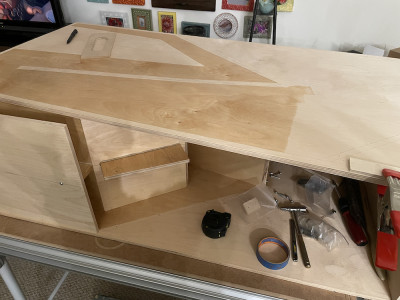

I've got some little triangles to measure and cut that will be used to block off the space to each side of the handholds, situated behind the reflectors. While I'm not too keen on permanently enclosing those spaces for now, I definitely don't like the possibility of people or critters stuffing shit into those areas at some point in the future.

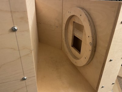

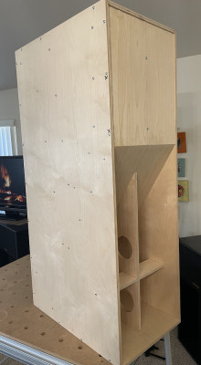

After dry fit, some more fabrication was required for the mouth braces and hand holds before finally laying down adhesive. Just like my Auto Tuba build, all the interior surfaces that wouldn't be seeing exterior treatment received a coat of polyurethane. Extra work I know, but I like the long term peace of mind. Cab #1 is all buttoned down as of yesterday. Pulled 2/3'rd of the screws today and trimmed some PL squeeze out where it was cosmetic. Finish routing, grills/mounts, access panel and speaker hardware/wiring to follow...in addition to paint.
The long visual lines play with the eyes. Gives off the illusion that the cab is just a "thin slice" perhaps, but even at the slim width (of ~15") the T48 design is still quite daunting in-person. Four of these are going to be straight-up menacing.

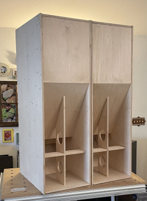

Cab #2 in the final stage of dry-fit. Paired up with cab #1 for a photo-op. Finally at that tipping point in the project where the bulk of the fabrication of is done (awaiting driver access panels that is). Primary assembly is trucking along steady, then it'll be onto finishing/paint, final assembly, and testing. Woot!

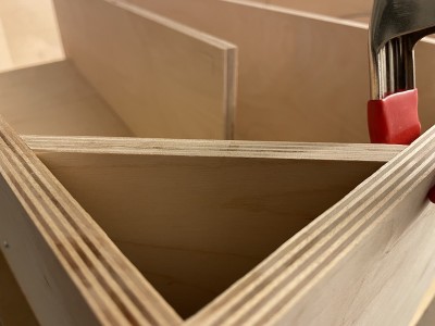

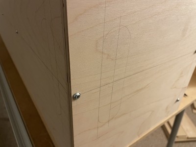

If using the screw method of assembly, staking these corners and use of a sharp-jawed spring clamp placed as shown also helps immensely. Cured PL already trimmed off.

Closeups of the hand hold pockets, which will be routed out later with a jig.
