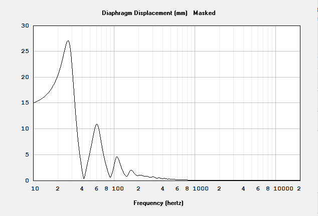

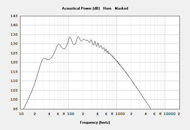

I used to think excursion was linear across all frequencies. However, it's not. For the same voltage input cone travel may be nearly nothing at one frequency and bottoming out the coil at another frequency. AND, the output is more in the higher frequencies when the cone is moving less distance overall, which is a little counter intuitive and confusing.
To consider your questions, I think we'd have to designate a specific frequency.
And it seems that, for a given voltage, Xmax or Xlim is easily reached at the bottom of the target frequency range when the upper end of the frequency range is nowhere near the excursion limit.

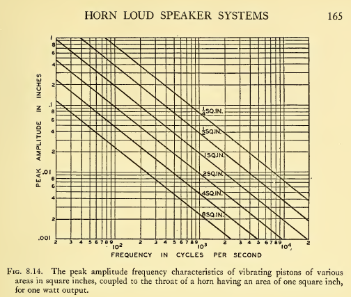

Page 164-165
G. Power Handling Capacity and the Amplitude of the Diaphragm
The maximum allowable amplitude of the diaphragm is another factor
which may determine the maximum allowable power output. The power
output, in watts, of a horn loud speaker in which the diaphragm is terminated
in an acoustic resistance is:
(an equation that does not transfer properly when I copy and paste)
where p = density, in grams per cubic centimeter,
c = velocity of sound, in centimeters per second,
/ = frequency, in cycles per second,
d = maximum amplitude from its mean position, in centimeters,
Ad = area of the diaphragm, in square centimeters, and
Ah = area of the throat of the horn, in square centimeters.
The amplitude of various diameter diaphragms coupled to a horn throat
of one square inch for one acoustic watt output is shown in Fig. 8.14.
From the graph every halfing of the cone/piston area, a doubling of the amplitude is required to maintain the same acoustical output. I believe this is the same as specifying a given Sd and doubling the excursion is the same as keeping the same excursion but doubling the Sd!

The 1940 version is very good, but the 1957 revision is better.
He doesn't talk about Sd and Vd, as those were yet to be invented T/S specs. Today we'd say with each halving of Sd a doubling of excursion would give equal Vd.
