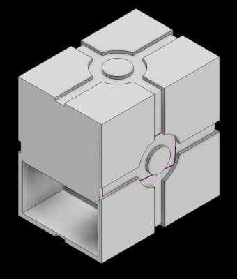

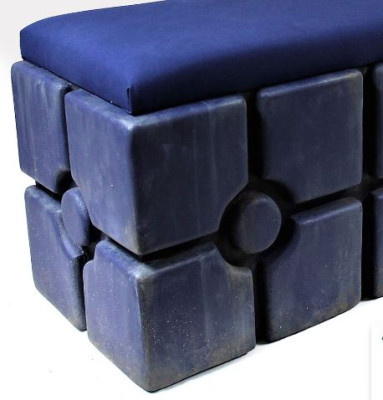

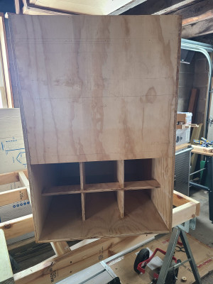

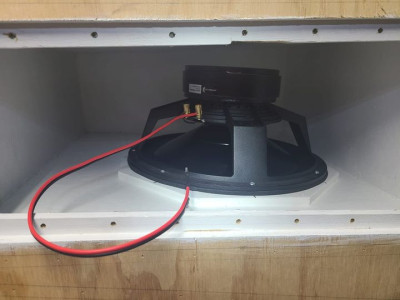

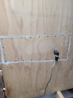

Small update, finally got back to this after a long winter lull. I have the driver mounted and gasket leak detected. I have the leads tinned on one end and soldered female spades on the other for the Speakon. Have the speakon jack in the access cover and latex/silicone caulked. Have the access cover mounted and leak tested. I did some preliminary listening still on sawhorses and my platform (see the 3rd picture). Amazing sound even 3 feet off the floor and basically in the middle of a single car garage with cinder block walls. It is un-equalized, running off a 300w BASH amp fed from LFE out of my garage Onkyo receiver. The tops are my DR200's also run off L/R channels LOL. Those I have a little EQ on, just a dual 11 band hooked to my Zune for garage tunes. So no real bass equalization. My Brother has an Emotiva setup so we should be able to dial in there nicely. I'm sure he'll be blown away as he's replacing a Klipsch 12" sub similar to what I replaced with my THT.
Now to deliver to my brothers house for some testing while he ponders what finish he wants. I have not filled any nail holes or cleaned up any rough edges yet. He may be veneering the whole box with foam to make a prop. His home theater/bar area has a lot of movie props and such so we'll see. The plan was maybe to glue 1 or 2" thick rigid foam shapes on the outside and paint it to look like a crate from Star Wars. See the last two pictures. I snagged someones bench version for ideas, and the last picture is my CAD mockup to try and figure out how to best do it and leave driver access.
driver mounted and wired
access cover installed

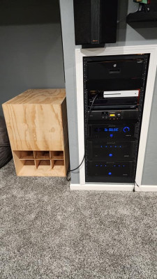

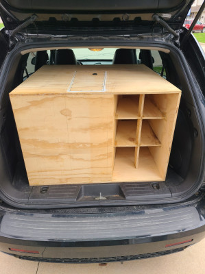

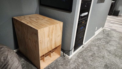

THT was delivered last weekend, I forgot to post. We struggled a little bit with setup. My brother has an Emotiva XMC-2 (i think) and dedicated XMC amps for his 7.3.5.2.whatever. Pretty sure he's 7.4.1, but I lost interest at 7.x! He decided to buy a Behringer NX3000 for sub duty, since he was using a Klipsch 12" sub before. Emotiva has all balanced outputs, and Behringer has Balanced inputs. Shouldn't be a problem. He was running a Balanced to RCA for his Klipsch. I have no idea if that turns down the pre-amp output level. He's run that Klipsch in this setup for about a year and a half since the home theater was finished. Sounded fine, I had the exact same one in my 17x22 living room. I'd say his living room is maybe 14w x 30ish long, a bit open in the back where bar area is.
We played about 10min of an action flick and it sounded as I expected. Then we plugged in and repeated, trying to bring gain up similar. This is zero EQ, he has some fancy (DIRAC?) thing that uses a Raspberry PI to calibrate and EQ, that is not even run yet. We were underwhelmed, zero bottom end, or really, it sounded just like the Klipsch. My wife was along for ride, sitting in front row of theater. She knew something was off, and she is not into sound. She said she remembers our switchover from Klipsch to THT and it was night and day (it was). She remembered all the sub 20hz stuff rattling the whole dang house, and feeling every explosion like real life. So we kept turning levels up, he does not have a VMM so I could help him set limiter in the Berry.
Well, we finally got to a place where it sounded decent. He tends to play older movies, early Dolby flicks that don't have a lot of bottom end perhaps. We finally hit on something with some oomph and it was better. IIRC, he turned up preamp output to +6dB to get us to that point. Gain on Berry was set about halfway. I'm sure more is there, but I warned him not to overdo it until we get a limiter on. Hopefully it's getting calibrated today, and we set the limiter, because I think he's having a May the 4th party. He plans to play every Star Wars movie through the month.
Anyway, a few pictures of delivery and its first resting place. I did do a subwoofer walk, one dead area near basement stairs where nobody sits. Otherwise decent coverage in entire room. And it barely fit in the back of my Equinox. I was pretty tempted to put it in my son's Pilot, since he has the Truck Tuba in there, and use his connection to try it in vehicle LOL.
