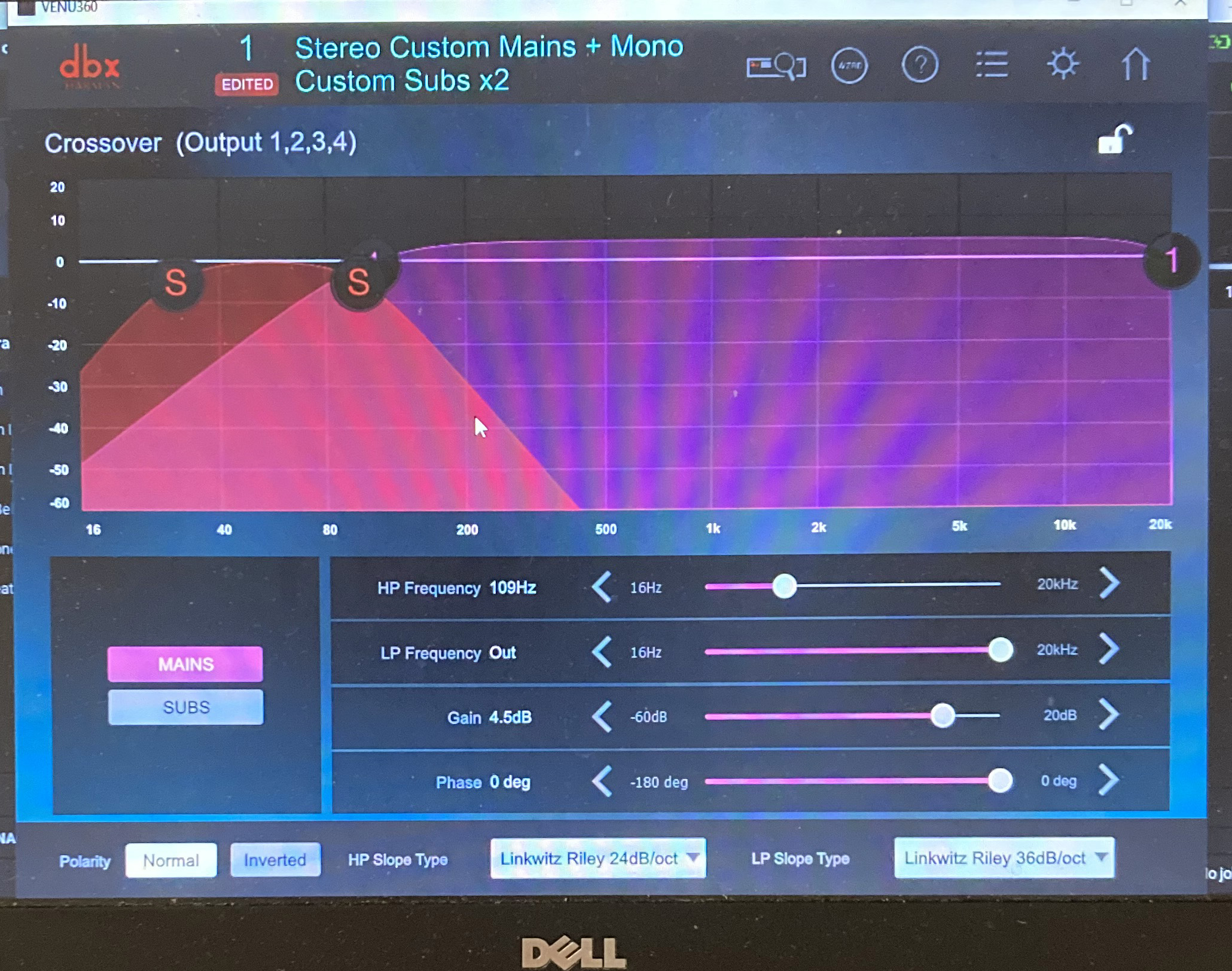

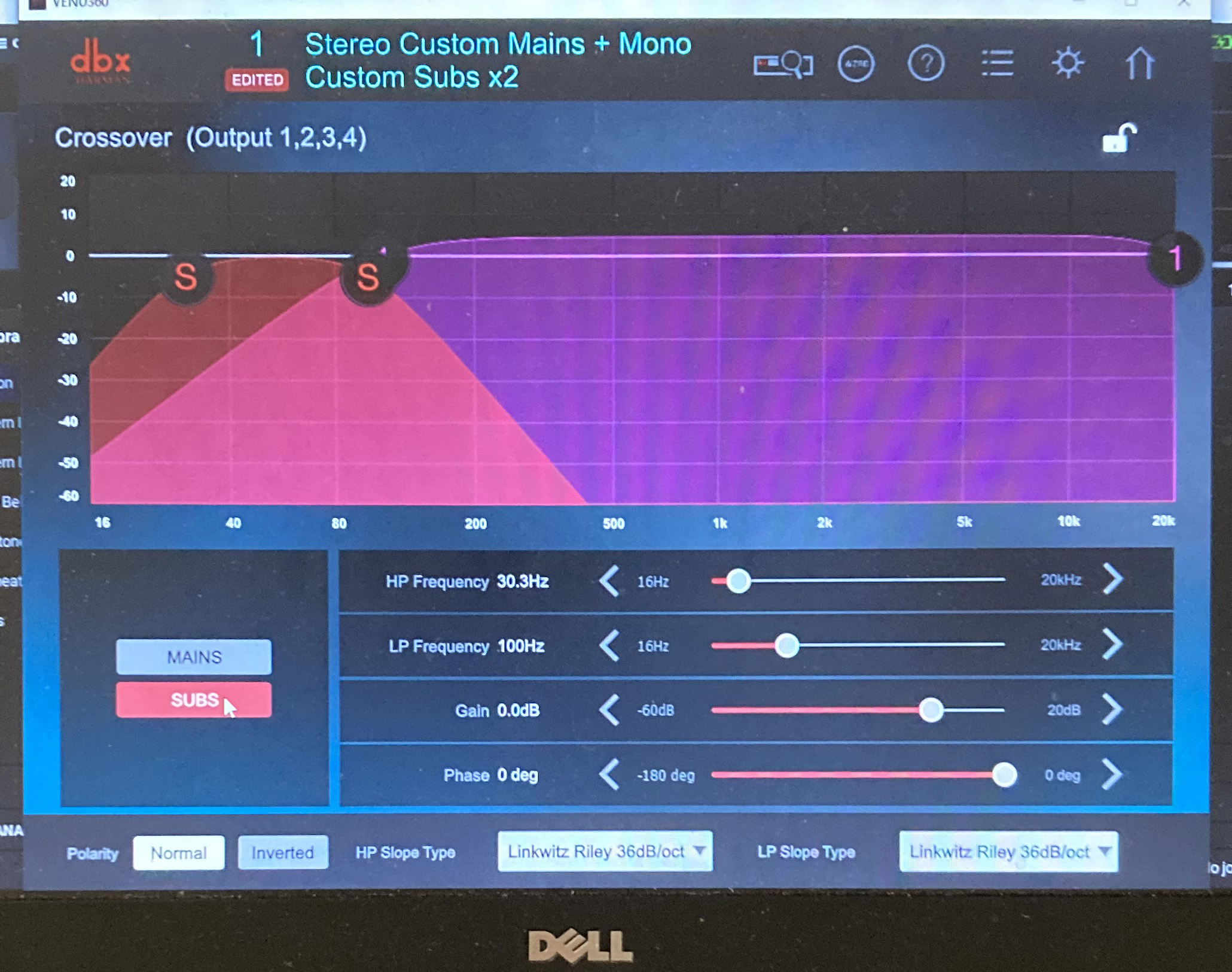

Thank you all again for your help. I managed to get back in the space briefly this past weekend.
Grant, I didn't feel I had time to go through the adjustments relative to speaker response as you outlined. I'll give that a shot at when I've got more time in there.
In the meantime I did play with the crossover configuration, matching the tops and sub in output and reducing their frequency overlap. Essentially I steepened the curves, widened the separation between the filters, and boosted the gain on the tops. Here's the configuration I settled on using in this session:
One thing you'll notice is the increase in gain on the tops. This was done to match top and sub outputs without needing to turn down the subs. If I turn down the subs this causes the limiter to start kicking in per-maturely. Ultimately I probably need to another amp to run all four of my tops but for now this seems like a reasonable solution.
Here is a video of pink noise running through the rig for reference: https://vimeo.com/820741276
I did do some peq work on this post autoeq to try to further flatten the response - it's not perfect but workable I figured. I can add a target curve after the response is flat using the graphic eq as needed - works well enough for now.
These changes do seem to have improved the bass some. I think they were overlapping too much - good call Bruce. That said, I still think there's other stuff going on here. Here is a frequency sweep from 20-200hz that I played through the system: https://riverurbanism.com/audiocheck.ne ... FS_10s.wav. When I play this through the PA, the sound seems to pump rather than being rendered as a smooth gradient as does through headphones. Here's a video of this in action https://vimeo.com/820741154
Any idea what's causing this? A phase mismatch perhaps?
Also, is it normal indoors that I should expect the bass to be present and then almost silent as I walk around the room? I've certainly experienced dead spots before but his seems extreme. If I play say a 90hz or 100hz tone and walk around the room the response seems to shift like every 20 feet or so ( I didn't measure). Thoughts on this as well?

WOW! Now THAT is a reverberant room! Holey smokes!
The response is about as flat as you'll be able to get it. Looks good. Great job :thumbsup:
In a room that reflective, yes, dead spots (known as nulls) would be expected. Cab placement can help. How were the subs configured in the room in the sweep video?
I highly suspect that the pulsing is also an artifact caused by the rooms acoustic qualities too.
Bodies in the room will improve your situation.
Not to say it can't be done with acceptable results, but I'd recommend dialing in your desired response curve with the Parametric EQ. With the adjustable Q of a parametric EQ, large adjustments over a wide range of frequencies create smooth response adjustments over the effected frequency range. The same curve over the same frequency range, moving the sliders on a graphic EQ to create the same shape, creates a very jagged curve because each slider has a set Q and the response dips in the frequencies between the individual slider frequencies. Not sure that makes sense the way I wrote it. I'll see if I can find a link for you tomorrow.
If you have less than four T30's the high pass should be set to 35Hz, per the plans.
The videos and screenshot data were helpful :thumbsup: I put my question in bold so you wouldn't forget to answer it.
Good catch, I had had it configured for 40hz because i had played around with fewer cabs the previous session and couldn’t remember if it was 30 or 35hz for four.

Tactix wrote: Thu Apr 27, 2023 1:21 am That said, I still think there's other stuff going on here.
Incorrect choice of cutoff points and filter slopes for the application.
tactix wrote: Wed Apr 26, 2023 9:40 pm When I play this through the PA, the sound seems to pump rather than being rendered as a smooth gradient as does through headphones. Here's a video of this in action https://vimeo.com/820741154
Combination of factors, but primarily comb filtering from too much destructive interference.
tactix wrote: Wed Apr 26, 2023 9:40 pm Also, is it normal indoors that I should expect the bass to be present and then almost silent as I walk around the room? I've certainly experienced dead spots before but his seems extreme. If I play say a 90hz or 100hz tone and walk around the room the response seems to shift like every 20 feet or so ( I didn't measure). Thoughts on this as well?
No. See above.

Radian wrote: Fri Apr 28, 2023 1:23 am
Seth wrote: Thu Apr 27, 2023 1:21 am That said, I still think there's other stuff going on here.
I'm sure it was a simple editing slip. That quote isn't mine.
Granted, it's not how I'd setup my crossover personally, I didn't see any red flags in reviewing the crossover settings.
Would you mind expanding on that a little?
