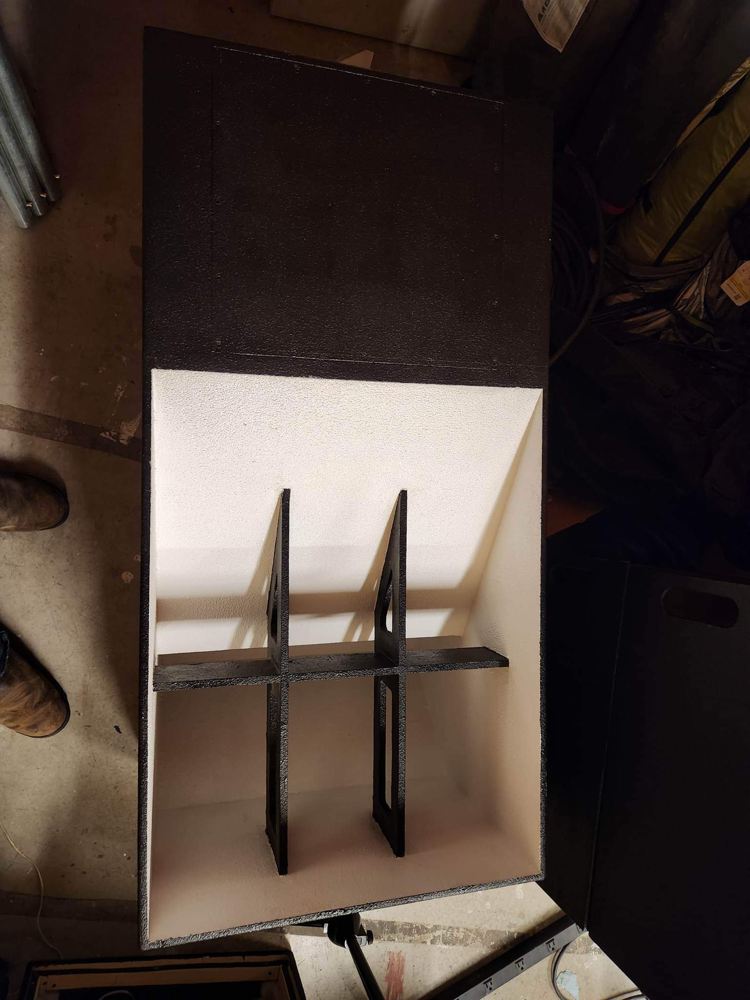

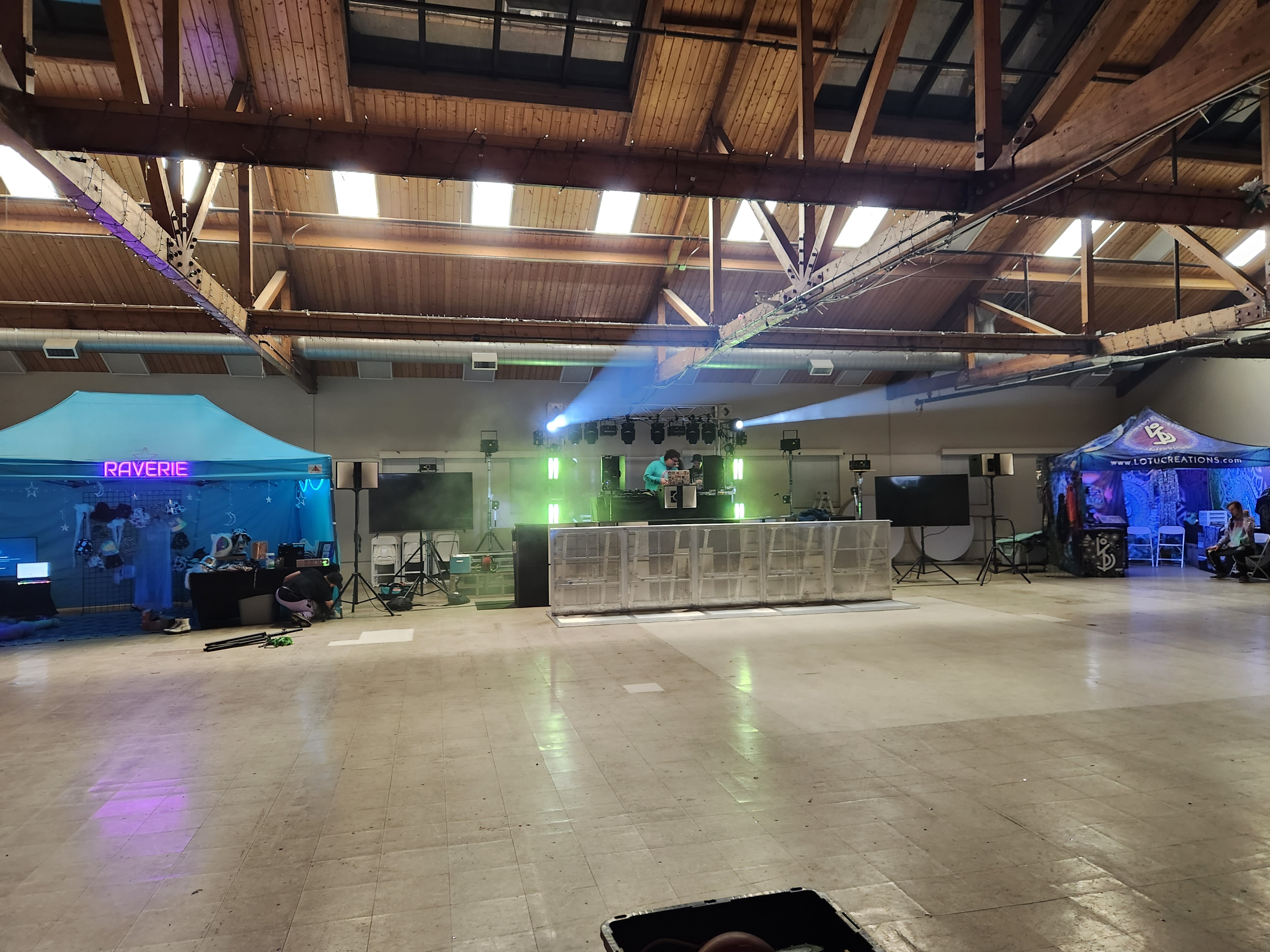

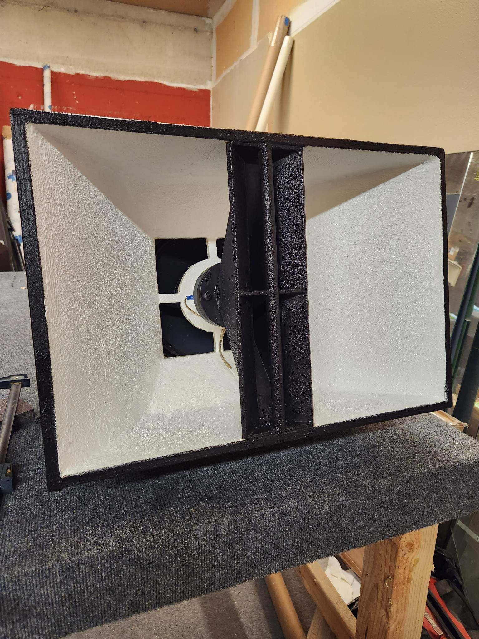

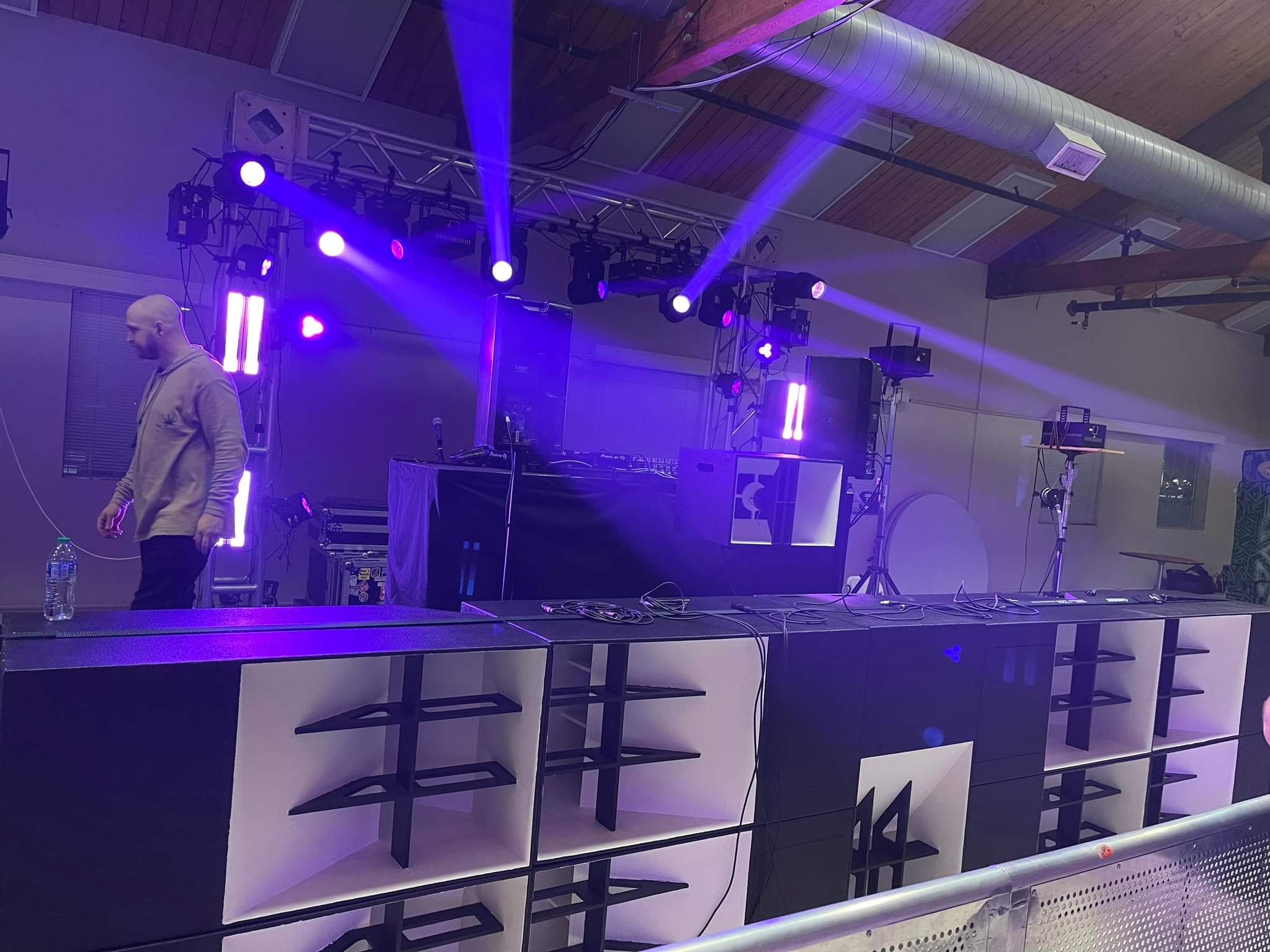

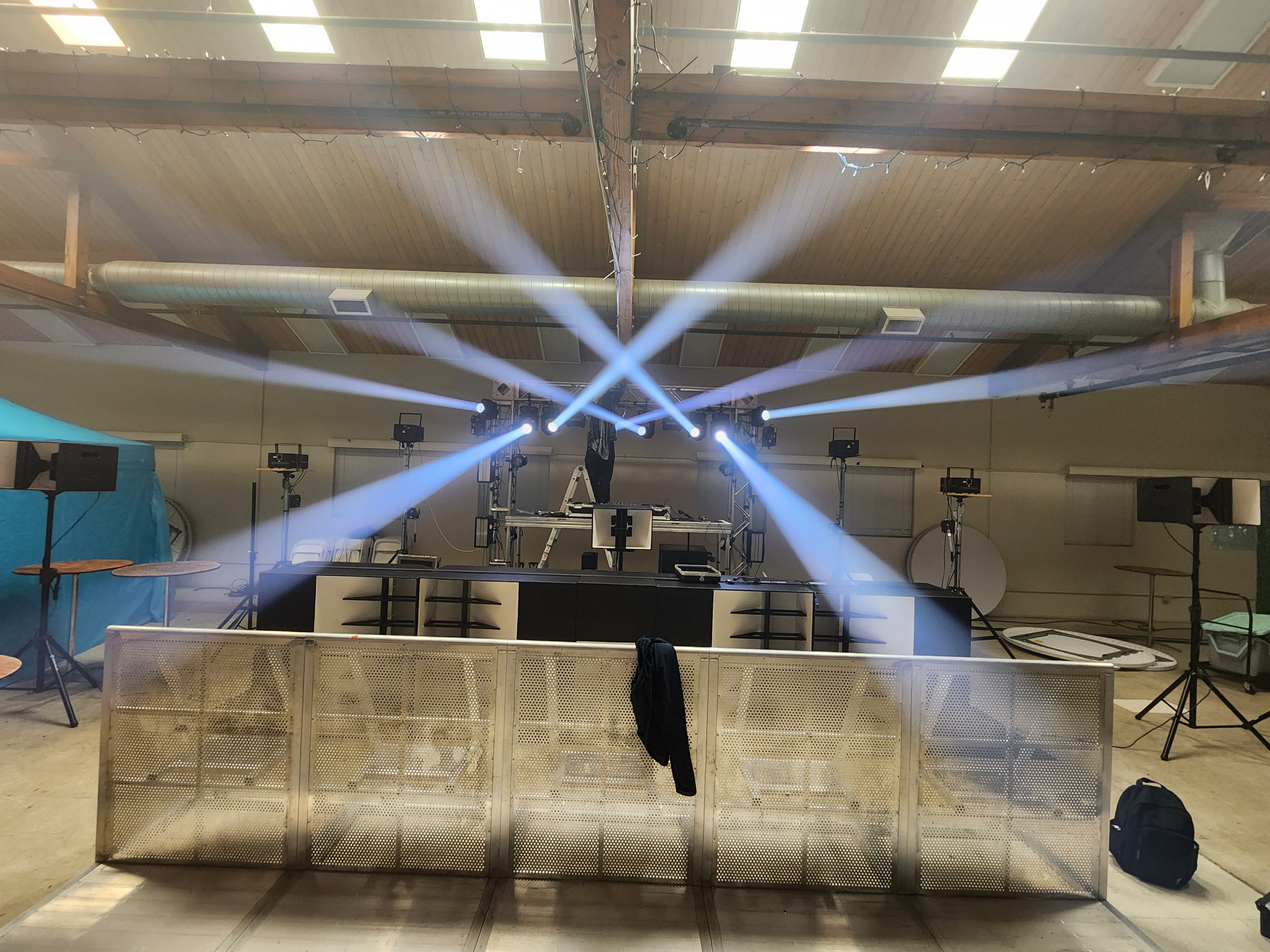

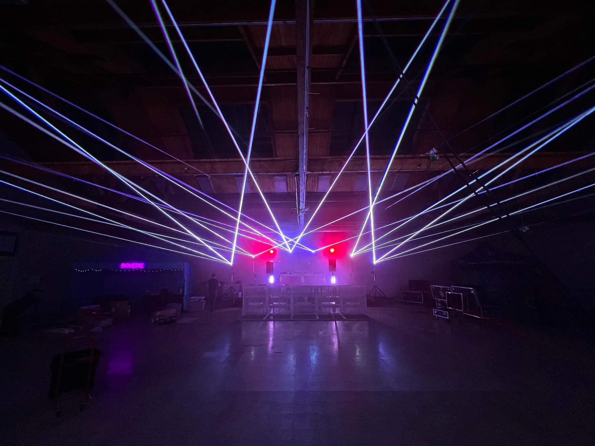

Threw a free party at the train station in Tacoma Washington. Room is wider than it is deep. We were running 9x 3015lf t48s under 3x 2012s/f151m ot12s. Ot12s were in a left/center/right configuration using the venue 360, and I found that I had AMPLE hf headroom and solid venue wide coverage. The booth was 2x k12.2 over 2 kw181. Dubstep all night, lol. The subwoofer placement was not great but the corners were occupied. Not bad for 3 weeks of planning and zero production budget 😂

That sure looks awesome 😎
I really like the white horn flares with black braces.

The white paint gets dirty easily but it's worth it to me. This was right after a fresh coat of white. You can stick LED cans in the mouths and it looks fantastic! Plus you could totally projection map them if you really wanted to. We were toying with the idea of installing a programmable LED strip on the back side of the last fold before the mouth and running a decoder and dmx port/power next to the nl4 terminals. It would light up the whole mouth plus LD could add it to their lighting system. Fun arts and crafts idea 😂
