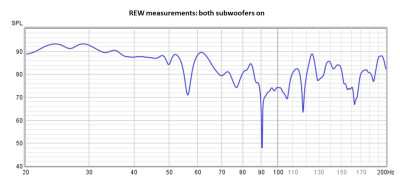

I have two minimum-size (15"x18"x72" with 12” RSS315HF-4 driver) THTLPs in my listening room. They are upright with the mouths firing towards the ceiling.
I have the THTLPs connected to my stereo and use them for listening to music. I typically listen at levels of 75 to 85 dB.
I know that they are working:

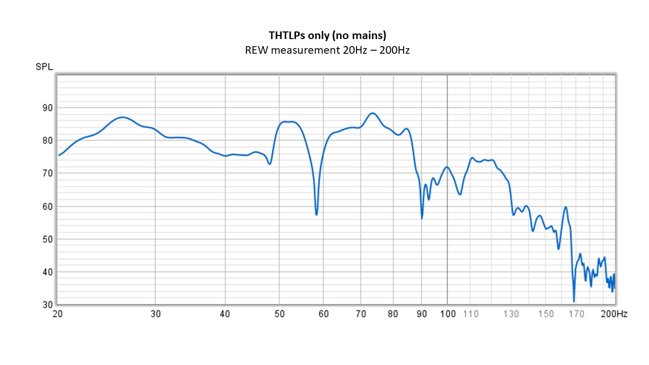

  • With REW, I can see how they perform in my room (see attached graph).
  • If I turn them off, the music seems hollow.
But I can’t hear them making any sound. Even when I put my ear right against the THTLP (near where the driver is located) I can’t discern them making any sound.
Is that how they should be performing? Do they only become more pronounced at higher volumes? Or might I have a problem that needs investigating?

Do it again with two different mic positions. That should give two different results. If not something is amiss. The peaks and valleys are caused by boundary reflections. They should shift with the mic placement.

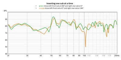

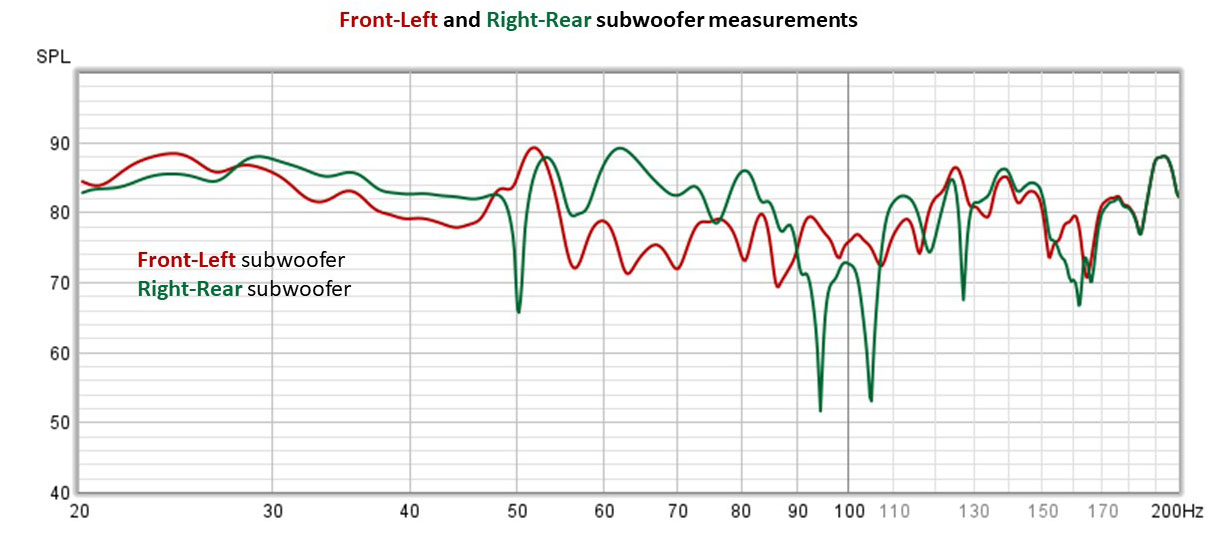

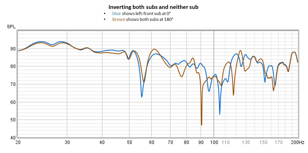

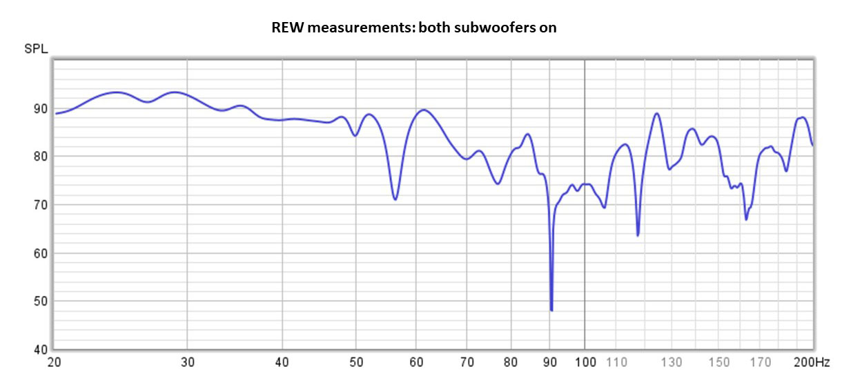

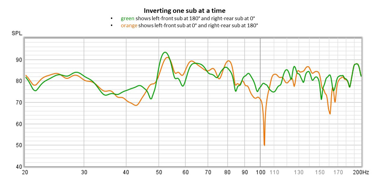

Thanks for the suggestions. In pursuing them, I've taken some measurements with REW and created charts showing the results.
This shows how my two subwoofers perform together, orchestrated by a MiniDSP 2x4HD:
This shows how each subwoofer measures individually when the other subwoofer is muted:
This shows the affect that changing the phase has on each individual subwoofer:
To take these measurements, I set 1 subwoofer at 0 degrees phase and set the other to 180, then switched them vice versa.
This shows the affect that setting the phase to 0 or 180 on both speakers has:

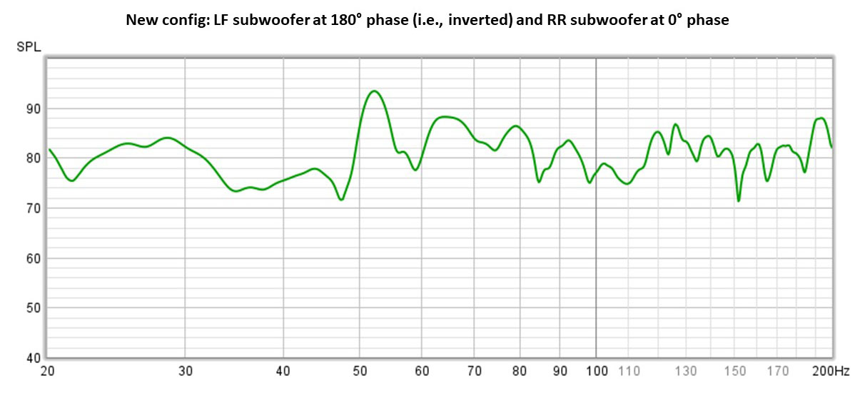

Based on that data, I have changed my subwoofer configuration so that the LF sub is inverted (i.e., phase at 180 degrees) and the RR subwoofer is as 0 degrees.
So .. I know that the subwoofers are working and --- thanks to your suggestion --- I've improved my configuration. Thank-you.
