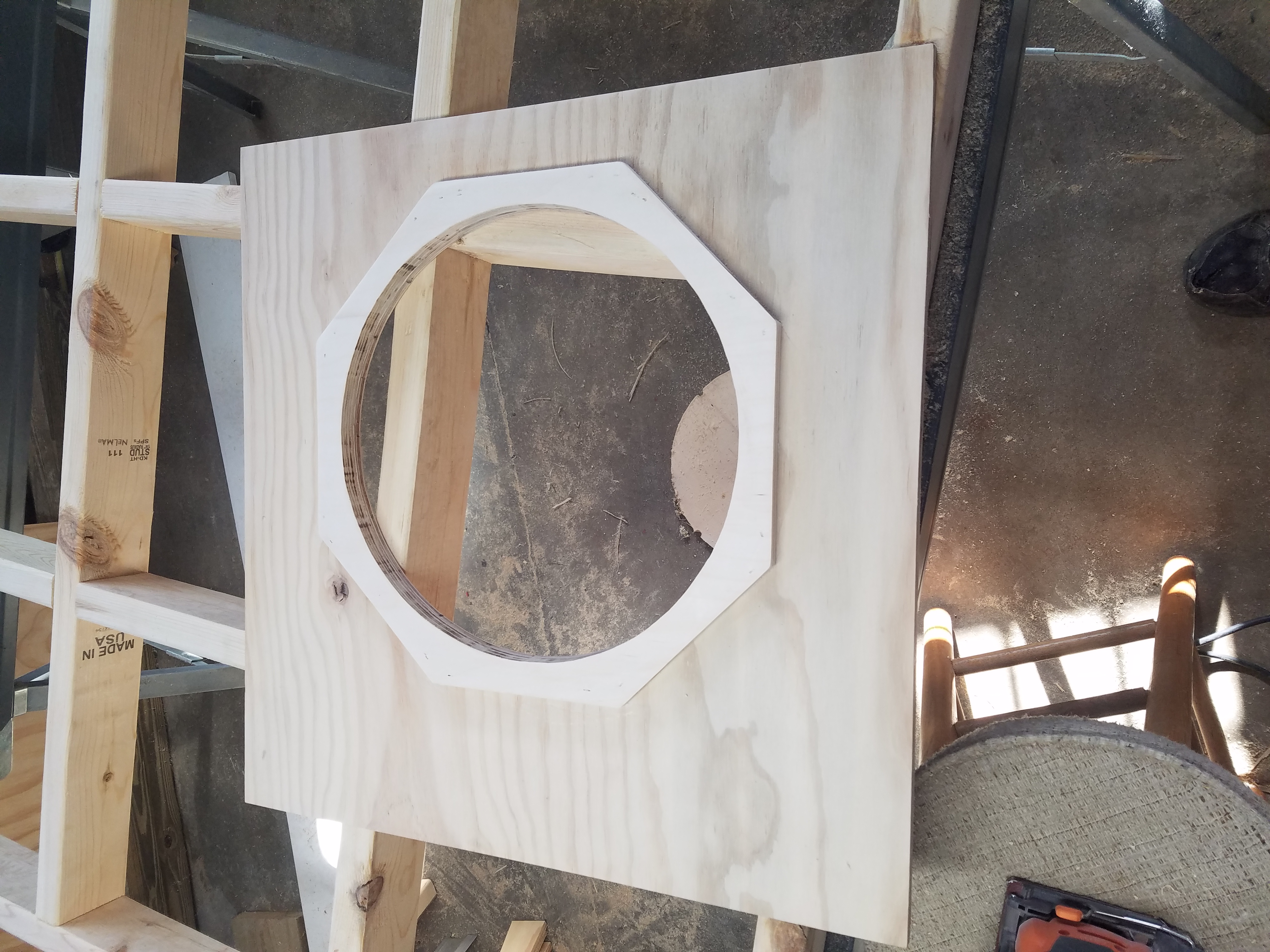

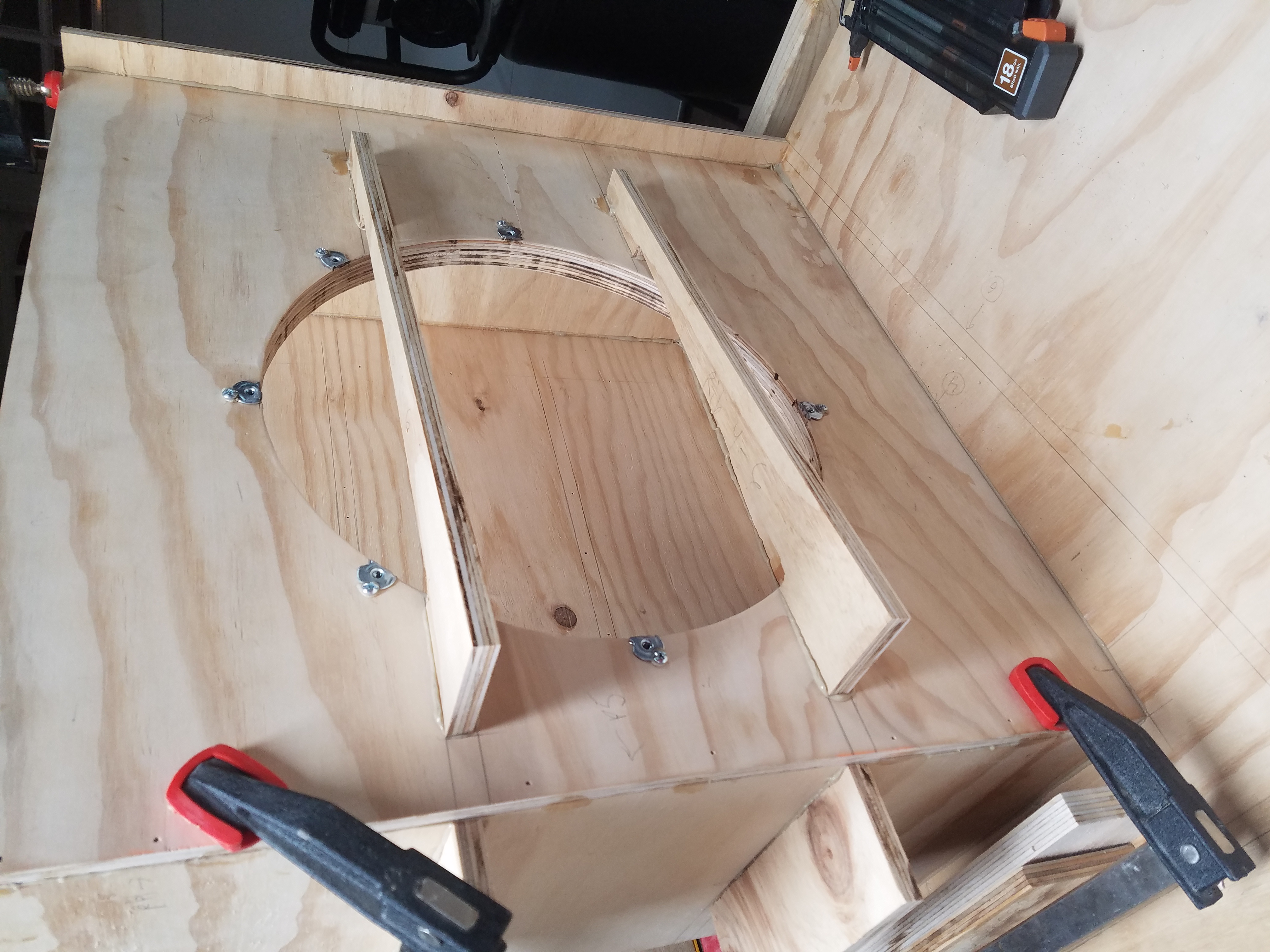

Got my woofer spacer glued to panel 4, which already had a hole to size for the driver. Drilled a 1/2" hole so my flush cut trim bit would fit, then I routed the spacer flush to the original hole. Turned out pretty good.
Panel 4 routed out
Panel 4 routed out
We centered the driver with some center lines and lined up 4 mount holes on those. Then I tapped a 1/4-20 bolt to mark the locations through the woofer frame. Then we put the driver safely way and drilled out the holes for T-nuts. After pounding them in, we secured them with a bit of PL and a screw on each for safety/backup.
T-nuts installed
T-nuts installed
Lastly I ground each flange down a bit and sanded it smooth so it doesn't stick into the bore.

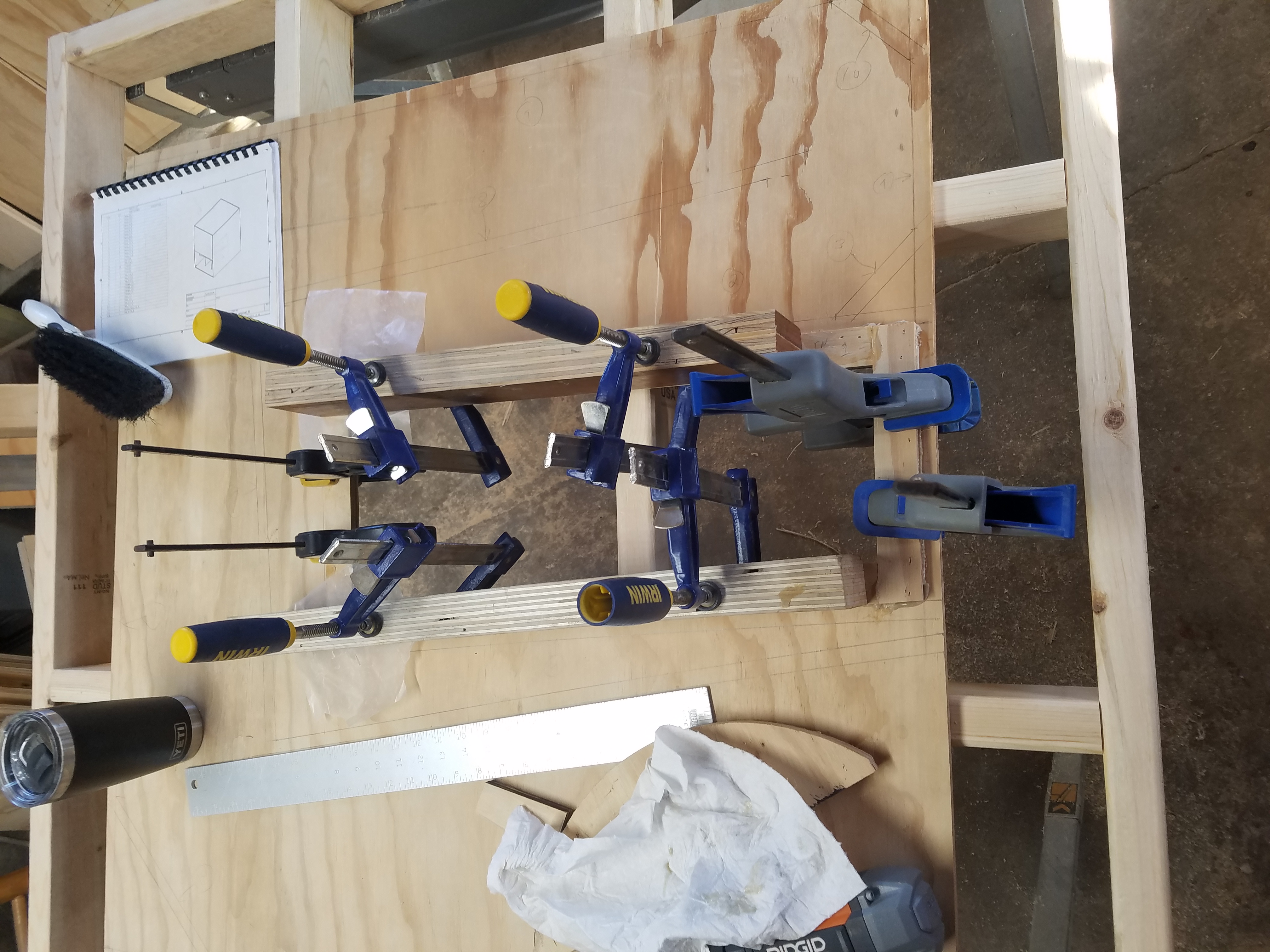

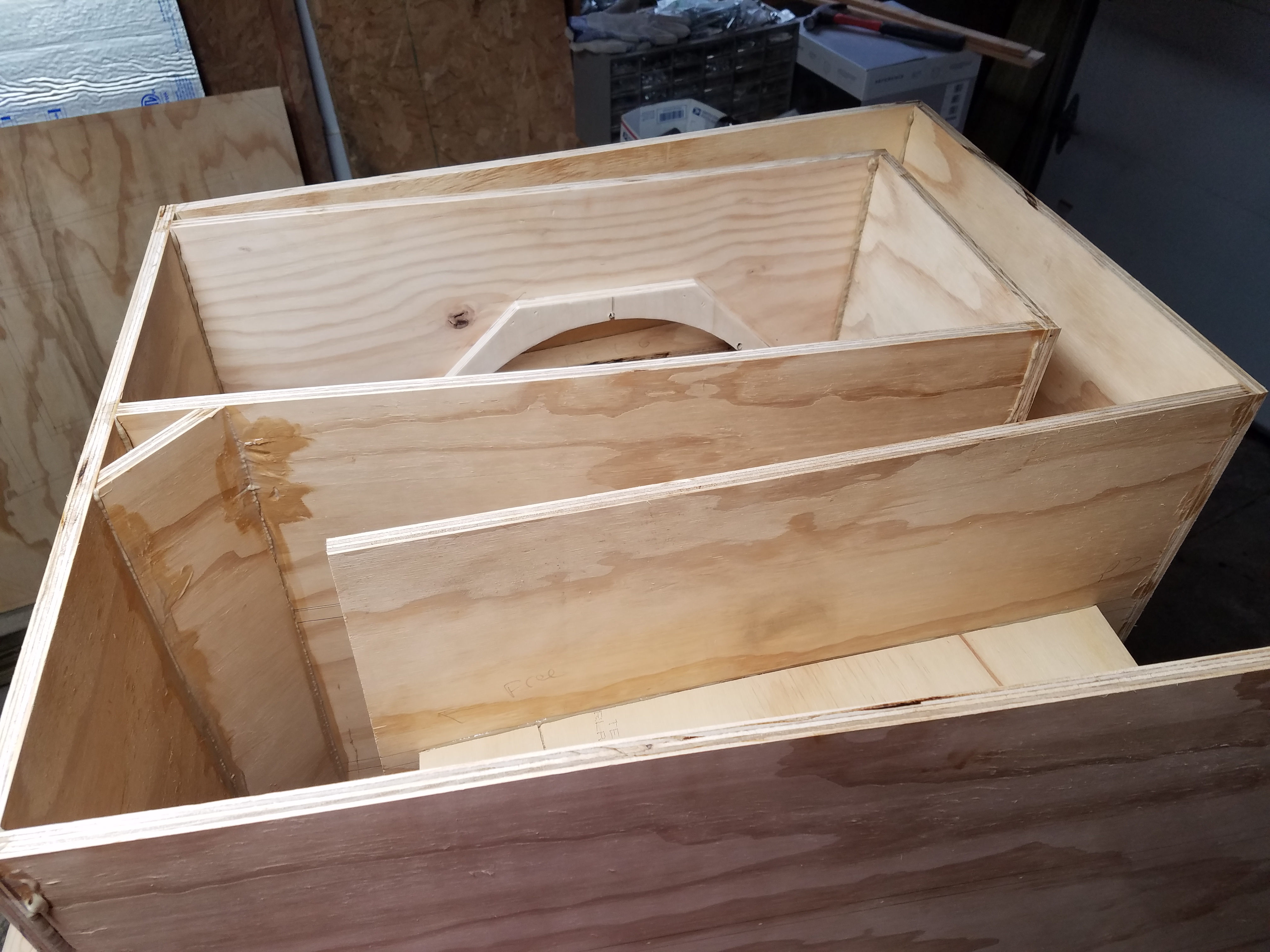

Since I laid out all the lines ahead of time, and rough cut all the panels, I wanted to try something. I built my access cover flange, starting by panel one, all pushed tight to the front/mouth side. Then I worked my way around and cut each flange piece and nicked shavings off until they lined up perfect. With a test fit of panels 2, 4 and 5, I glued the flanges down first.
access cover flanges clamped
I only had to trim a smidge off panel 5 as I fudged lines for panel 4 and drew two. I tried to center, coz my measurement/layout mark was in one spot and I drew two lines, one to either side or the initial scribe. No matter, it's mabe a 1/16th shorter at worst. I'll fudge the interior panels that far off all day with this dang PL oozing around.
resulting cleat for first 4 panels

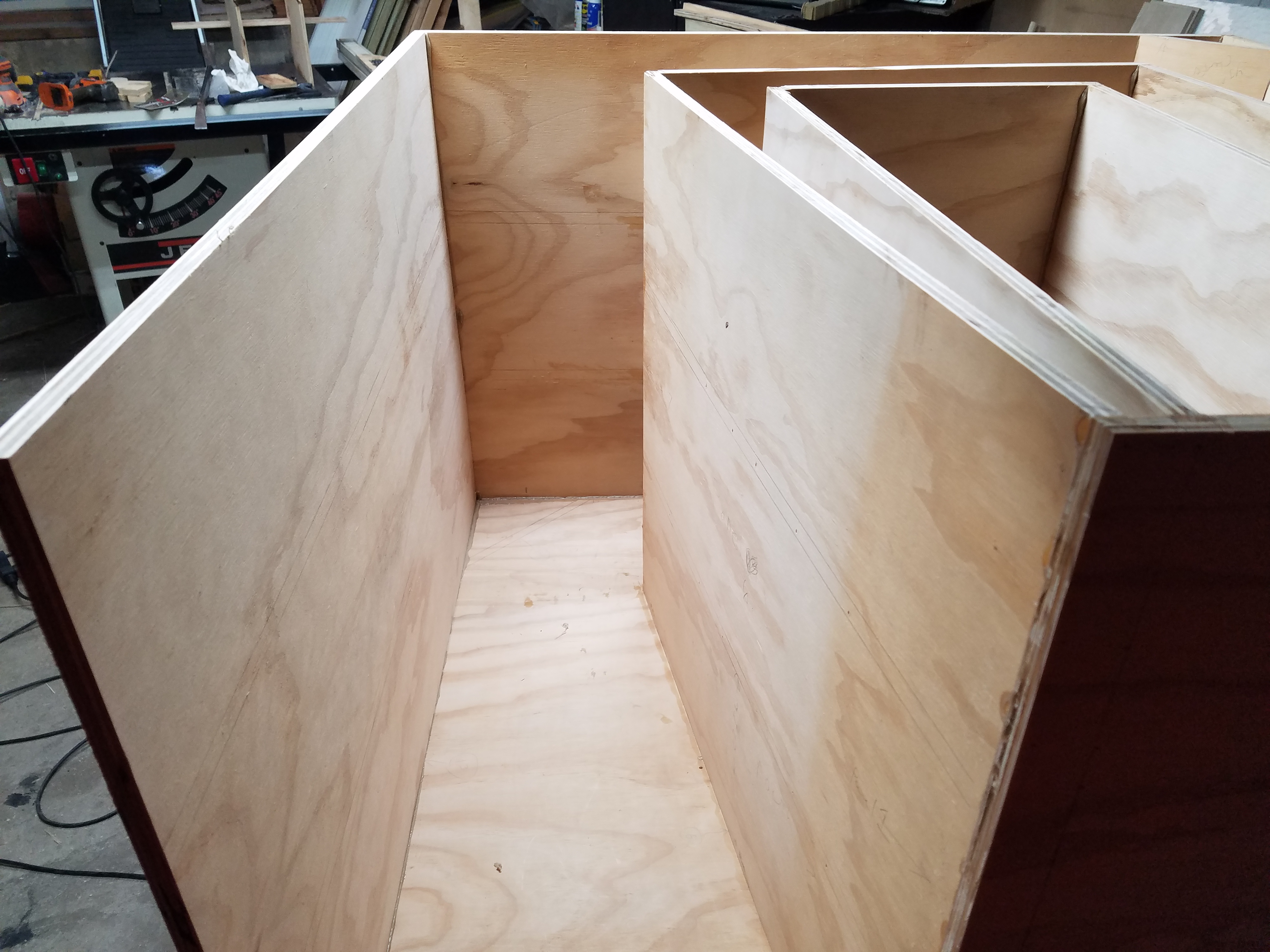

Using the flanges as cleats worked fairly well. I still test fit each panel dry, trimming 5 like I may have mentioned in an earlier post. Panels 2 and 4 came out nice though. I notched my braces on panel 4, although in retrospect, I don't think I did on my first THT, since I had the doubled up 1/2 ply. Oh well, it wasn't too much work.

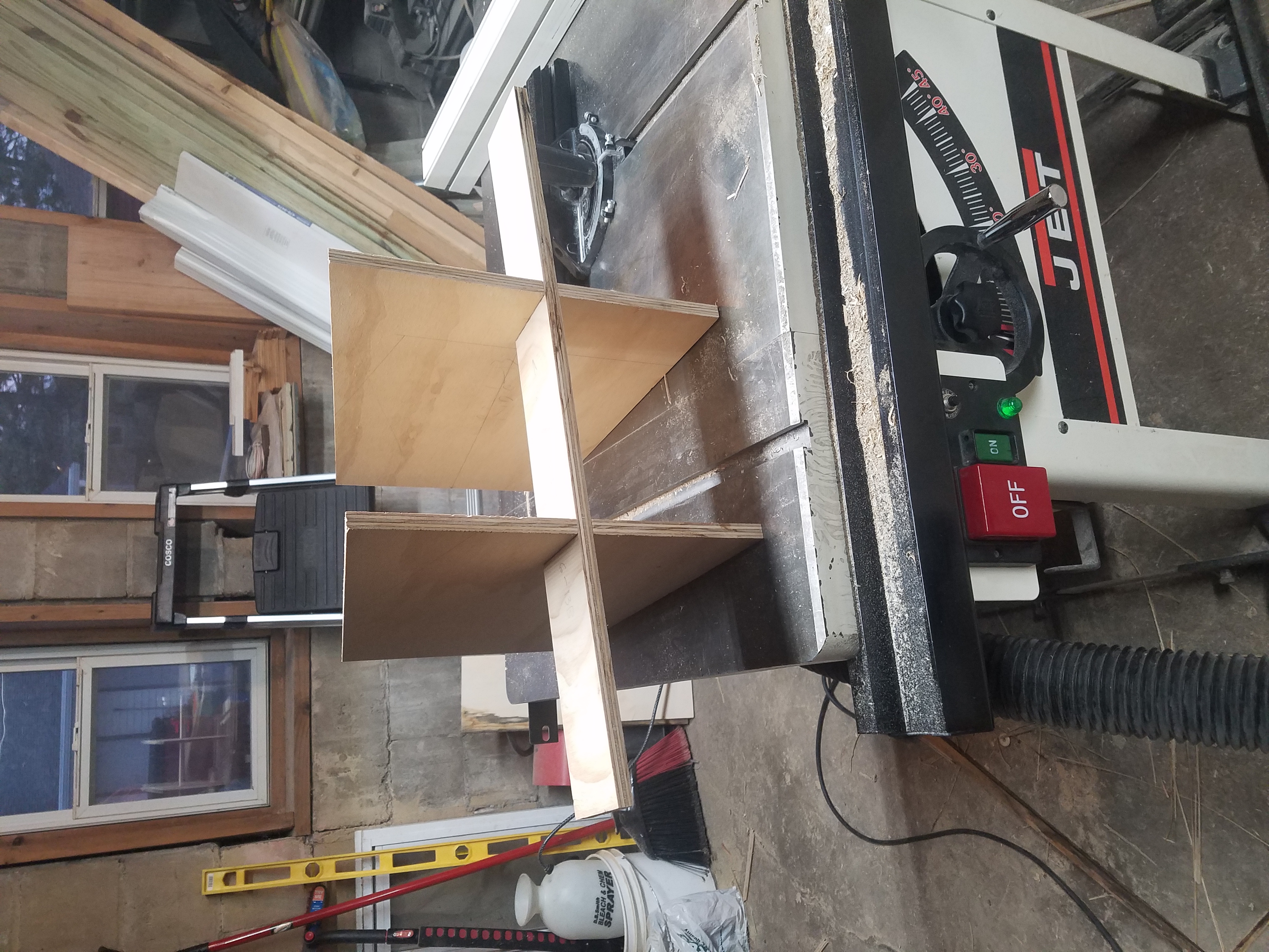

Hopefully these pictures come through right orientation! We glued panel 6 and 7, struggled a little with warpage but I think we have most pulled out.
Well how about that, turn your phone horizontal, one picture preview comes out right the other two upside down. I had my phone in the same orientation for both.

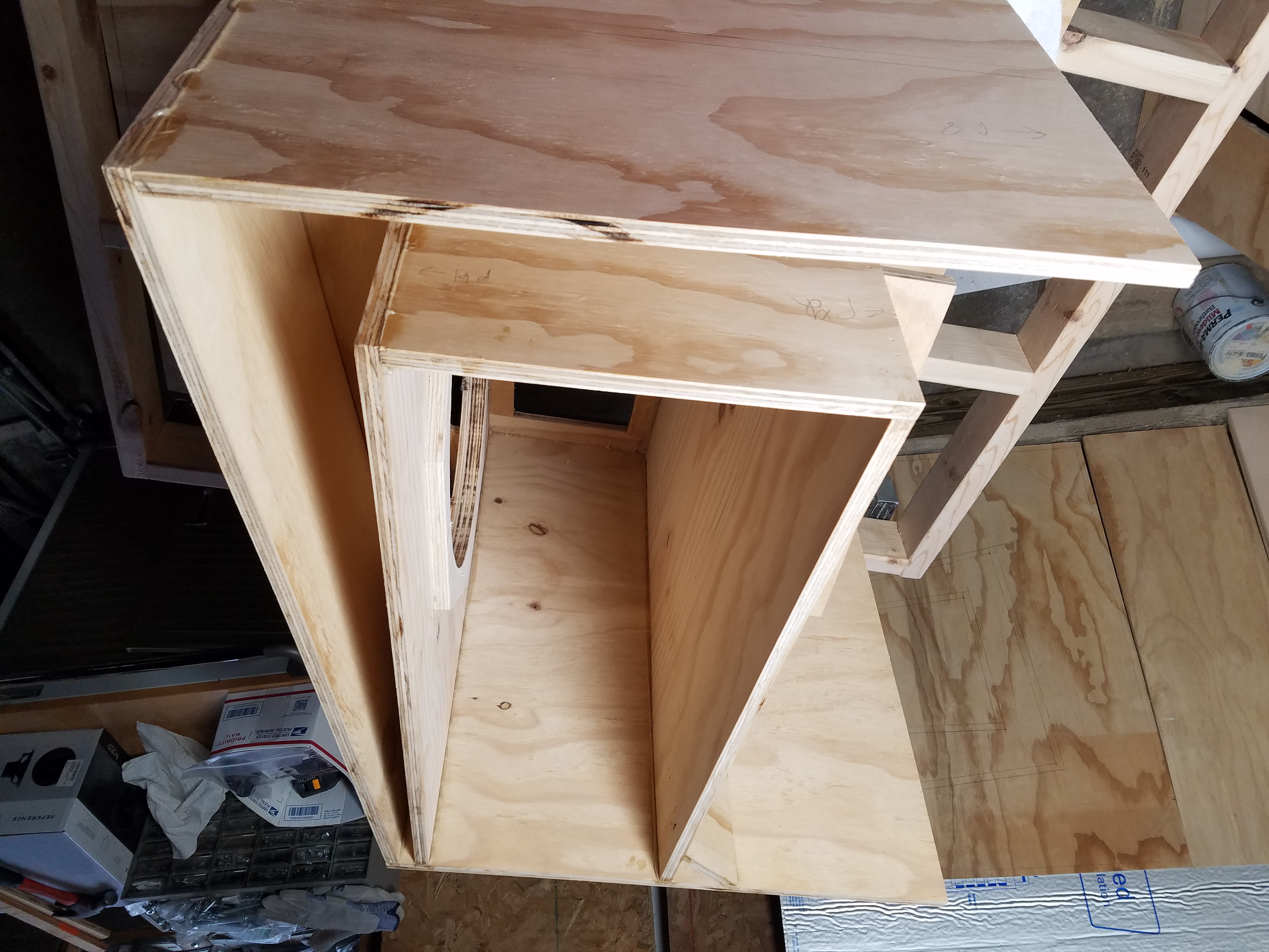

Panels 8, 9 and braces went in pretty easy. I like it once i'm up to a reference edge again. I hate the insides that squish around and I can't bring myself to nail a cleat in LOL.

Last two panels going on, then braces and we slapped second side on right away and clamped. The platform worked much better. Building a second was way easier, since I had some sense of what I was doing. Labelling all the panels better, and stacking them in order of use helped greatly. Last time I cut all the panels a it oversize and then to 23.5 wide all in one pass so they all matched. Then I'd measure the layout on the side and cut as needed. Taking an angle finder i'd bevel as needed to match, then cut to final length. This time I did all that up front. I laid out each panel, and mocked up a stop or cleat to go on to the next and get final sizes. I only had one panel a bit long, or my pencil lines were sloppy. Same with the braces, got them all close, remembering last time one was too close to an edge. This time they were all pre-cut to final size. I only had one spot in the mouth with a hairline gap I oozed with PL.
Having my brother or my son (or both) here to help hold/glue/nail made it all faster. I just took off clamps tonight and started scraping PL. I tried to scrape after about an hour on almost every panel, but with the second side, I just let it go. We'll be putting some false façade on this anyway, so more to come. Headed to the basement to set up the driver for break in. Then this weekend I hope to drill the access cover and paint the joint so the gasket tape sticks cleaner.
