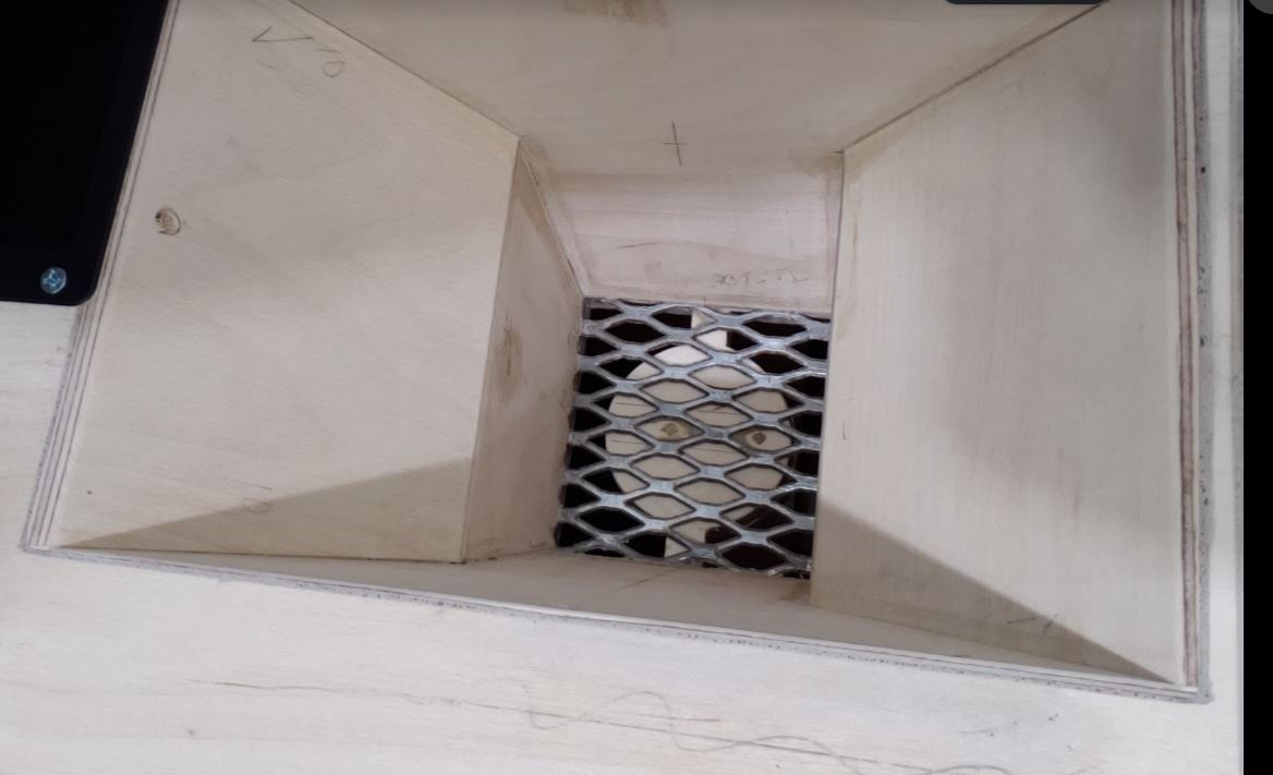

I'm not sure if I have the correct expanded metal or not but it is what I used in my Omni 12 TB.
If you want I can cut the piece and ship it too you if procuring the metal is a limitation.
This is the flat style no tread to speak of, it worked perfectly on my 6" mid horn.
I am a metal fabricator, I have two sheets of it in my rack...

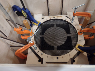

On my J10L, I used some heavier duty plastic screen that I 'borrowed' from the wife's sewing room. She uses it to make carry-bags for the swimming pool.
fender3x
Posts: 647
Location: miami
Re: Grill questions
#5 Post by fender3x »
9830Lark wrote: Wed Sep 14, 2022 6:47 am On my J10L, I used some heavier duty plastic screen that I 'borrowed' from the wife's sewing room. She uses it to make carry-bags for the swimming pool.
That looks very much like the pet screen that I have. How is it working? It looks like you did not put it under the spacer...how is it attached? It certainly looks good!

#6 Post by 9830Lark »
fender3x wrote: Wed Sep 14, 2022 8:27 am
It's fine. It rarely leaves the house, so it's not like it's been in a knife fight. I just embedded it in PL before I mounted the spacers on top.
fender3x
Posts: 647
Location: miami
Re: Grill questions
#7 Post by fender3x »
I see now! Once I blew it up it was clear that what I was confusing for cut lines was actually squeeze out from the PL Thanks!
