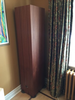

I have two minimal-size (i.e., 15"x18"x72") THTLPs in my listening room. One is in the LF corner and the other is in the RR corner. They stand vertically and fire up towards the ceiling.
Is having them fire upwards a good (or poor) orientation, or does it matter much?- Bill Fitzmaurice
- Posts: 28966
Re: Should I reorient my THTLPs?
It doesn't matter.
