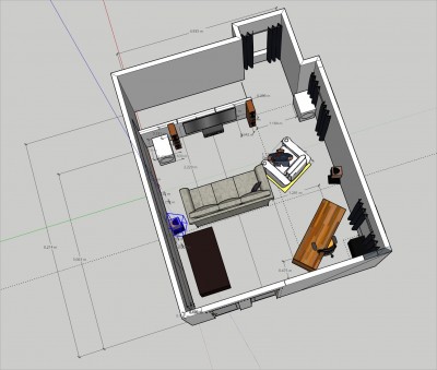

Here is how my room is laid out currently. Eventually, I would like to add two overhead Atmos speakers.
For room treatment, I plan to build a broadband acoustic panel wall about 3 feet tall, on top of that half wall behind the TV to help some sound from escaping downstairs, and just to give a backdrop to the TV. I am also building bass traps all around the room. I plan to go a little crazy with them as I can't paint the walls and I have some creative ideas on how to build them to add some personality to the room. To keep the room from getting too dead I will probably use an FRK backing, on the front of the panels. I will probably end up with 15ish 2x4'x4" panels gapped 4" from the wall.
I was thinking the rear bookshelf speakers could work as overhead atmos speakers embedded in cloud panels, and the current LR could move to SR and SL duties while being replaced with DR200s or 250s but would really appreciate any advice you guys have as I'm fatiguing of buying things that arent working out.

Room question, what’s up with the space behind the tv and speakers?

#8 Post by ACUA »
Stairs!

J_Dunavin wrote: Wed Jul 20, 2022 8:45 pm Room question, what’s up with the space behind the tv and speakers?
Stairs back there that I wasn't sure how to draw.
