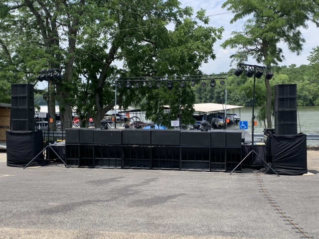

I remembered to snap a hasty picture of one of my two BFM rigs in action this past weekend. 4 x OT12 per side and 6 T48 center cluster. Here I’m using a pair of 36” and 4 18”. You can also see a pair of WH8 on stage.
I can’t say enough about how good this rig sounds. I’d like to have a little more height on the tops, but I walked back a full city block and the sound was still excellent.
I’ve been gigging a BFM system for several years now and continue to get compliments (and more work) because of the quality.

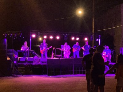

“Rock The Dock” last night. 4 x 36” + 4 x 18” T48s and 4 x OT12 per side. Sounded pretty good…
Re: OT12’s and T48’s
Man I bet that group of T48s sound great!

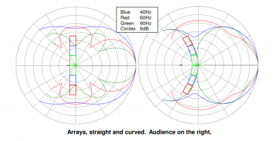

Or maybe try a curved array? The image below illustrates what you may have been experiencing along with the calculated results of a curved array. Looks like it could possibly smooth out your coverage considerably.
Image above is from the following link, a good read on subwoofer arrays.
Electro-Voice Subwoofer Arrays A practical Guide
