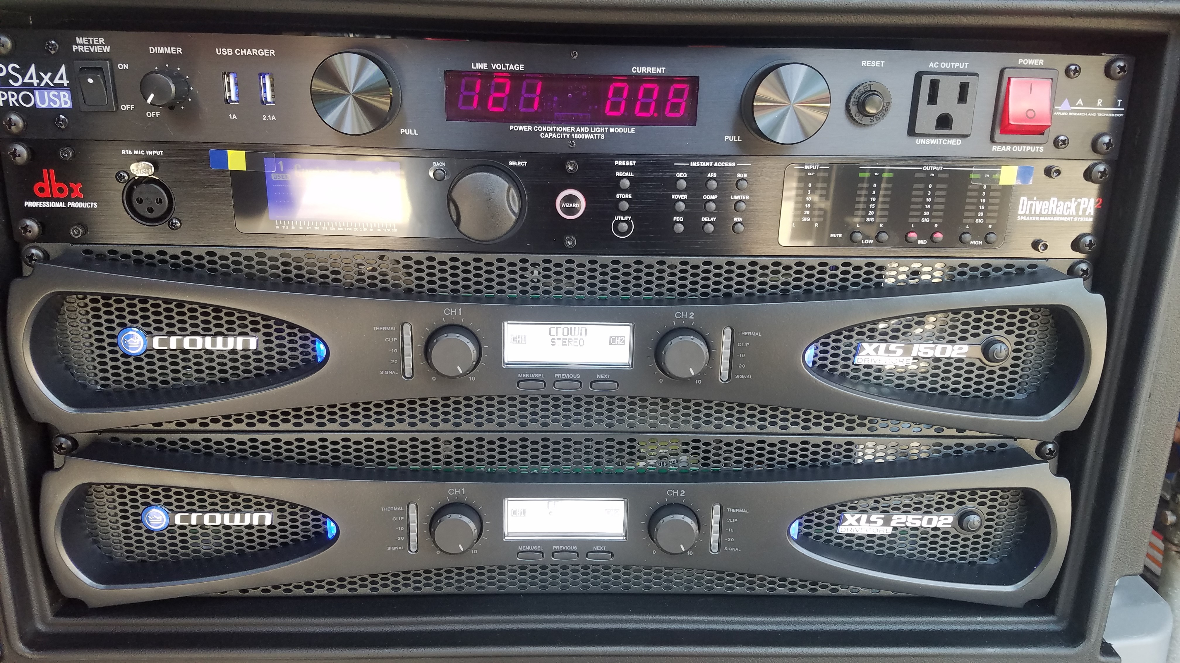

Have some updates. We were gone camping all weekend, but came home early enough Sunday. My son and I schlepped all the gear into the driveway and hooked everything up. Bought a floor model SKB 6u rack with wheels and mounted the amps and Driverack. Picked up an ART power strip, and I'm trying to make a mount in the back of the rack for a small Asus router for tablet control of the DBX.
BFM rack
BFM rack
I did not check voltage direct from my laptop, but I can attest, sound level-wise, it plays nearly as loud as my external soundcard. So I have to thank the group for pointing out it was my measurement technique more than anything. Sine waves for the win! We set it up with the Focusrite Scarlett Solo and at perhaps 1/4 to 1/3 volume it's LOUD. Anything over half volume is painful within 10 feet of them. I did not put the RTA-M on, since neighbor was mowing, and I'm close to cars and the garage/house. I'll try to get this all out to my friends 40acres in the coming weeks for some graphing.

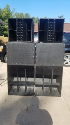

BFM stack
BFM stack
I have clean strong bass sitting in the middle of my driveway pointed towards our yard. The tops are crystal clear. For sure the 150w drivers and my ~34v voltage limit there holds back the Titans. The Titans never get close to limit. I may turn them up a bit balance-wise and see what happens. I did play with the subharmonic synthesizer a bit with some AC-CD and Kim Mitchell just to see what it would do. I like it, but I'm not sure where to set things. Maybe that's a 'by ear' setting?

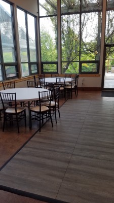

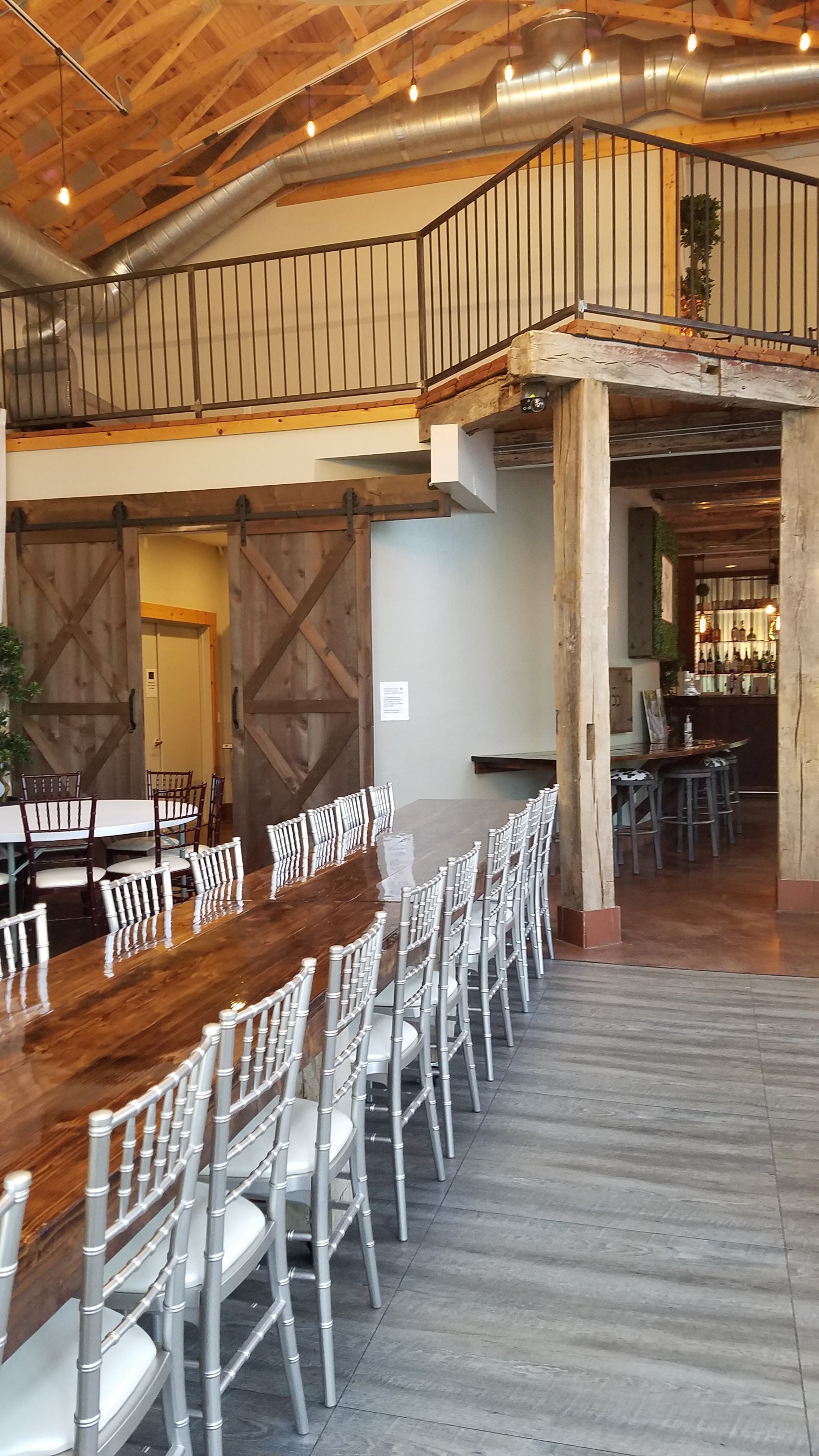

So we toured the wedding venue last night. I've attached two pictures. They normally ask DJ to set up on balcony on second floor. Seems odd to me, but i'm new to this game. I'll grant them this is a small place, we have 100 people or less in our party. I was thinking Titans firing into corner up on balcony and DR's on tripods in middle of rail/balcony/outcropping. Would I have issues if I put the tops on the first floor in a corner somewhere and left the subs upstairs? Would I put delay in them to account for the 13ft to second story floor, or even more delay to account for Titan horn length? If I run a sweep with RTA-M will it do that automatically? My other thought is to find a way to set up all gear on 1st floor somewhere after dinner tables are cleared out. The picture of 1st floor is one half of main room/area. The door on right side of picture is middle of room/with another mirror image door and room to right. Only difference is right wall is all barnboard, instead of all glass. The second picture is from the corner in the 1st picture, looking diagonal. The area under the balcony on right is all open to another small area and the bar. There is another corner on the balcony, pretty much mirror image of the picture. Open doorway in middle to a second floor seating/dining area. So I have room out on the "point" of the balcony, or I could set up on either side, or both sides. Love these Titans, but I gotta make some T24's or something for this kinda stuff LOL.

Off the cuff, I'd say having the DR's up high is okay if you are able to tilt them down enough, but I'd try my best to get the Titans wall or corner loaded on the lower level.
It's difficult to get a good idea of the layout there with just the two photos. Are there more pics of the venu you can post?
Posts: 8615
Re: Laptop to Driverack PA2 setup help (levels)
#39 Post by Bruce Weldy »
I'd just keep it all upstairs. If all of the party is downstairs, then put the tops on the floor with a 2x4 under the back to shoot 'em downward. No need in using poles - just puts 'em farther away from the 1st floor ears.
