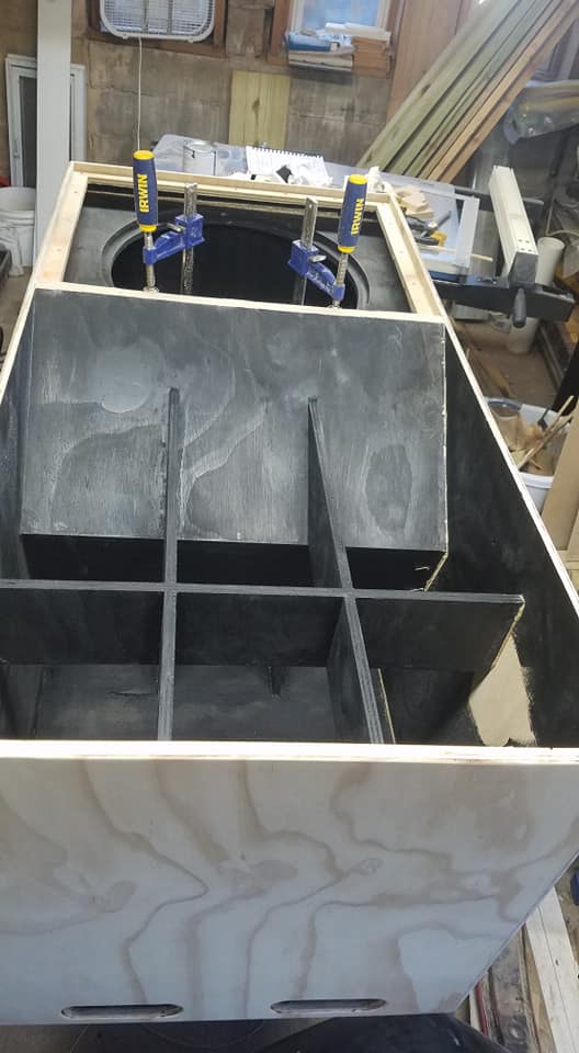

Side profile with all panels and corner reflectors/braces in, mouth braces in before side 2 goes on.
side profile of the business

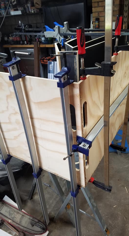

Side two goes on, it is not warped now, but yes, i clamped her tight at first!
I also added some spacers to stiffen the front. I think I need these in cab 1.
I had to place and move them several times to make sure I could actually slide the driver in, since the opening is smaller that the frame outside diameter!
side warp or optical delusion?
spacers/braces in first bend clamped in
better view of spacers

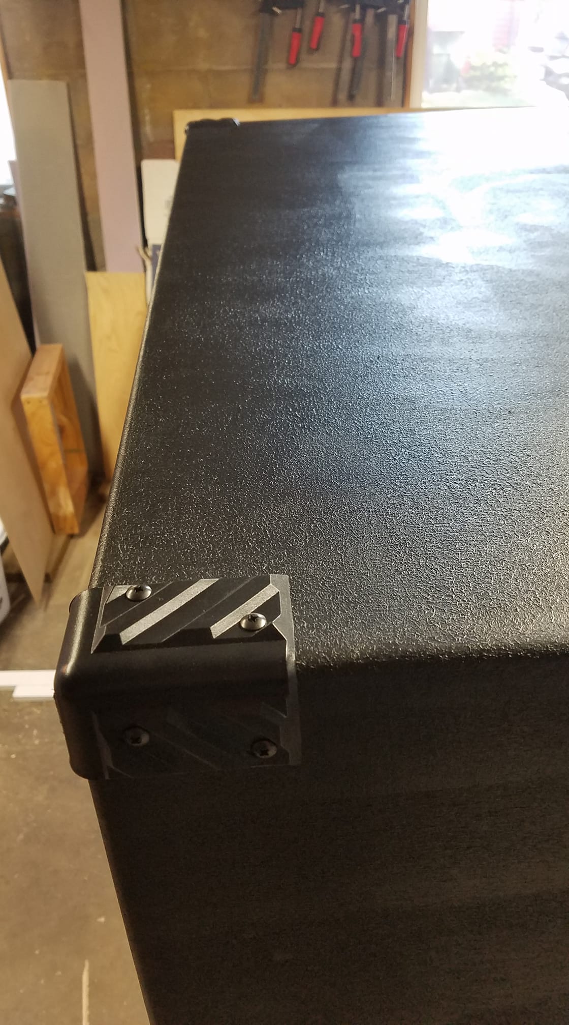

Woofer test fit, some Duratex and corner protectors. Also a shot of my new solder station, that helped me greatly. my 40 year old soldering gun was tired...
test fit and ready for paint and Duratex
corner protectors and duratex
driver mounted for leak test
The pair!
The pair!
