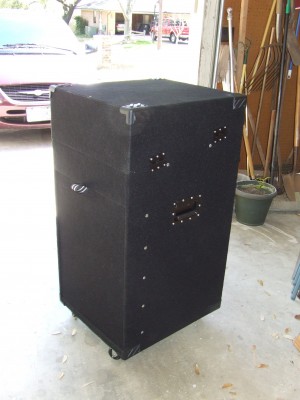

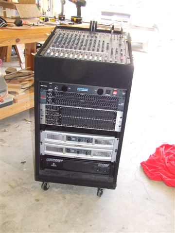

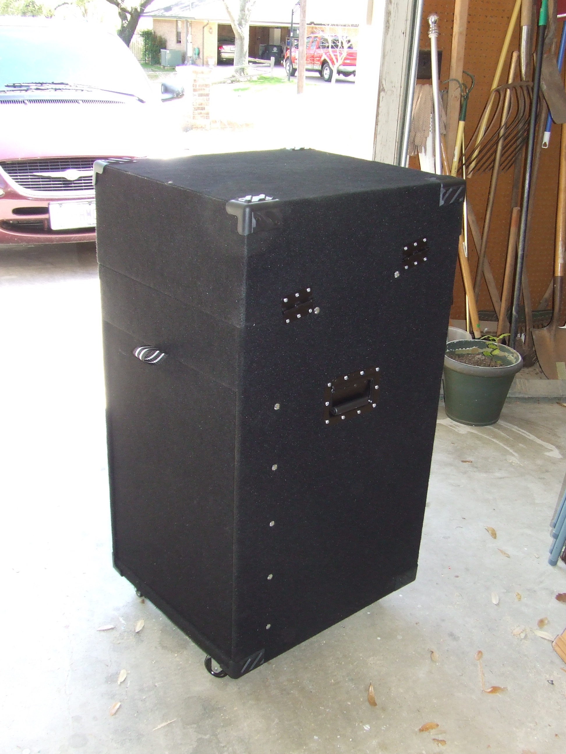

First thing I built for my system was my amp rack. I used rat fur. That rack has done every show and looks pretty decent after all it's been through. Pics from 2010. Was using a Yamaha analog board - which is still in that rack in case of emergencies...
The good thing about using rat fur is that you can make the covers compression fit. Those three covers have been on and off hundreds of times and are still nice and tight.
As far as mixer cases, definitely build your own. Every store bought mixer case I've ever tried to use on other people's rigs absolutely suck. Handles aren't in the right position and are a total PITA.
